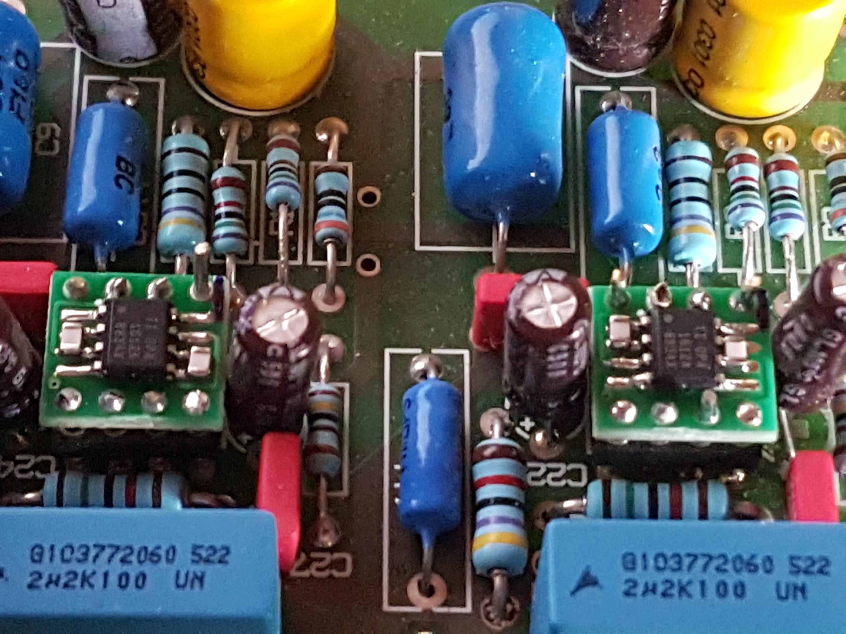

hey mcs,
love the design layout, beautifull, could you tell me what type of cap you used (the blue types that look like mustard caps) thanks
evengravy said:love the design layout, beautifull, could you tell me what type of cap you used (the blue types that look like mustard caps)
Thanks! The blue caps are Philips/BC polypropylene film/foil caps. They are available in all E-24 values, so they are often used for RIAA filters 🙂

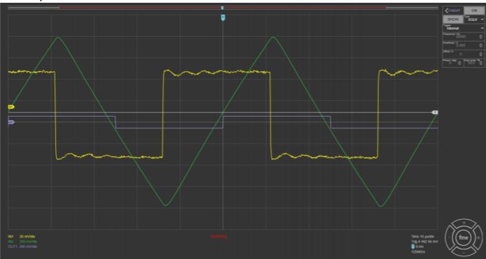

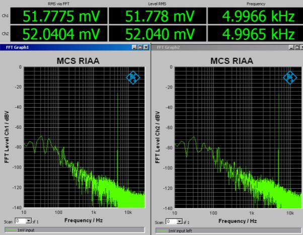

Ref post #22, MCS RIAA-kit:
With professional help from a reputated audio engineer, the MCA-kit is adjusted and stabilized for today's opamp OPA 1611.
The onboard AC/DC and regulators was noisy and replaced by an outboard power supply and Jung regulator.
The deviations on the right and left channels from the standard RIAA curve are -0.3dB at 20Hz, + 0.2dB at 200Hz, otherwise almost within 0.1dB.
The deviations between the channels are only 0.04dB and must say to be very good. The square pulse beneath is 20 khz. Before you ask: I can't answer...

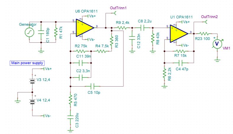

Hey folks...
I am building a phono preamp for my daughter & son-in-law. They are not going to be too discriminating, but I might as well put some effort into it.
I bought a PCB from someone on e-Bay, based on the NSC AN-346 2-stage RIAA preamp circuit. This uses 39 nF and 33 nF in the time constant circuits and a 2 uF coupling capacitor.
I forgot how hard it is to find capacitors that meet desired capacitance, dielectric, construction, lead pitch, and tolerance.
I ordered 60 each MKP-type 5% tolerance inexpensively (double-metallized, just because I found those values with desired lead pitch for PCB). I have access to a calibrated metrology lab standard RLC 'meter' with several digit display and will number them all and bin them by value to match values (hoping they aren't all hovering close to the 5% extreme - found that phenomenon once trying to select Zener diodes for a low-end-of-tolerance value, and they all were extremely close to each other with not enough variation to chose values close enough to what the situation needed).
So I began contemplating how sensitive the RIAA time constants might be to tolerance, thought I understood what I was doing...
...until I read a paper today on evolution of the RIAA EQ. from 2 to 3 to 4 time constants. It analyzed the sensitivity of each time constant with regard to interaction among the 4 time constants. It concluded that the 4th time constant had the worst sensitivity to components, most people advise avoiding implementation of the 4th time constant, and that the ratio of the capacitors for the two 'conventional' time constants is very important.
Back to the NSC App. Note. It derives equations and allows choice of the capacitors. No discussion of capacitor ratio. Different circuit, I suppose.
I'm a little disturbed I read the paper with the critical ratio capacitors, as the AN-346 one is only a little bit of work to recalculate component values based on one's choices.
I am glad to see an included schematic posted here with '1611 op amps that, while it differs from AN-346, I recognize some similarity and it DOES use the same 39 and 33 nF values I decided to find.
The only disappointing thing about the AN-346 2-stage is the 200 uF BP electrolytic, but a film cap in that value, while available now, is impractically huge.
I know where my NE5534A's are but don't remember where (too much stuff in boxes) my modern op amps are, so I'll use what I have accessible.
Any opinions on the two different philosophies (or context I missed) of critical ratio of two capacitors vs. chose desired values? (I almost decided to recalculate for equal value capacitors since I have a lot of certain values in polystyrene).

I found some ancient NOS Sprague 96P Vitamin Q 0.039 and 0.033 uF but cannot bring myself to use those with op amps...for various reasons, mainly the common opinion they need 50-100 hours of use to sound 'good'. To build a preamp for someone who doesn't understand this seems a really bad idea...MKP type will hit the ground running and if they change with burn-in, it will be subtle.
For C1 suggest
594-222241643903
MKP416 0.039 uF 2 %
You could use it for C3 as well but if you do R3 has to change
594-222241643903
MKP416 0.039 uF 2 %

If you're going opamp, go with this schematic:
http://www.hagtech.com/pdf/bugle3.pdf
I can confirm it works well. Once you have 1 opamp, you might as well continue using them. LM4562 = LME49720: Same exact chip, one might be more available than the other.
