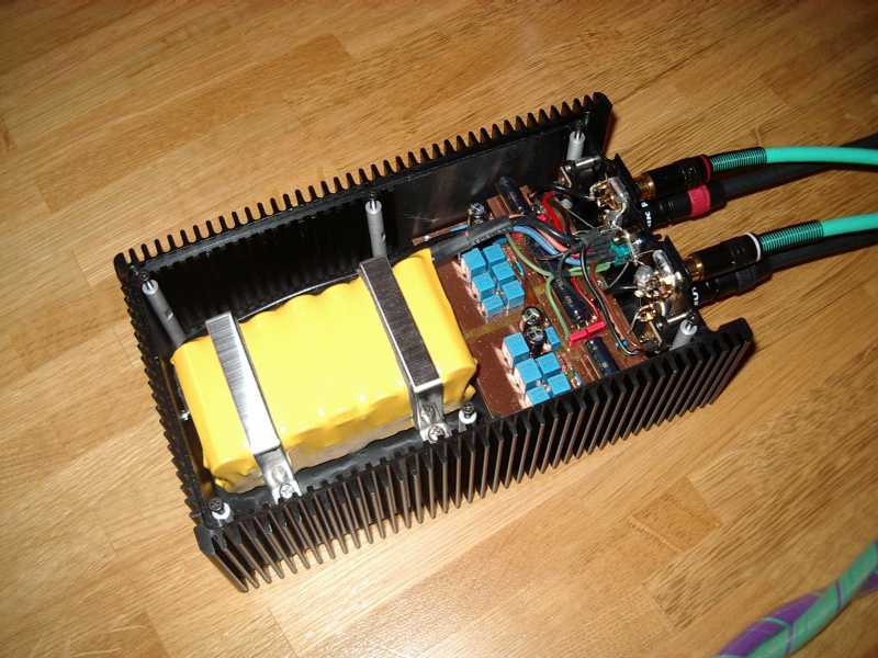

I built two of these about 1 year ago, one for MC and one for MM. The MC version has 40dB gain per buffer stage, battery powered. Don't claim they are best ever, but sound nice for the complexity and effort. Beats most commercial ones at the US$200 price tag.
http://www.geocities.com/rjm003.geo/rjmaudio/pho_a6.html
Opamps I used are AD797 for front, OPA637 for the rear, both biased in class A with a 2mA constant current diode between output and -ve rail. RIAA capacitors are MKP1837 1%, values recalculated from the Lipwitz paper.
Also built the version 3 of the Rod Elliot "Phono Preamp for All', which came originally from S. Bateman. Have more gain than the one above and actually sounded better for some cartridges. But I like the Buffer-Filter-Buffer configuration, rathar than RIAA on the feedback loop.
The next I am going to build would be JFET Class A, balanced output, no feedback, also buffer-filter-buffer. But many other projects planned before than (including turntable).

Don't waste time (and money). Just get yourself 4x 8.4V 250mAH NiMH's and done. Sufficient for 10 hours for most opamp circuits.
I have tried them all -- remote Cap Multipliers, LM317's, Jung Super Reg, Current sourced shunt regulator, .....
You saw what I am using after all that.
Patrick
