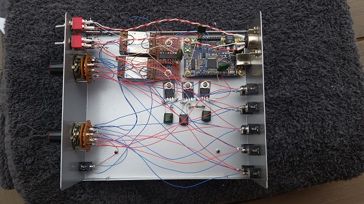

OK I finished wiring up the pre-amp. See picture below. As well as wiring up the selector switches, I have put in a few filter caps as suggested by Emilio. There are caps on the regulators, and I have also put caps right on the input pin of the JLSounds board. I only wish I had bought a wider enclosure - it got a bit tight soldering the switch that is next to the no-DAC components/wiring.
I'm now listening to the no-DAC using Ubuntu OS, HQPlayer 3.12 upsampling to DSD256. Observations so far.
1. There is NO noise. Or no noise that I can hear from my couch. The prototype no-DAC, that was sitting out in free air, suffered from various hf noise and whooshing type sounds. I think that it was picking up lots of interference. Now I have enclosed it completely in a box, and put bypass caps on all the power inputs - no noise 🙂.
2. Only pops I get are when I change sampling fequency (I upsample to 11.3 MHz for 44.1kHz family including SACD, I upsample to 12.3 MHz for 48kHz family). Even then the pop is innocuous. There are NO pops when tracks start and stop, or when I hit the next track button or stop button 🙂.
NOTE - I haven't tested with Windows10 just yet, but last time I used windows there were lots of pops as described by Ray. But Ubuntu seems fine - note that I am using Jussi's kernel 3.33.0.55 (available via the signalyst.com website). Ubuntu still doesn't support native DSD (only DSD as DOP) but Jussi's modified kernel will support native DSD up to DSD256.
3. As requested by Emilio, I have measured the output of my no-DAC. I created a 440Hz, 0dB test signal using Audacity as a 16 bit wav file. Upsampling to DSD256 via HQPlayer, I measured 1.55V at the output of the transformer.
4. And the sound is - absolutely lovely. PCM files, from 44.1k to 192k, and DSD files are handled with aplomb. I'm still a vinyl man at heart, but most vinyl these days is cut from hi res digital files. I reckon that those files will sound better if I buy them from HDTracks and play them via the no-DAC, rather than buying them encoded onto vinyl, and decoding with my Lenco. I will still listen to my older (analog) LPs on the Lenco, but for now I am pretty happy.
Regards, Hazard
