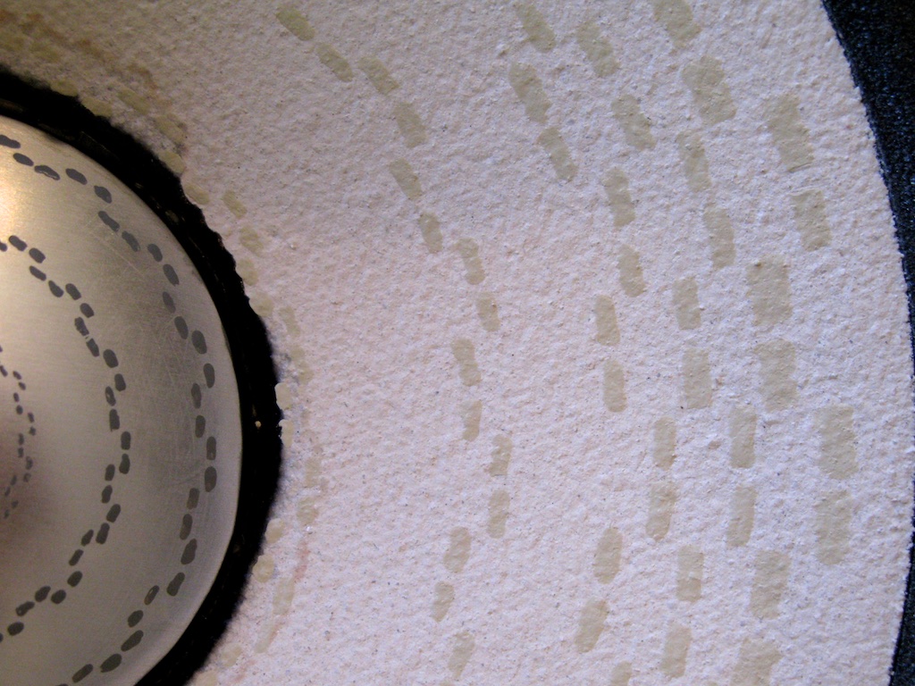

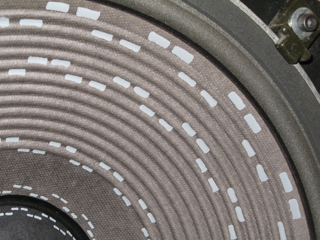

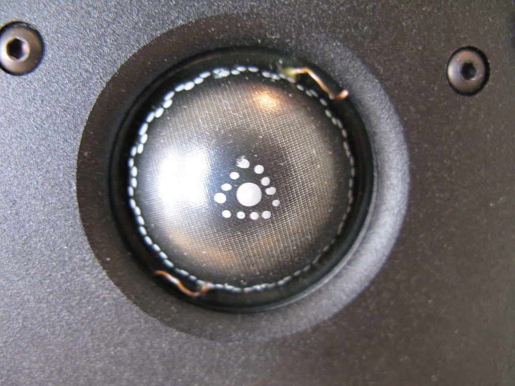

If the NAA would run under Botic, that would make it happen much sooner. But to tip my hand a little, I think that cone technology in loudspeakers is the most vulnerable area for 'non-analogue' interference. I have directly addressed 'micro-distortion' in my speaker surfaces, and found that the cone mods erased practically all the sonic advantage of up sampling within the PCM domain. The result of the cone mods were exactly as you guys are describing the sound of the 'no-dac'. So that is why I question whether I am a good candidate to enjoy a 'no-dac'. ...particularly with the PCM-based DSP crossover to which I am now committed.
