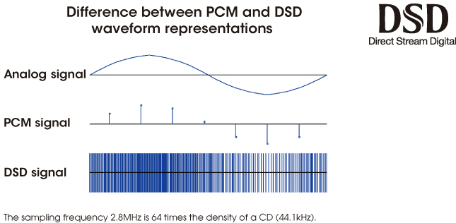

What does the DSD waveform look like? I've never looked at it. Class-D is usually a square wave with variable duty cycle.

The point is this - the digital output from the USB receiver is normally fed to a DAC. I am not feeding it to a DAC. I am trying something different, if it hasn't been tried before. As per Wikipedia (so it must be right!)
"The process of creating a DSD signal is conceptually similar to taking a one-bit delta-sigma analog-to-digital (A/D) converter and removing the decimator, which converts the 1-bit bitstream into multibit PCM. Instead, the 1-bit signal is recorded directly and in theory only requires a lowpass filter to reconstruct the original analog waveform. In reality it is a little more complex, and the analogy is incomplete in that 1-bit sigma-delta converters are these days rather unusual, one reason being that a one-bit signal cannot be dithered properly: most modern sigma-delta converters are multibit."
To re-iterate. I am not using a sigma-delta convertor. Or any other converter. I am feeding a digital signal (DSD, or PDM) into a band-width limited transformer (hence acting as a low pass filter) to reconstruct the original analog waveform. Any conversion (if you want to call it this) happens in the transformer. Same as Class D amp. PWM signal is fed to a low pass filter then to the speaker. Where is the DAC in a Class D amp?
Anyway let's not argue about semantics. Call it a DAC, or not a DAC. Whatever you like. But i am trying to minimise the signal path in my system. Because I feel like it. And I can (well if this works, I can). You point about about power supploies is valid, and I know I need a better p-s. WIll a better p-s improve the bass? That's an interesting point, I can hear noise at the moment that I need to deal with but I hadn't considered the impact of the p-s on bass response.
Also, I don't know what a transversal filter does. Do you have a link?
The D/A conversion occurs when you cease to interpret the signal as a digital one and begin to interpret it as an analog signal. So that happens at the output of your buffer because you're not feeding it into a digital circuit downstream, rather an analog one.

As I understand it, a DSD signal is a form of quantised pulse density modulation. Hence the 'digital' signal already contains the analogue signal, which is why a low pass filter is all you need. So the reason why you don't need a DAC is that the signal was never truly 'digital' at all, but merely used a clever way to record and play back an analogue signal which looks like a digital signal.
Note that 'analogue' does not mean 'music signal represented by voltage level' but 'music signal represented by something variable (but not a number - that would be digital)'. Here it is pulse density.

Actually, the DSD signal is discrete in the sense that it can assume only the value high or low, but it is not a numerical representation of a waveform, it is like a PWM signal and for this reason an RC filter can be enough.
