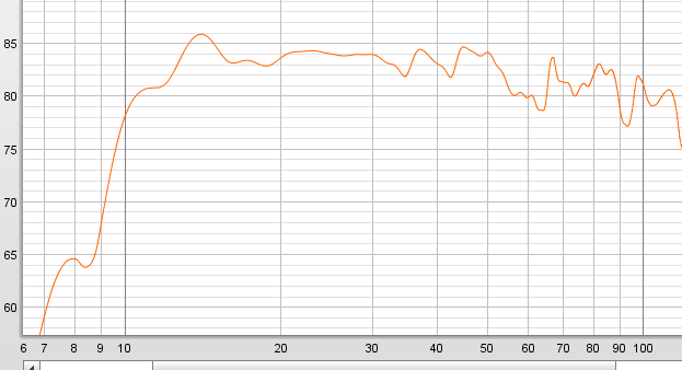

Very, very good!in the main listening position (with low-pass filter @ 150 Hz).
Its my own DBA with a whole lot of EQ on the rear array.
How it measures in other positions?
How it looks w\o LPF?
Is front BA EQed\corrected or not?

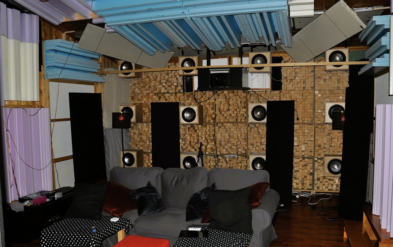

Awesome looking room!Thanks! It’s good to be back. I’ve been playing with DBA and Magnepan since the last time I was active here.
My current setup is a 5.1.4 system with five active Magnepan 3.7/3.6, four 1.6 as Atmos speakers, and the DBA. I’m using 24 Seas L26ROY woofers in small closed boxes. The room looks kinda crazy, but it’s usually covered up with curtains.
Front end including three Magnepans.
Rear.
Two of the Magnepans on the picture are no longer there. This is taken when I had a 7.1.4 setup.

Respect for that DBA!

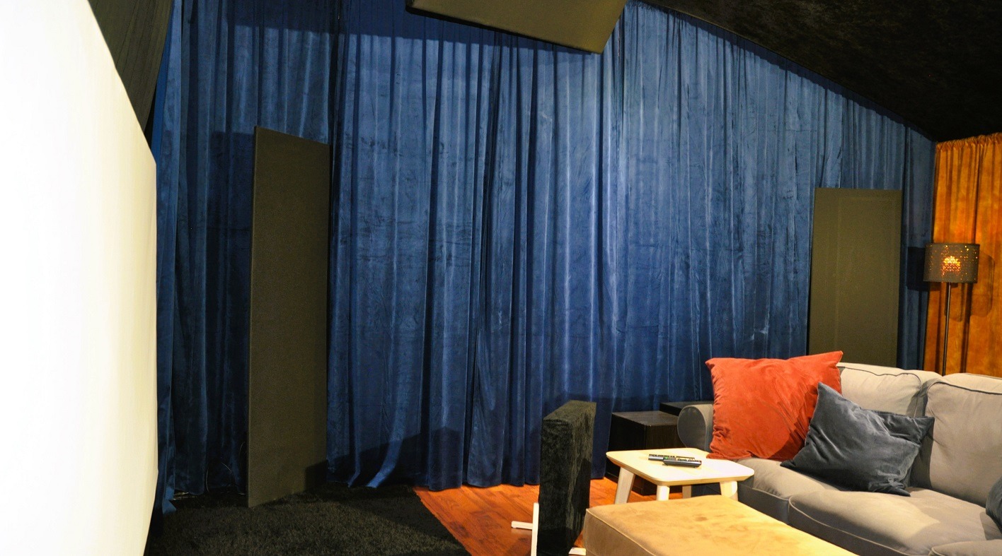

love ur foam diffusion “cloud”. Waf clearly isnt a concern 😂
quick question, do the drapes make the room slightly overly dead?
finally, do you have a pics of the eq curves at play?

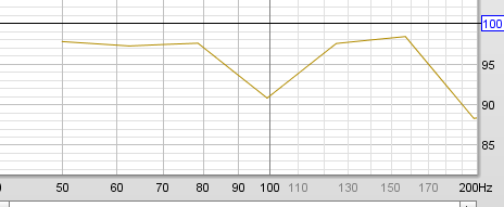

Hey Stig, with a frequency plot like that you certainly have bragging rights.! No one else posted the frequency plots of their bass, so a lot of opinions and claims without anything to back up their opinions or claims.The best bass I've ever heard measures like this in the main listening position (with low-pass filter @ 150 Hz).

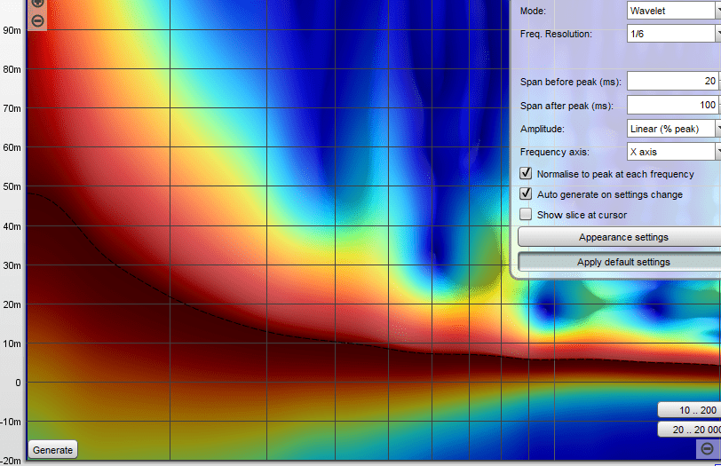

And its waterfall response... showing an almost total freedom from room resonances.
There is no low-frequency absorption in this room...
I suspect that a double bass array provides for the best possible bass (flattest frequency response) - probably better than multiple subwoofers strategically spread around the room. However, there is an additional challenge of matching the timing of the bass with the main speakers so that you don't end up with muddy sound at the crossover point. Since the bass drivers are behind the main speakers, how do you time align the bass with the Magnepans?

no less interesting are such graphs:
and clarity\definition, here is D50:

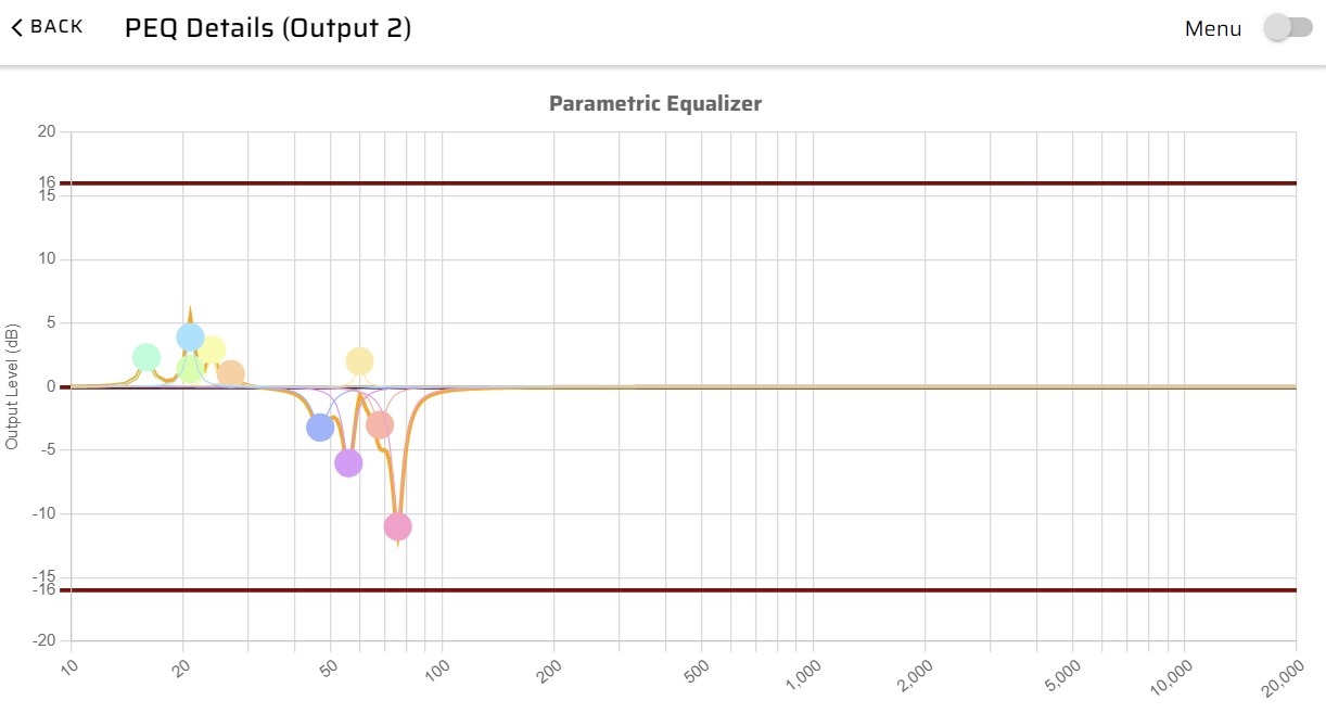

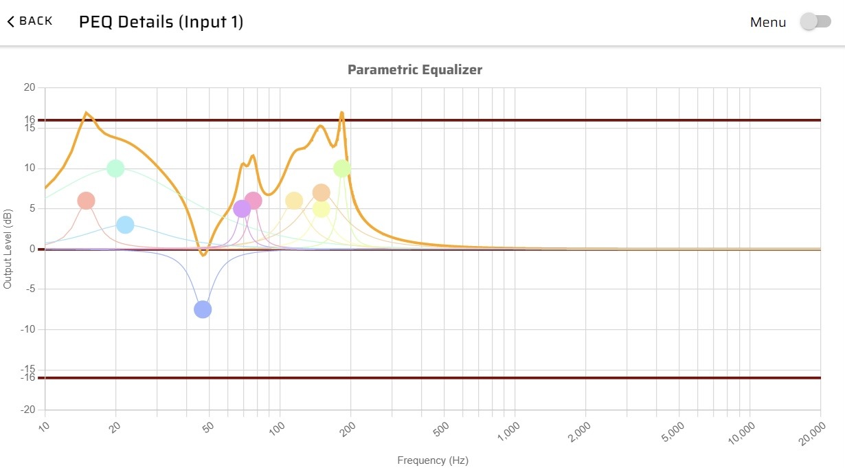

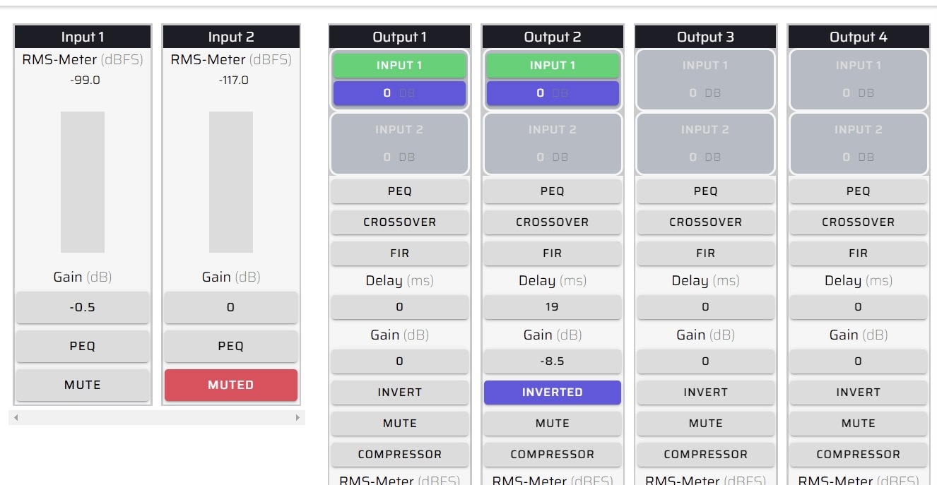

Yeah, the room is quite dead with all that diffusion. RT60 around 0.15 s. The drapes don't have all that much effect really, but they do increase the WAF!
I use a MiniDSP Flex on the DBA as you can see.
Overall setup
Input EQ
Rear array EQ
No EQ on the front array.

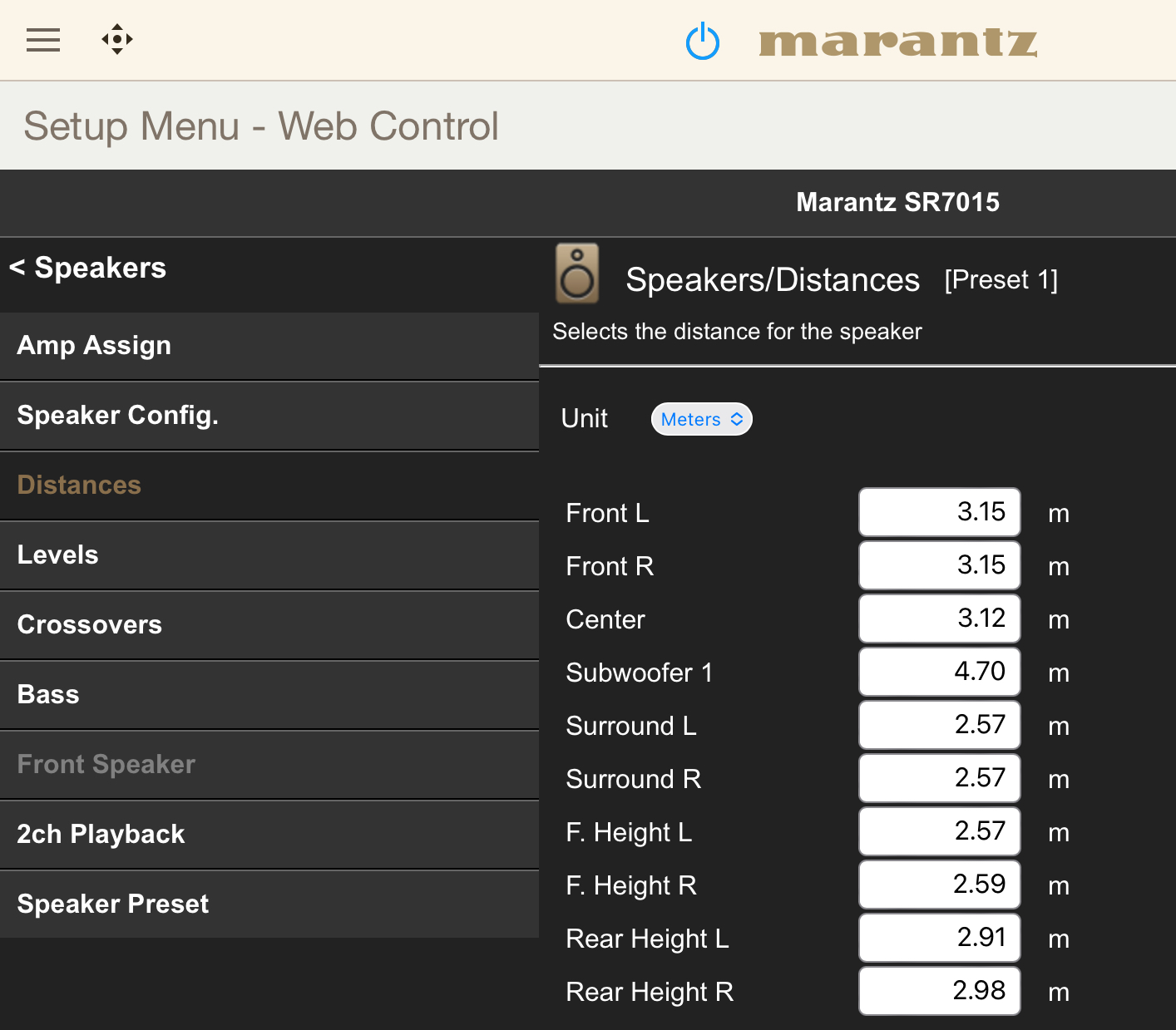

In my opinion, modern AD/DA sounds completely transparent. I go from digital to analog in my Marantz receiver, and then analog-digital-analog again in the Hypex FusionAmps on the maggies, and the same with MiniDSP on the double bass array. There are more important things to worry about I think. In my opinion, speakers and room acoustics is 90% of the sound quality. That’s where I put my effort.
