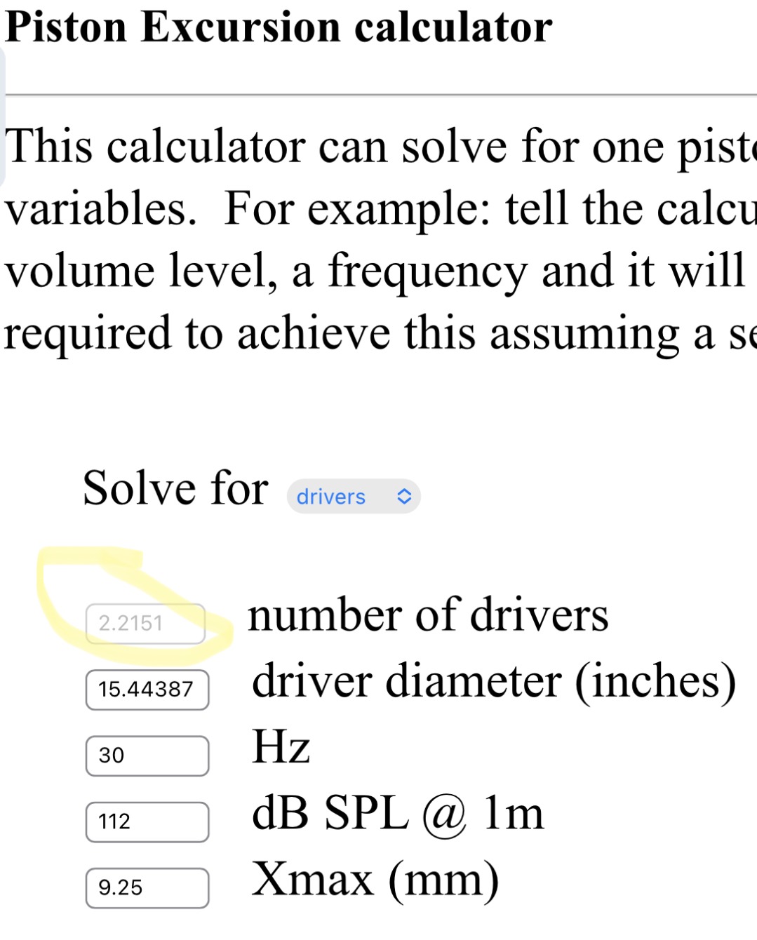

For one acoustic Watt output at 30Hz, 112dB, we would need a system that has volume displacement of 1200cm3
2x 18" driver with xmax >5mm
2x 15" driver with xmax >7mm
2x 12" driver with xmax >12mm
4x L26ROY
6x WO24P
10x ptt6-5x04-naa-08

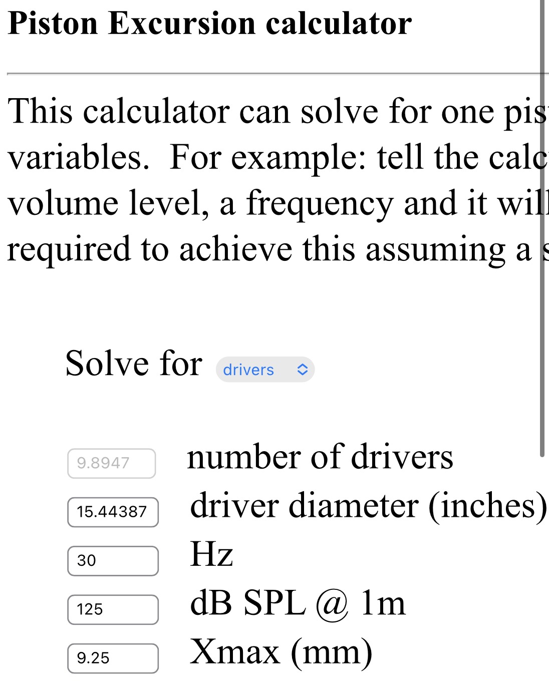

You need 2.2 of the 18FH500 at full Xmax to produce 112dB at 1m:
This is before baffle step so you need to double that again (6dB) to maintain your SPL target. Then if you listen at 3m you’ll lose another 10dB, so you need to target 128dB at 1m, per side. But if you’re happy with 128dB peak in stereo (assuming low bass is mono), you can aim for 125dB per side (summing of incoherent acoustic sources). So you need…. a lot of drivers… 10 x 18FH500 per side… I like it 😂
Purifi need not apply
Don't forget the gain you get from being in a listening environment that is more constrained than half space. In a real room at low frequencies you won't lose 10dB from the 3M listening distance either.

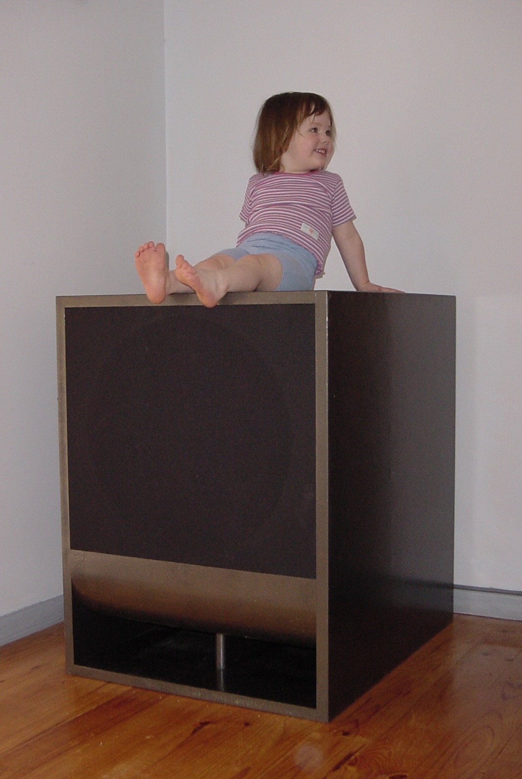

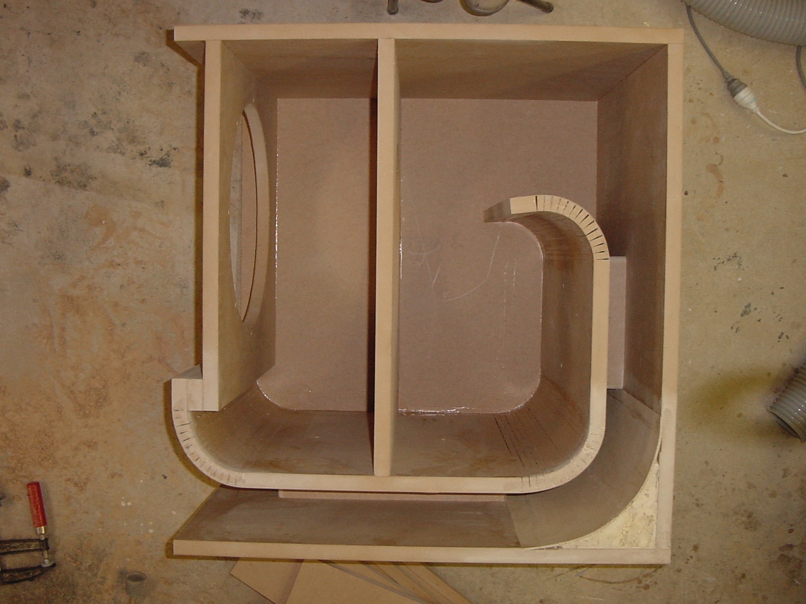

In reality a pair of 18"s will do a pretty good job with music in a domestic environment. I ran a pair of 18LW1400 at home for a few years and was completely happy with their output. They could effortlessly move stuff around the house. 🤔
250L tuned to 22Hz. One box per side.
