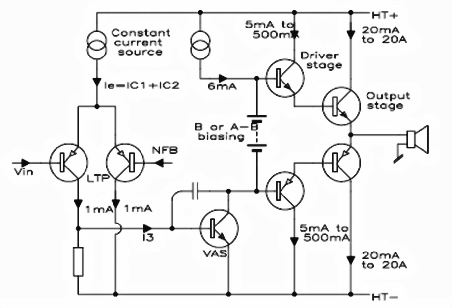

I don't know why current mirrors on top of LTP sound like crap, but they do. Maybe I've implemented them in a bad way. I've just tried it with 100R emitter resistors. Maybe it's that memory distortion thing, and far higher resistance should be used.Lumba Ogir said:nelsonvandal,
Correct observation (this time). But what is the reason for that?
In my folded cascode amp where I use improved Wilson mirrors on "the bottom" of the common-base transistors, the sound improved when I changed the emitter resistance from 50R to 250R.
And Lumba, you were wrong when you said this little amp was stillborn. It sounds almost perfect now. Just slightly warm, and I think it's because of the "lowish" voltage drop over the diodes to the common-base transistors. With a larger drop, 4.7V, the sound is brighter, and in LTSpice I can see a good reduction of 2nd order harmonic. But this larger drop the amp's not good as a portable device due to the lowered voltage swing.

Hi Nelson,
quite many people are of that opinion, It`s not memory distortion nor your implementation, rather the increased open-loop gain.

I'm not really convinced it's all about OLG, are you?

I've tried to lower OLG and increase OL BW by increasing the LTP's degeneration resistors and used local or nested feedback loops. Not only in this amp. None of these tweaks alter the sound as much as the use of current mirrors. The transistors used for current mirrors, SA970, BC550 or BC560, have had exactly the same Hfe and have been taped togeter for temperature stability. I've tried it with no or 100R emitter resistors.

Suresh,
I do not believe the AKSA topology is the best, but it is widely used since Harry Lin and Arthur Bailey used it in the fifties and sixties. It is a road well travelled, and possible to refine it to very good performance.
However, if you want to extract more performance, you need to go down the zero distortion path, the traditional engineering approach. For this you need to examine and refine further - which means considerable added complexity - each and every circuit block; input stage, VAS, and output stage.
This all adds complexity, and of course component count. It is still a direct coupled Class AB topology, but for 100W into 8R you need about 16 transistors, which is getting pretty serious. Further refinements to the output stage add still more devices, at least another four.
Such is the complexity that you are then well advised to examine Neslon Pass' circuits. He achieves astonishing performance levels from simple topologies, mostly by very clever design and well chosen operating points. I favour his single ended designs. It is not for nothing this man is so highly regarded; his comprehension of the entire process of recorded music is amongst the clearest I have ever seen and his dedication to the DIY ethic is legendary.

Give yourself a gift.... take this basic topologie
This one from Duncan.... well..... belongs to the whole world, it is the very basic three stage amplifier, alike Aksa and many others.
And do it the way you want...the way i have made to myself...a pitty was that i could not beat Aksa 55.
But maybe you can be happy not comparing with the 55.....adjust it to "your way"..... make it "your style"...do it yourself..... basic Universal topologie made by YOU.
Adjust current, try different currents.... try different voltages, try CCS and rail regulators and power regulators and mirrors, double this amplifier, use it bridged, try double simetrical input, install three or two stages VAS.... try different current to drivers, try many classes of operation, try current sinks, mirrors, CCS into the VAS and into the drivers.... try all you know, all you can and be happy beeing a real DIYer.
Try new input, new differential.... test options offered by some guys in this forum..check them and i hope you do not turn deceptive with those folks.... try new ideas to feedback, multiple feedback, local feedback, NFB, multiple feedback...all stages with feedback,...none feedback...try slow transistors and fast transistors..then install FET to see if you like them....try class A ....well....you have the whole world in front of you to explore.

now a question for carlos
to see his understanding of amplifiers
why we often see one PNP input pair?
... and not so often NPN, which are more of, and so much more choices for

I use PNP transistors into the differential because they
have more gain than the NPN complementary part.
I do not know the reasons others use PNP or even NPN.... all i know is this... because gain only.
This question is great.... i hope there are other reasons and this is a good chance to me to learn that.

Has anyone played around with the Bryston output topology (it seems so symetrical: the output current is shared by an idetical NPN/PNP pair both pushing and pulling) I know these OP trannys need some matching but is that a problem?
Yes...better to use PNP Vas.
