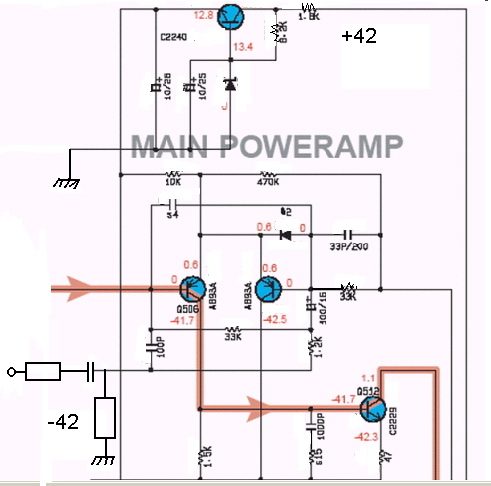

The more i study the subject, the more i turn convinced that this thopologie is....
This thopologie is really the best.

The schematic, the thopologie is the same as AKSA, same Sony is using...same as STK is using.
So..cannot be bad..it is impossible!
It is possible to be the best sound man could produce..this is possible and probable.

Best can mean many things to different people. The topology
above (Bootstrap-C loading) is more stable because it
naturally rolls off after 200Khz (most amps oscillate at 800k-1Mhz)
I,ve seen MJL21193 (patchwork amp)use his amp stable with NO zoble
into speakers. No fire:hot:
As far as being best ...Nah..
1.no current mirrors= less linearity=more distortion
2. huge Cdom (miller)..1000pf shunted to ground=poor freq. response,
loaded down VAS.
Its seem to be an amp that feeds kids in japan but hurts ears
everywhere else .(cheap department store amp)
DXamps, ASKA,patchwork,self, and others are WAY better
sounding with better design.
