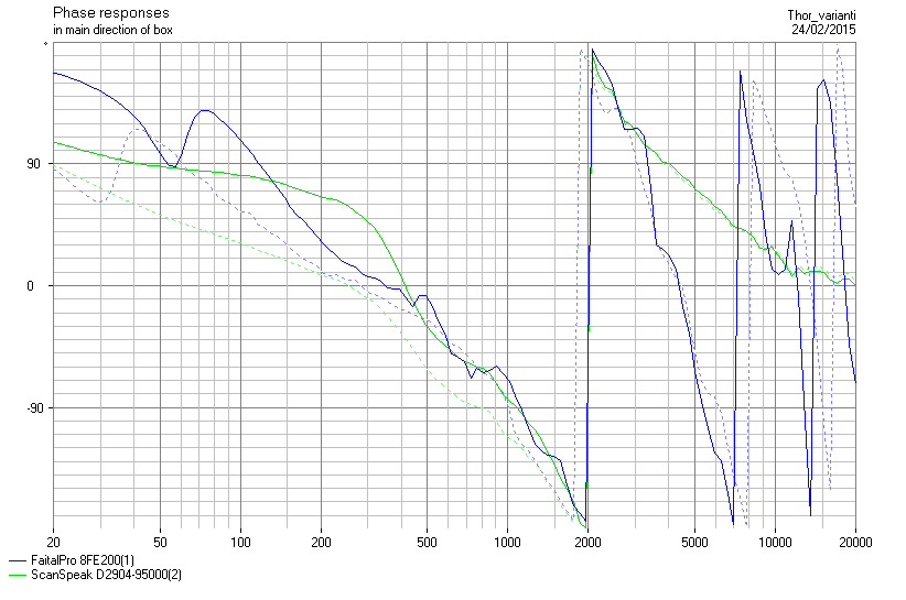

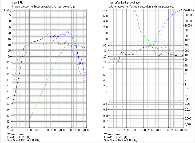

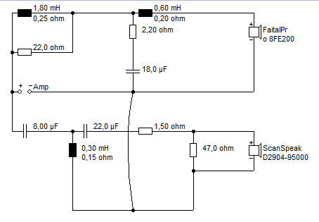

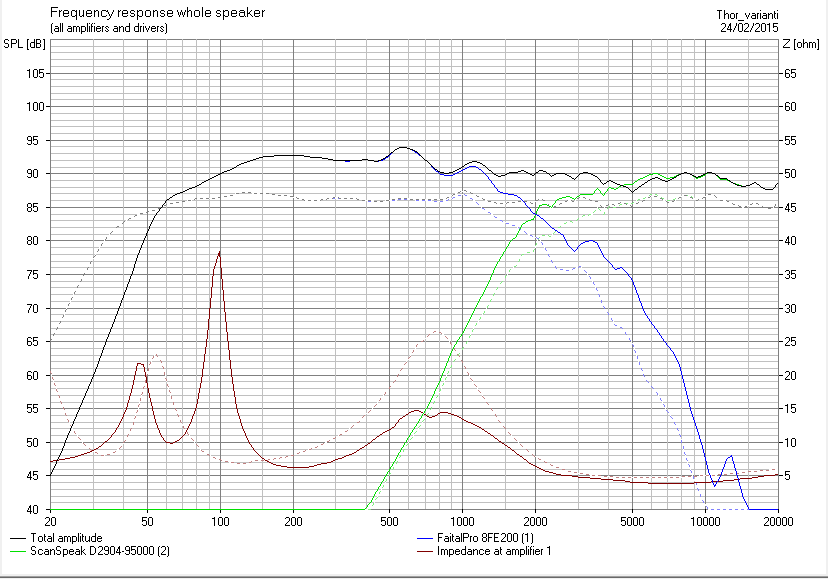

Hello, I'm here with my choose, which passes through FaitalPro but not that said but a wonderful 8FE200, which has a light cone, a stiff suspension and a measured Fs of 62 Hz (against a declared one of 80 Hz, see impedance graph: I don't understand this strange thing, since compared, for example, to Eminence Alpha 8-A it's lighter and stiffer while the second has an Fs declared and measured of 70 Hz). Anyway, I think it can be the best way to begin and experiment with PA mid-woofer, of course put beside a subwoofer, since of its extremely low price too.
Here's my design (dashed the original New Vifa Tower):
Look at the MIL: its reasonable long Xmax matches very well power request below to 50 Hz..it's incredible for a so high Fs woofer : )
I'll let you know every step of building and listening..of course if you know.
Thanks, but please tell me what you think : )

Hello Active, I've choosen FaitalPro 8FE200 just because its cost is well related to the risk of a possible fault of my experiment but I think that driver you said is good but take a look also to the 8PR200 which is the lowest Fs 8'' driver.
About Fs, I'm still expexting form them an explanation about the shift between the declared data and the impedance graph peak which affects some models as 8FE200 too.
A question, why do you plan to use sealed cabinet? May you have a sub to work it together, right?
It's clear that there drivers won't have low extension, expecially in sealed box, but if you put a sub beside them it will help. Please note that in a sealed enclosure F3 raises even more than vented and setting up the sub F3 too high will make it acoustically more noticeable.
Maybe I'll say something foregone: in the Faital spec sheet there's a EBP value (= Fs / Qes about which it was talked here), which is rather high for our drivers to use them in a sealed enclosure.
..cool news: FaitalPro has just answered to me saying that correct data for the 8FE200 woofer about Fs is 80 Hz, the impedance graph curve is wrong and thay're just working to correct it.. what a disappointment.. : (
