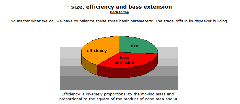

Whether the equalization is active, passive or acoustical, or a combination thereof, you will find loudspeaker design without them to be a "mission impossible".
If the system you end up with has a low [Qt] (translate "crispy", "snappy", "punchy") then early roll-off of the low frequency response is a certainty. Without some form of equalization at the low end, this design tack will leave you with a suboptimal design.
Note as you increase motor strength [Bl], while keeping moving mass [Mms], compliance [Cms] & Voice Coil Resistance [Re] constant, you reduce driver [Qts] and increase system [F3]. I presume you are using sub-woofers in your system, so an [F3] of about 80 Hz is where you want to be. I suspect cost is an issue here as well, so beefy PA drivers are not a particularly attractive alternative.

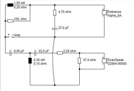

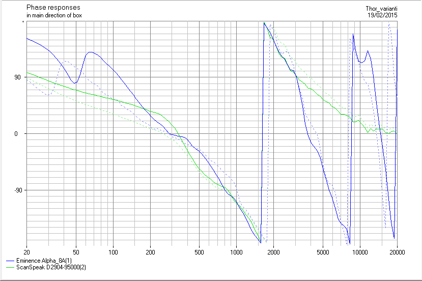

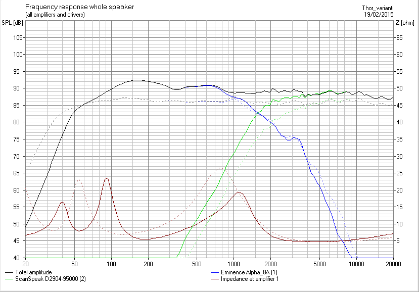

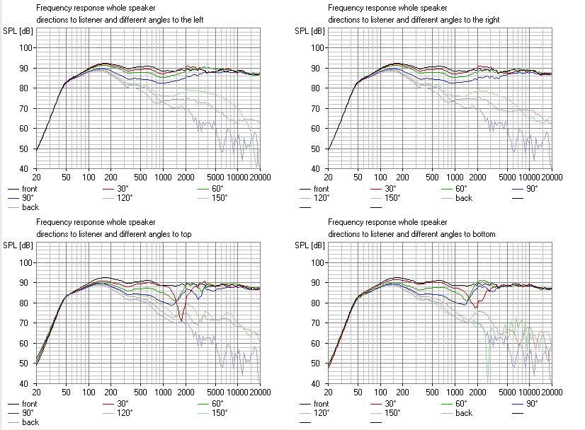

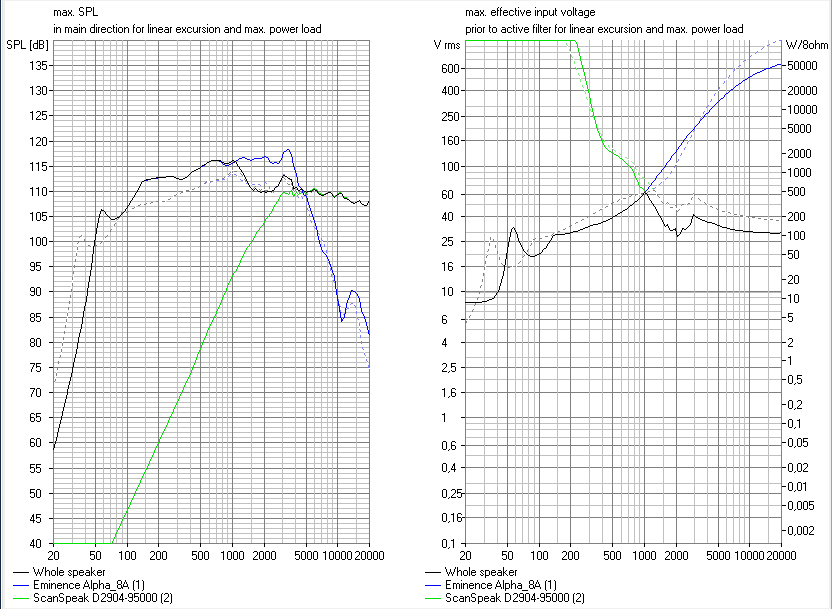

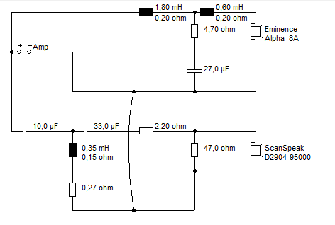

Hello, I'm here with my idea about substituting my Vifa with a PA driver, temptation is too strong : ) This is simulation using an Eminence Alpha-8A, the highest Qts driver of its class:
What do you think about? I've got convinced that PA drivers can give more fun.. moreover Eminence costs very lower respect Volt, the only possible alternative candidate for me, it's easier to mount and I'll be able everytime to add my sub to the system.
Let's see what will happen : )

Good heavens take care about the Eminence Alpha 8A,I didn't use any high pass filter for woofer in XO design but of course it's necessary because as it is it can't handle power input below 100 Hz because of high excursion.. In this simulation Fb is tuned at a lower frequency than driver Fs. Excuse me please!

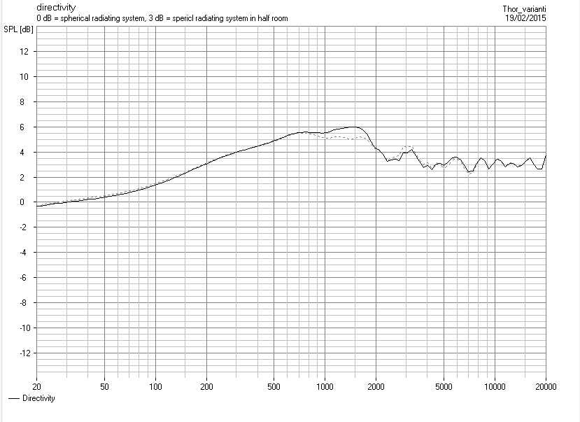

Hello, yes, probably a PA driver for 20 square meters is misspent but what I need is its timbre, I don't care about power or sensitivity. However, here's maximum power capability for the Eminence above-mentioned project, after all there's a minimum at about 90 Hz of 50 W, which may be ever difficult to reach in my listenings, and after after all New Vifa Tower had a minimum at about 50 Hz of 30 W but I never noticed any problem even pushing power.
Please see (crosspoint has been put to 2 Khz for the same reason):
Do you really think that 90 Hz dip in the right graph may be a problem?

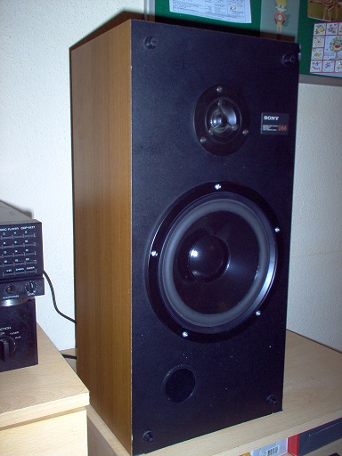

Cloth surround and transparent dust caps and light paper cones are one approach to the lively sound:
The above cheapie Sony E44 bass is excellent. I suppose an eminence Beta 8 does the same sort of thing in about 20L of reflex. The plastic cone "balanced drive" tweeter is surprisingly good too.
