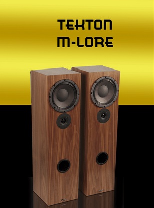

I remembered a speaker that variously uses the Eminence Alpha and smaller dustcapped Beta 8. It's the Tekton M-Lore.
Tekton Design M-Lore Loudspeaker Reviewed

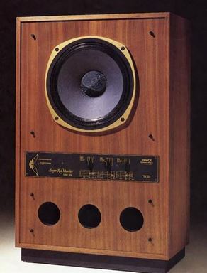

Looks like about 30 Litres of reflex. Tannoy used to do this sort of thing with dual-concentrics too.
