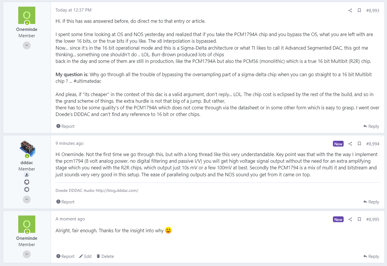

Yes, but the focus is on the lower 16 bit's which are true bits, so NOS. That is to say that few chips manage to produce good oversampling compared to sticking with the 16 true bits. It also appear that 20-bit have a higher quality of over sampling compared to 24-bit... at least from my perspective going over the available material.
Doede explained why he choose the PCM1794 over other true 16-bit chips.

Ken, bit resolution does not give the same number as ENOBYep. It has long been true that audio DAC chips have 'featured' bit resolutions which they don't come anywhere near effectively resolving. So, while the AD1862 'features' 20-bits, and the PCM1704 'features' 24-bits, neither monotonically resolves those bit-depths. I'm not aware (but, I may be mistaken) of any audio D/A units which are better than about 21 ENOB, including the Sigma-Delta units. Of course, the other side of that is that the ear couldn't utilize that dynamic range even if DACs could resolve it.

It’s fairly easy to check for bit resolution at home using single tone test frequency FFT and watching for the x dBFS test signal peak just emerging from the ground floor (practically, bit resolution= x/6).
Or better zoom-in at the lower range of a gain-linearity plot.
It is more involving for an amateur to specify ENOB

I concur, George. This is why DAC chips spec’d to support a raw 24-bits compute to some different ENOB. The ENOB isn’t synonymous with bit resolutionKen, bit resolution does not give the same number as ENOB

Regarding ENOB: from an error budgetting point of view, you normally like the analogue noise to limit the signal to noise ratio of a sigma-delta DAC, because reducing the digital noise by adding an extra bit is much cheaper than reducing the analogue noise by 6 dB (for a given architecture, that typically means quadrupling the analogue area and current). Hence, you get an input word length well above the ENOB.
