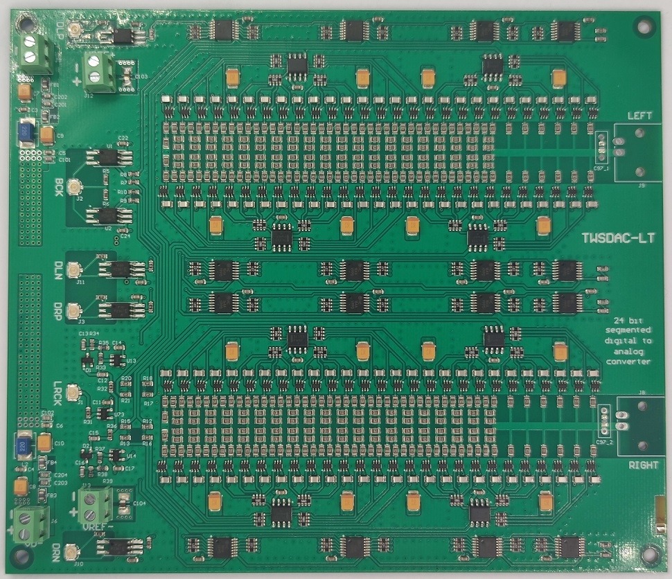

...as the IV stage is integrated into Andreas discrete...
Not seeing a clear IV stage in the pic below. Looks more like direct out from the resistor array.

Current-out R2R array loses linearity if the output voltage deviates even slightly from zero. Thus I'd hazard it makes more sense measurement-wise to go voltage-out R2R and employ a buffer.Not seeing a clear IV stage in the pic below.
