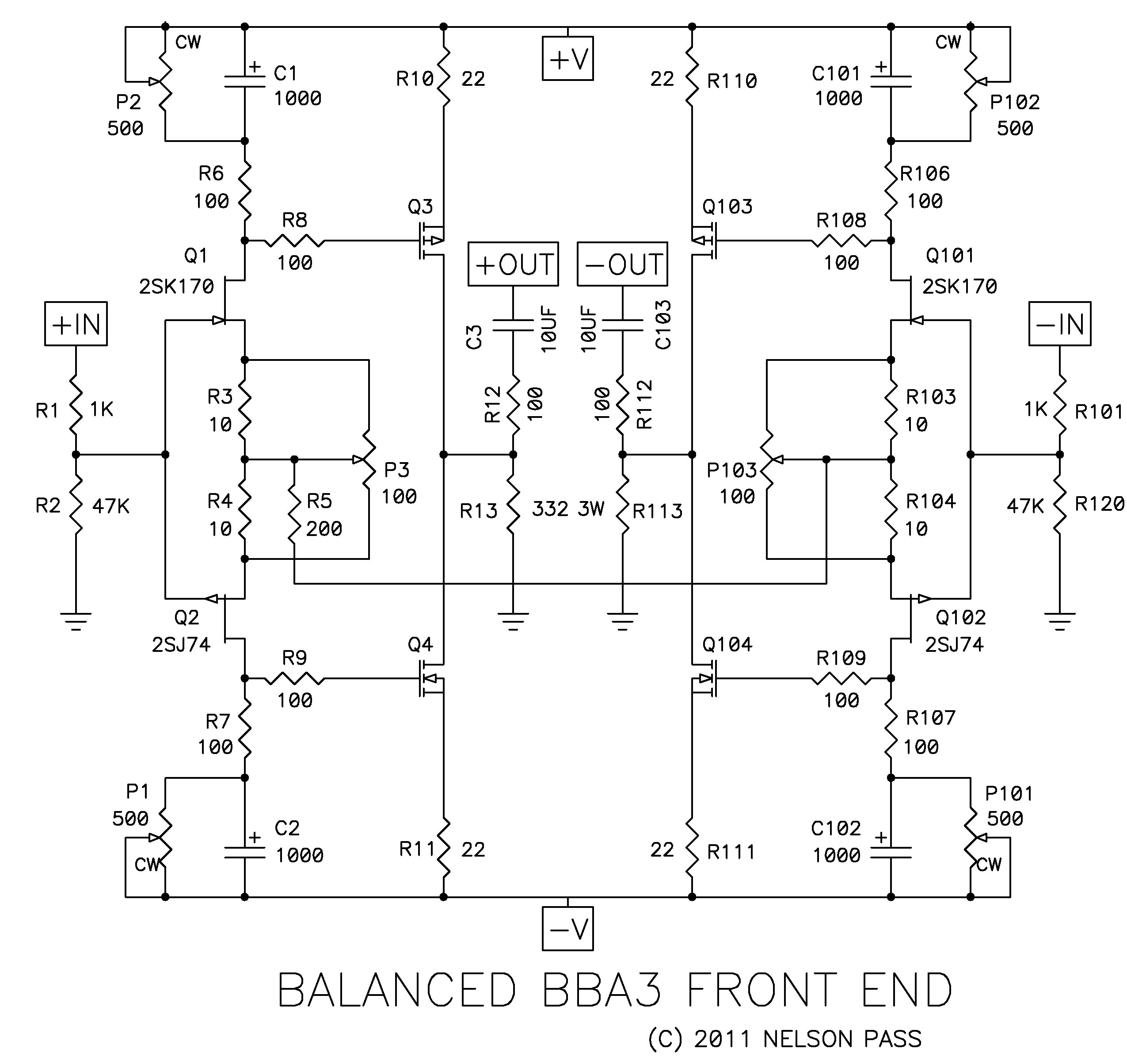

... Wouldn't then the negative part of the BA3B FE (being grounded) act only as a white noise generator for the corresponding negative part of the output stage?
No, Pass magic :worship: (in the form of R5 connecting both sides of jfets summing points) ensure equal magnitude but opposite phase signal on both outputs of the BBA3FE when one of the inputs is grounded. A True Balanced, No pseudo-balanced, No white noise generator, No need for any addition Nor modification.

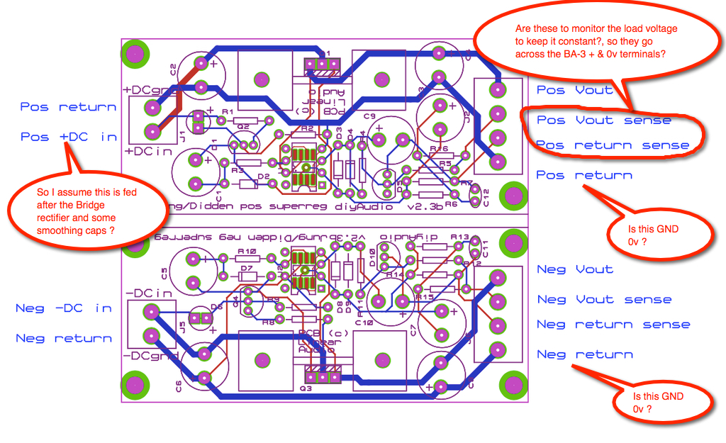

Hi Guys,
Need a bit of clarification regarding the DiyAudioStore SuperReg Wiring for the BA-3 Pre-amp. Some of the info links for the SuperReg no longer work. Seems a bit confusing. I'm used to just AC in then +24v-0-24v out for example.
Have I got it correct in the diagram below ?

Hoi Mark,
I built the exact same configuration. You can tie the Vsense to each corresponding Vout, and wire from there. See my edits in black on your picture. That is easiest.
You can also extend the Vsense like I did with a smaller wire to the point where you connect them both on the BA3 PCB.
That's the best way, but difficult.

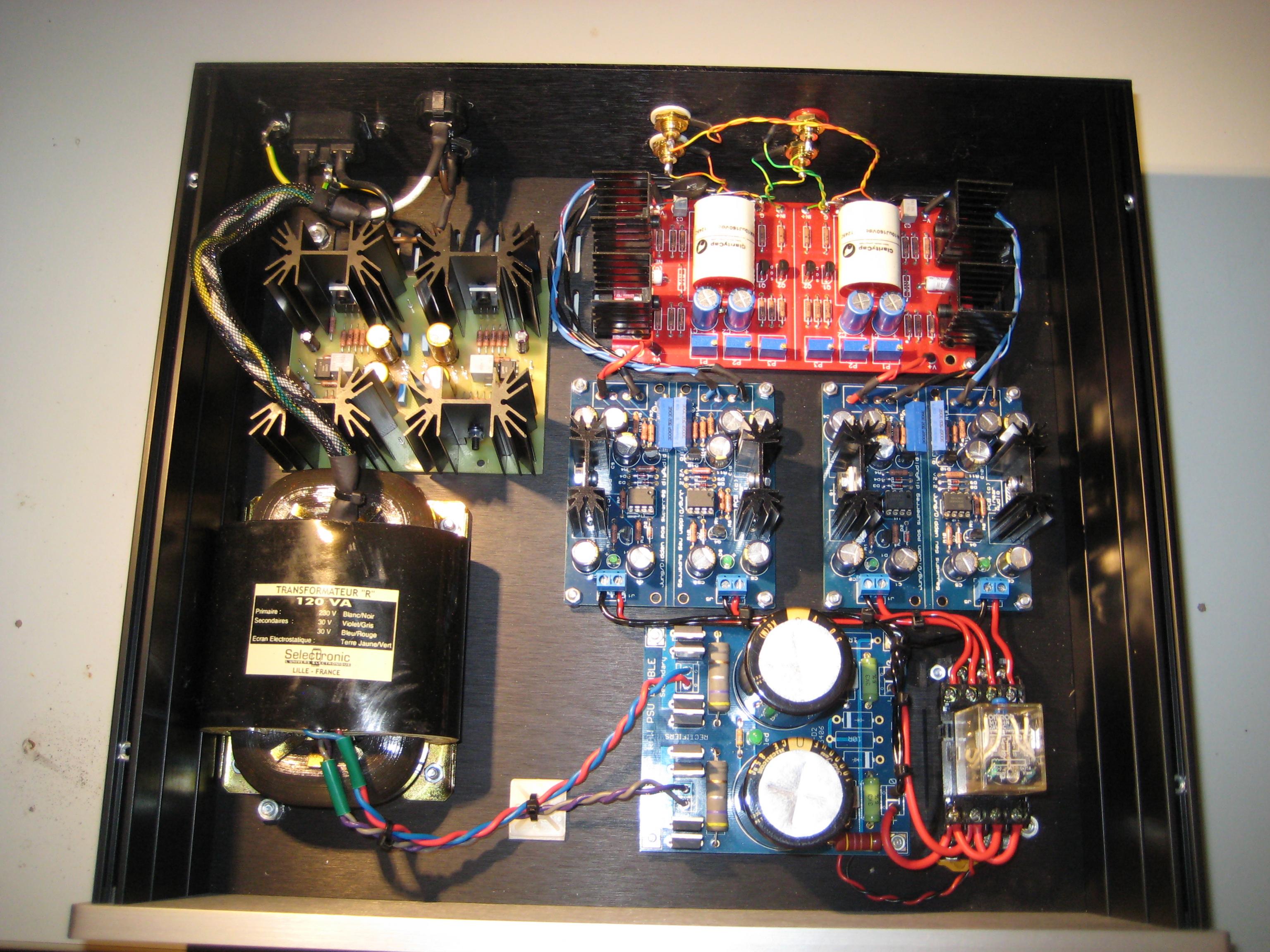

I have attached a high res picture so you can see how I did it, but wiring is difficult that way. Especially at the GND connection of the BA3 PCB where 4 wires terminate.

Hi Walter,
Thanks for clarifying 🙂
A few questions regarding your build, (Very nice by the way). Why did you use two SuperRegs, I assume you could have just used one?
Also what is that Bridge Board you used, I can't make out the name and are they still available?
Mark.
