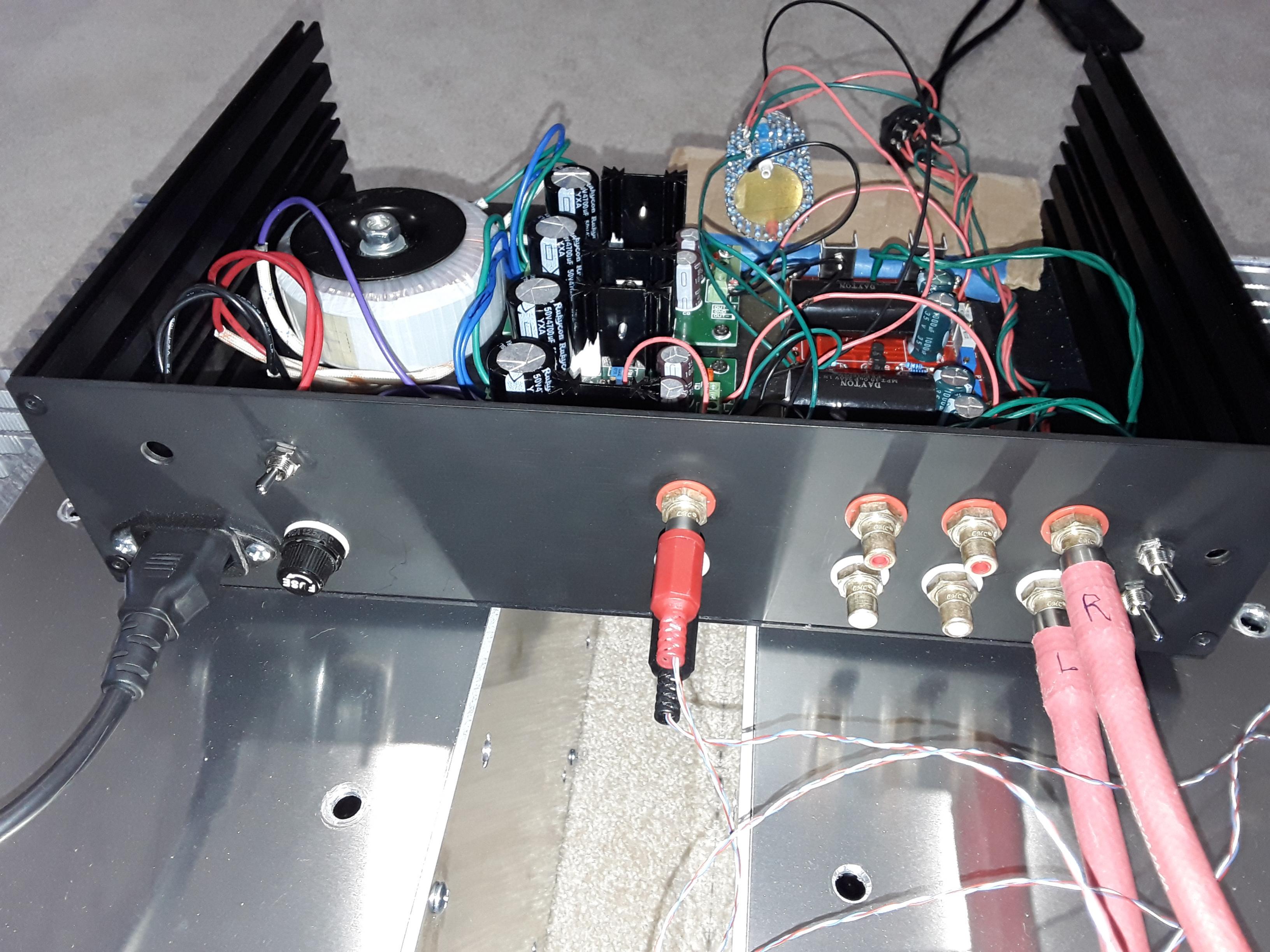

Another BA-3 Preamp in the books! My second. I think the boards are ok ;)
Added switchs to adjust the gain between high (normal) and low.
Here it's driving the MoFo mono blocks, which need high gain to drive them.
The 10mm face plate is too thick for the pot and switch.
Needs to be milled out.
Vince

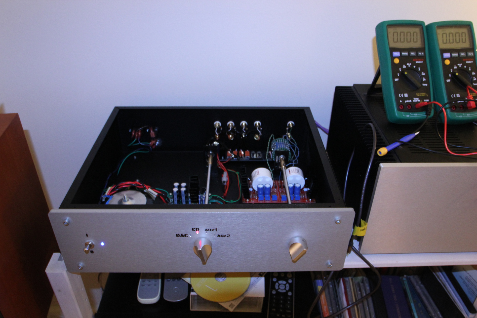

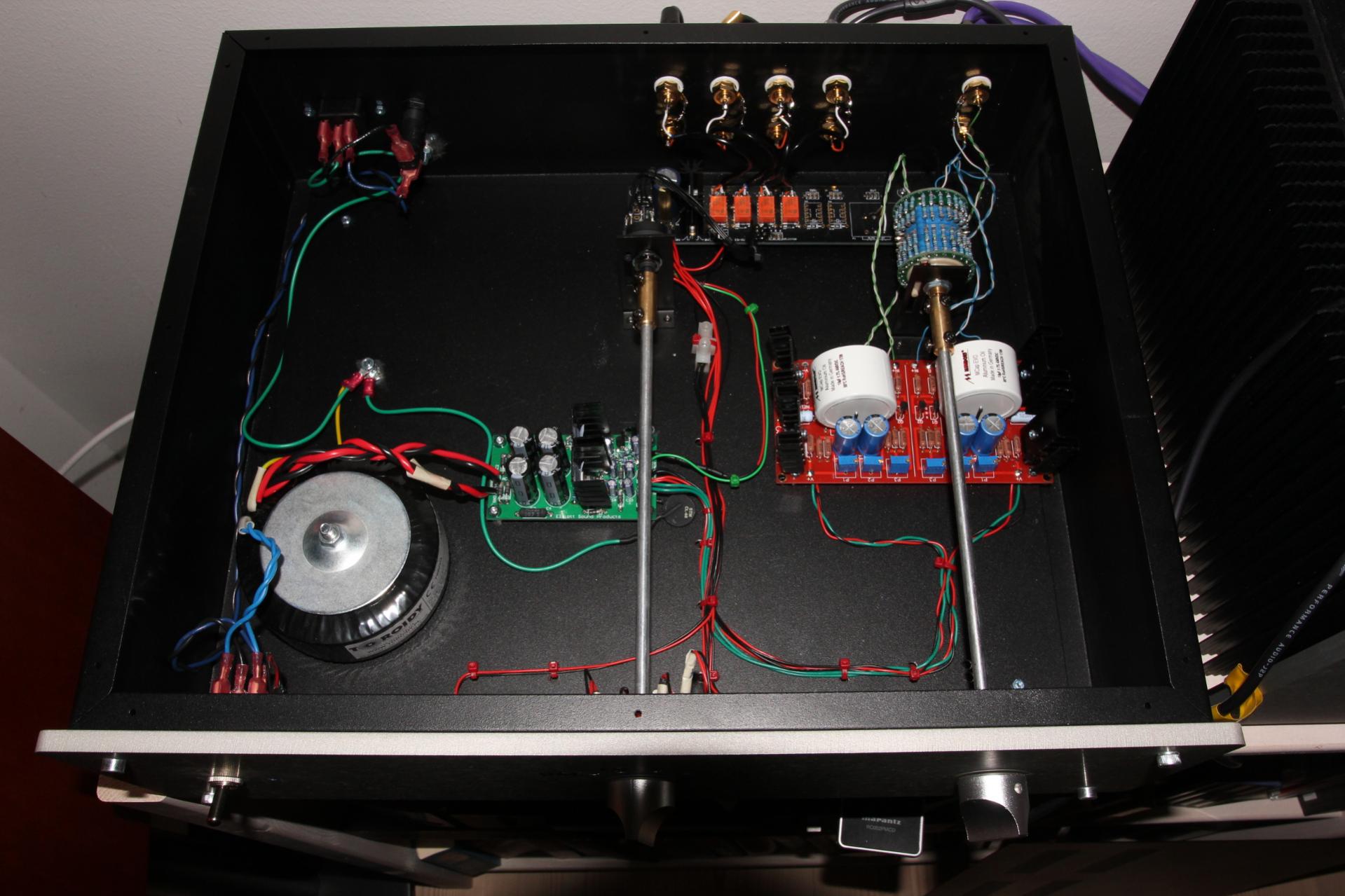

I said i would upload some pictures a while back, so here goes. I've had about a months time with it since finishing and i love it!
This was my first time doing some more serious casework, and that shows. Still, i am reasonably happy about it. As evident, the case is way to big, but it was pretty cheap and nice quality from Toroidy, and on the plus side it is absolutely hum free, no doubt owing to the massive separation between toroid and BA-3 board:)
attachment.php
Transformer is toroidal 2x22v from Toroidy also, PSU is Rod Elliotts preamp PSU set to 24V. I gather this is a bit more than it was intended for, and fitting the heatsinks to the LMs was a bit tricky since it is quite tight. Also, the wire holes were tiny so wiring it up got quite fiddly.
I used Salas I-select for input selector, together with his LED-selector solution (front pic below). I really like this board, i wish i had bought more than one! It gets power from the AUX section of the PSU, dropped to approx. 27V DC using 4 diodes in series.
attachment.php
Selector is cheap Valab one from Ebay, it's cropped up here and there in this thread before i believe (same as you vdi_nenna?). Mundorf caps, again if i ever build another one (i might) i will use something less wide, measuring the bias V was a pain with these!
jfets from store, matched toshiba mosfets from liubincalvin. I grounded connected a ground shunt on the output using a 100k resistor i believe (as per instructions from mr. ZM). It replaces the digital preamp mode of my audio streamer and punches way above it. It sounds gorgeous and has much more gain. For my 86db/W 4 ohm speakers (Dynaudio excite x16) i can now play much louder than i need :D I have actually not been above 3/4 of max volume yet since things start shaking by that time and i like my neighbours...
Thanks 6L6 for this great build guide, i studied it intensely while waiting for parts to arrive, and it allowed me to finish the build without major hickups. Such a great resource to us beginner DIY'ers! Thanks Mr. Pass for generously making this design available. Thanks to ZM for helpful answers along the way!
