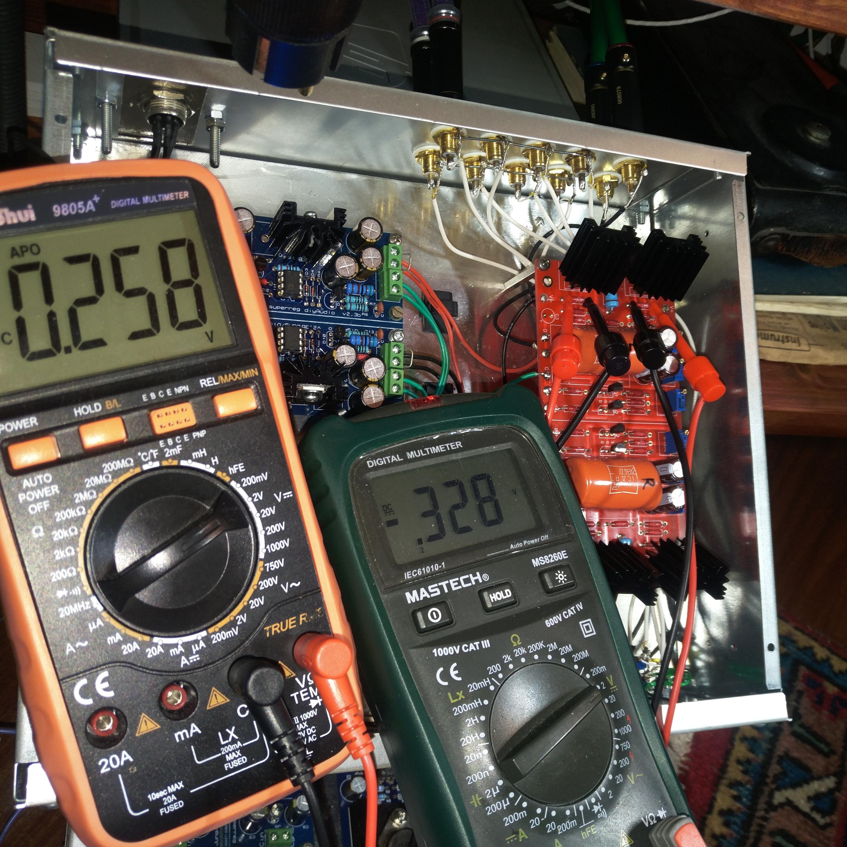

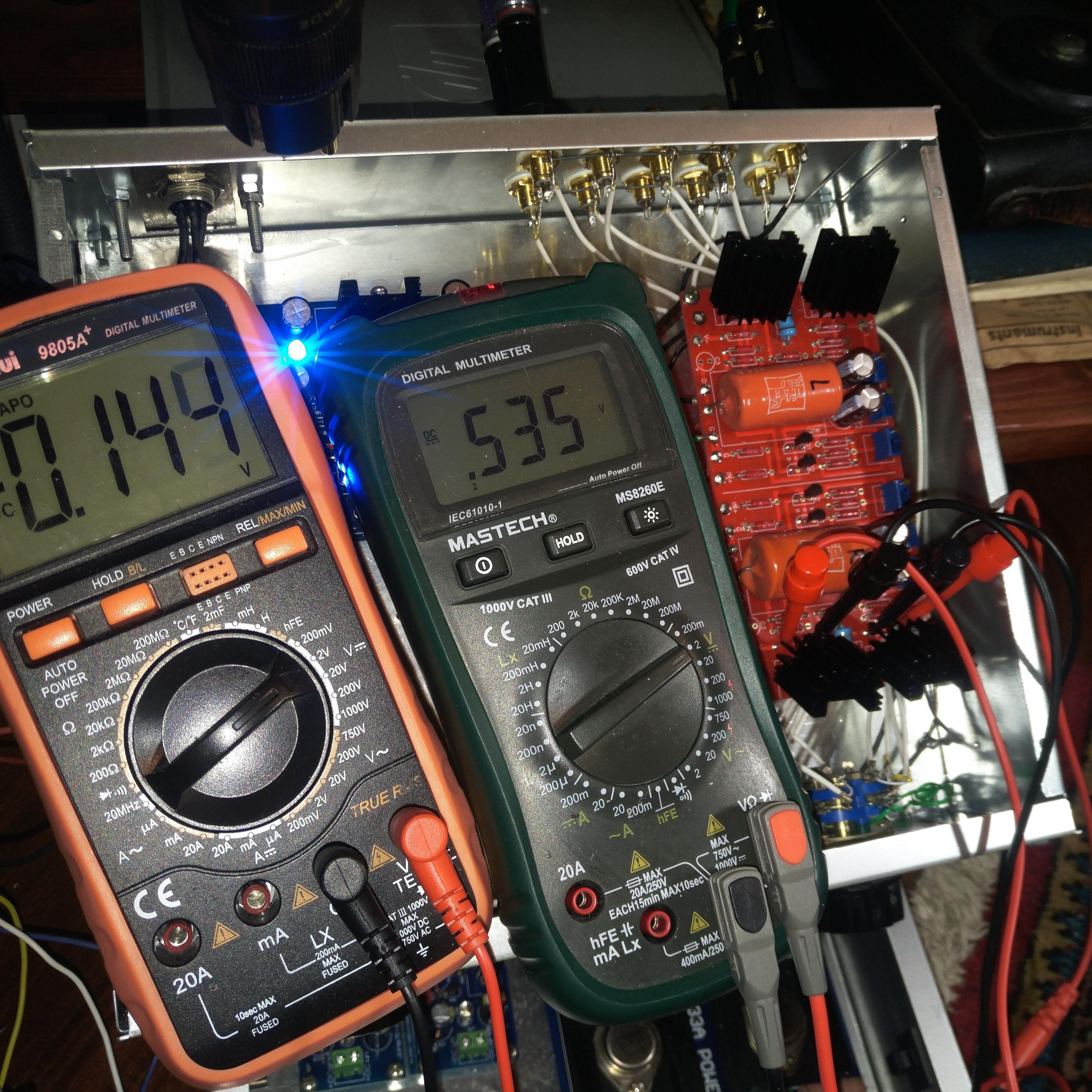

Here we are as you can see...something wrong It seems to me Was done

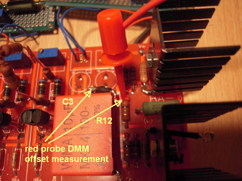

What is your DC offset? (R12 to GND)
The more important question, what is maximum bias you can obtain with zero DC offset?
de118 #2008

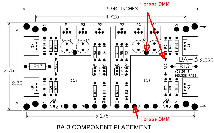

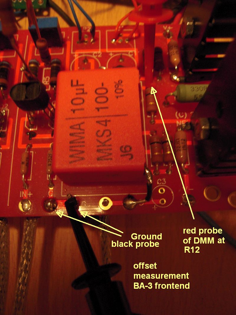

Hello de118,
nothing is wrong till now! You only have a very large offset between the n- and the p-channel bias.
If you adjust P1 or P2 try to get equal values at your DMMs over the bias resistors (R10/R11). They will not be exactly the same value (in mV) if you try to bring your offset close to zero mV. During adjustments on P1/P2 try to keep offset below 50mV (sometimes I go up to 100mV).
You will need patience! 😉
And you have to measure your offset - check pics below.
I wish you success! and patience! 😀

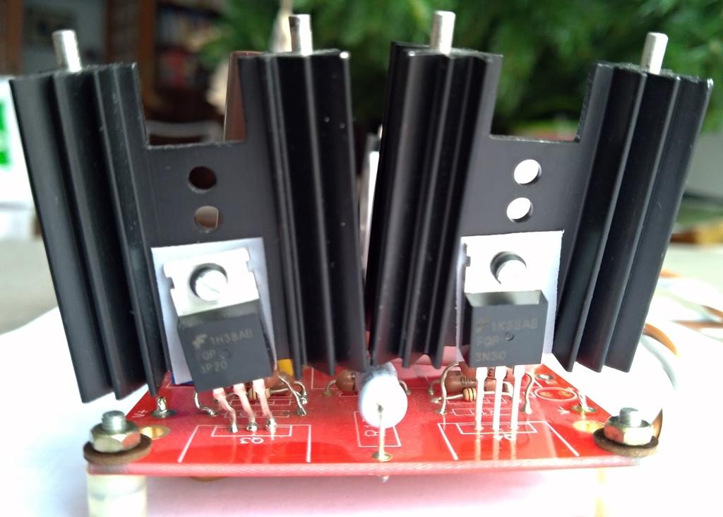

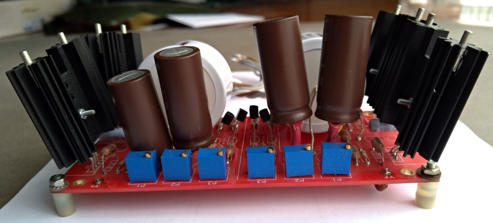

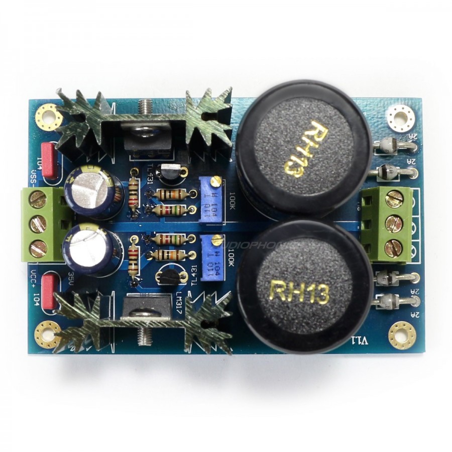

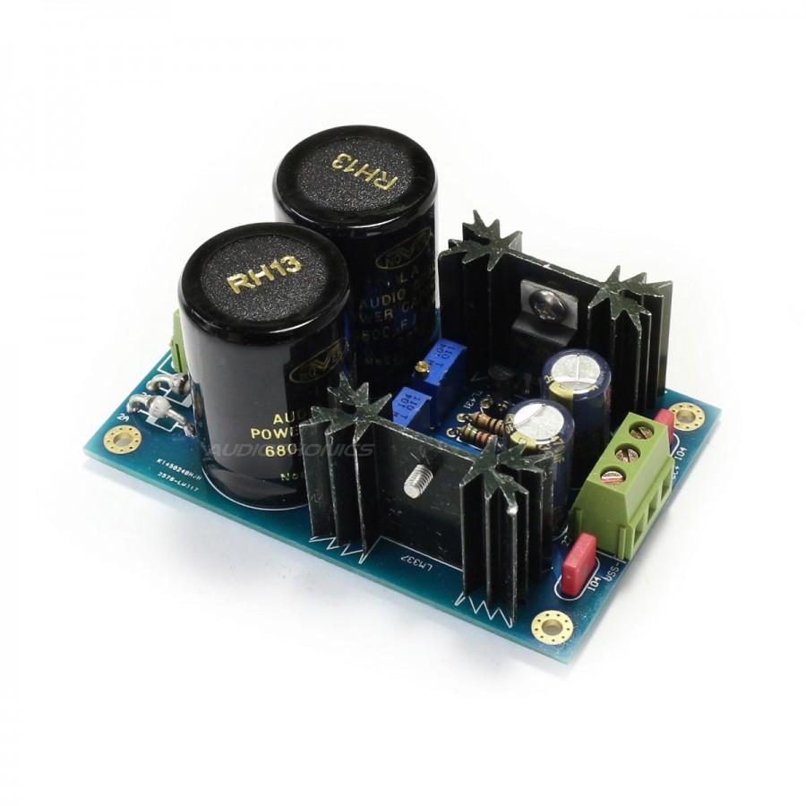

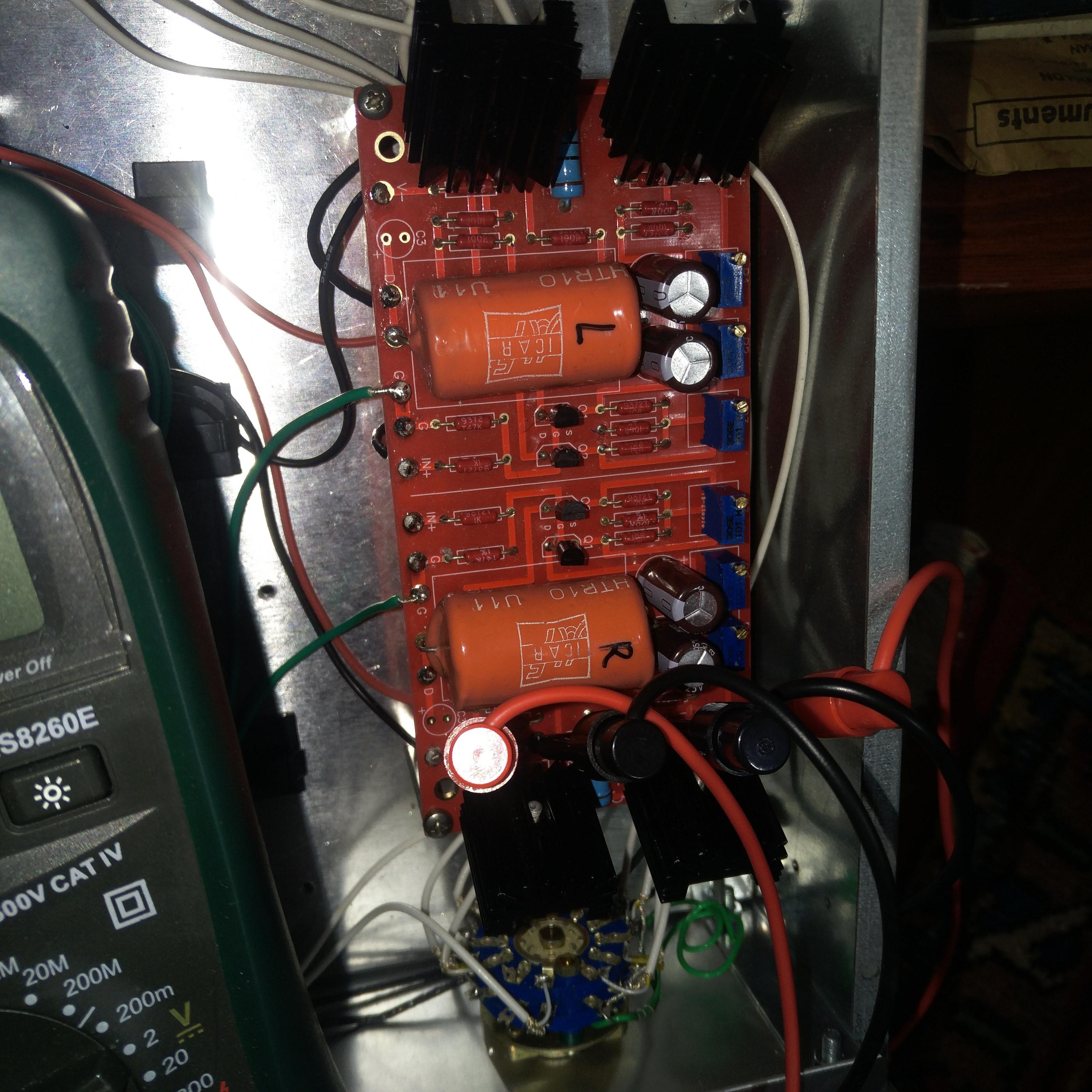

Hello all
I need your help to solve the problem of starting my BA-3 pre, I have a Lm317/337 power supply set to 24V to supply the BA-3 pre, when I connected the BA-3 pre for the 1st time, the heatsink of the LM337 (-24v) reached 120ºC in less than 1 min, the LM317 heatsink (+ 24v) was at 40ºC. The voltage dropped to very low values (+ 15v and -10 v) simultaneously, the Mosfet Q4 heatsink of one channel reached 50ºC, the heatsink of the Mosfet Q3 of the same channel reached 36ºC ....
The sinks of the Mosfets on the other channel barely heated up.
All of this was done with a lightbulb mains lead on and the lamp very bright.
Someone can help me?
Do I have a short circuit, or is my power supply defective or am I mistaken in some component and I don't see it?
I removed the BA-3 plate to see if there was any component in the wrong place, but I can't find anything wrong ....
Any hypothesis is welcome,
Best regards
Carlos

You better test the PSU by itself first. LM317/337 doesn't need a load to operate. Make sure you have the correct voltages out of the reg.
If PSU is good it looks like your mosfets are installed correctly. Are they isolated from the heatsink? Check with a meter. If they are not and they are touching each other that's a bad thing.
I see some areas where solder has not flowed to the top of the PCB. That's not a bad thing in itself but can we see the underside of your PCB too?

Well, I would reflow all the solder joints...just to make sure. Some of the solder joints appear like they may not have enough solder although it’s hard to be sure in the pic. make sure mosfets are installed correctly...although they appear they are. Jfets are from a reliable source?
I would check the trim pots with a meter to make sure they are still operational. That is a lot of current flowing through those pots.
Did you start up the amp with bias too high? What was the initial bias like when you started the amp?
