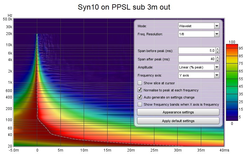

Looks like both woofer (5 ms) and mids (less than 1 ms) are ahead of the tweeter, at this distance. Somewhat further out, 1m from mouth like Mark suggests should be saver to see proper timing. Do you use phase linear crossovers? While Tom Danley shared some hints how he did his crossover, I don't think he ever shared the complete topology.
I'm glad I nagged John (maker of REW) for these type of wavelets though, as it provides a nice visual tool.
Try flopping the woofer channel polarity and remeasure. The good thing about MEHs is that the crossover regions are usually pretty easy to get very close. Using only first order crossover filters will likely get you quite close to time aligned. No channel delays are needed in the case of using first order crossover filters-since internal summing of drivers within the aperture occurs. This also means that you don't need sharp slope crossovers since the reason for using them is absent with MEHs (due to internal summing).Here is a spectrogram plot. I am not 100% sure I have my driver delays set correctly. I think they are close, but maybe some of you can interpret this and offer suggestions. It looks like something funky happens at the lower crossover (150Hz)?
The way that I measure time alignment of drivers (on any loudspeaker) is by looking at the excess group delay curve within REW. You have to generate this curve using "generate minimum phase" or "minimum group delay" curves, then select the excess group delay curve checkbox below the plot to see this curve.
If you're using "zeroth order" crossover filters (PEQ and low shelf/high shelf only), you'll need to add delay to the lower frequency driver channel equivalent to ~90 degrees of phase shift at the crossover point (first throat bounce frequency for the woofer or midrange) as a starting point. This is the beauty of MEHs--time alignment is straightforward and isn't sensitive to the microphone position vertically (i.e., the drivers are effectively coaxial)--unlike "conventional" loudspeakers having separate apertures for each driver, which makes the required delays sensitive to where you put your microphone.
BTW: the K-402 runs out of 1/4 wavelength axial path length at ~172 Hz, so if your horn is larger than a K-402, you're probably crossing the woofer-midrange right at the point where the internal wavelengths are transitioning to using the room boundaries including horn flanges, so you might get a little SPL discontinuity there (usually very narrow in bandwidth that you can't detect it). Try moving the horn mouth closer to a room boundary to see if if changes the depth of the local 150 Hz null.

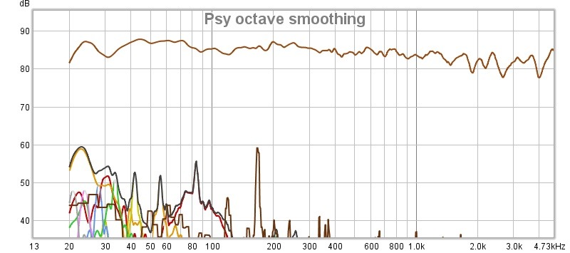

For what reason did you want to see distortion?Mind to show some distortion graphs? Would be interesting to see.
I would like to see if the concept can produce low distortion. I think it is desirable with low distorsion for a faithful reproduction.
I believe it can based on the writings of Tom Danley and my own experiments. However Danley does do more with higher levels such as outdoor products. I thought we were past looking at distortion as being important with speakers that are otherwise well designed.

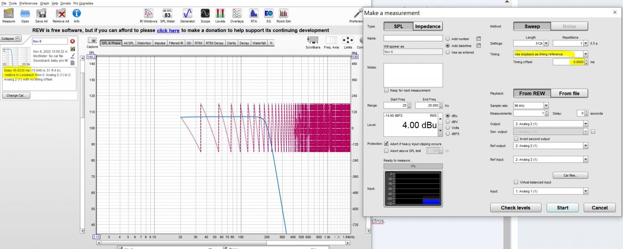

All that said, I'll still offer a method to nail timing down, that i think is both more accurate and easier, than using group delay and/or spectrographs.
Again, it's the simple use of ToF measurements (best on drivers that are first individually tuned.)
It doesn't depend on FIR or dual channel measurements.
It does need at least REW, and a USB soundcard with loopback, and a non-UMIK mic. (UMC202HD and ECM8000 will do, for a total of $105 .)
Simply measure each driver (or driver sections) one at a time, from a fixed point in space, and compare their Delays relative to loopback on their measurement tabs. These are their individual ToF's to a point in space (which include any fixed delays like processor latency etc)
The differences in those 'Delay vs loopback' times, are dang close to being the exactly needed delays. (Certain little tricks can make them exact.)
On a syn, the lowest driver section (LF) will measure the greatest delay vs loopback (furthest from mic).
The mid driver section (MF) the next. And the CD the least time. So mid delay = LF-MF, and CD delay = LF-CD
Make sure Timing offset is set to zero as shown for all sections, and make sure all non-tested section are either shorted (or connected to an amp.)
Oh, and it must be relative to loopback, and not acoustic reference which depends on a 5-20kHz chirp. Chirp is too high to work, and becomes the reason UMIKs don't work, and a soundcard is needed.
Like said, the process gives delay settings far more accurate, and than looking at group delay or spectros, ime/imo.
And again, it's independent of using FIR or steep xovers.
I use both of those because they simply measure better, and are much easier to implement than low-order xovers, no matter whether low order is IIR or linear phase FIR.

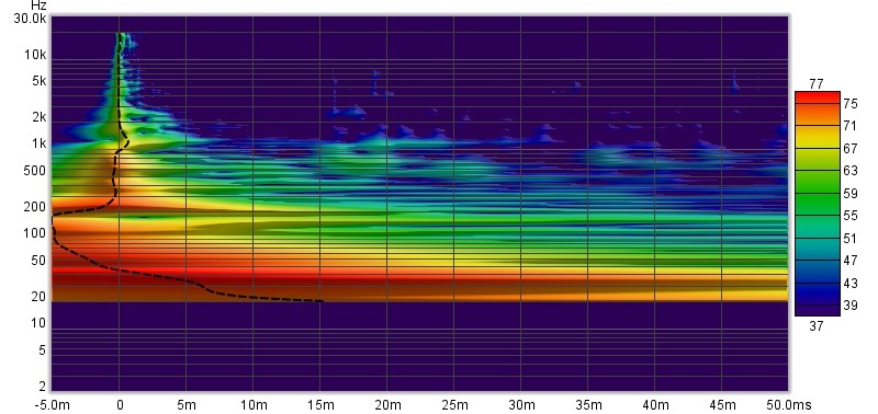

Here's a tuning made two days ago on a 4-way syn on top of a bass-reflex sub.
The synergy needed 2.4ms delay relative to sub.
The syn's delays are: Low 0ms, Mid 0.2ms, CD HF section 0.68ms, and CD VHF section 0.76ms.
Hey, at least such exact tuning produces a pretty spectro ! And was easy-peasy to do !!
Zooming to properly see a problem is what should be done... but mandatory 50dB, is that a standard? I do it in a way that's situationally dependent.please use the "mandatory" 50dB p-p scale.
Happy Monday everyone! I had a very productive weekend with the big horns. As Chris predicted, I had my woofer polarity reversed. Once I fixed that and EQ'ed everything again, I got some good results. I was also able to improve my driver time alignment considerably. I'm not sure I have it perfect, but it is close, I think. Anyway, here is a FR and phase graph:
I tried to get three different distortion measurements, at progressively louder volume. I discovered something interesting. It seems my woofers are not keeping up as the volume increases. I'm not sure what to make of that. Maybe I am simply running out of power? I have a 150wpc rated amp on the bass drivers, which I would think is plenty, but maybe not? Or perhaps it is a gain structure issue of some kind? Everything seems to scale normally at sane volume levels,it only happens when it gets pretty loud. Any ideas?
85dB distortion:
85dB distortion:
