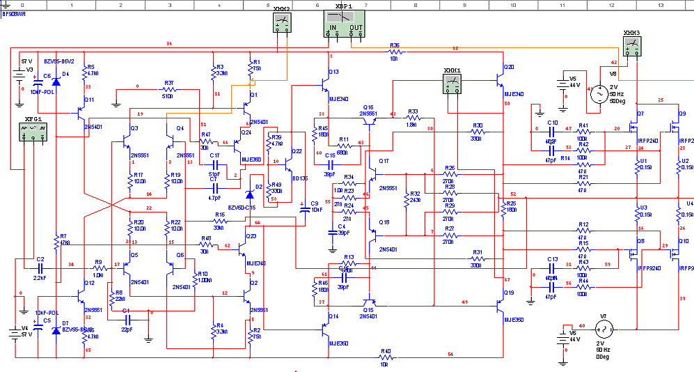

I also think it might be something like that. I have checked everything thorougly to rule out any silly connections I might have done, but ut looks ok. As soon as I get some spare time I will try removing my cascoded VAS and run the simpler version I know is very stable just to see if this helps the HEC. It could very well be a parasitic causing all this. (really hope so!)
By the way, how did you calculate the 270 ohm and 330 ohm resistors in your original schematics?
Rgs Rikard
Hi Rikard,
Can you post a schematic of your HEC design. Maybe something will pop out.
Bob
Certainly, thanks for asking! But please disregard the messy schematics as I haven´t finished the design. The EC is a pure "Cordell rip" and the rest is just my ideas. 🙂
By the way, Q23 and Q24 are FETs in the prototype, IRF620 and IRF9620, but I tried simulating BJTs instead and it seems ok. So I´ll replace the FETs in the prototype and see if it helps. I could also try increasing the gate resistors in the OPS just to see if any oscillation might stop.

Well, the schematics isn´t really that fantastic, it looks much more complicated than it is. But once I´ve got things working properly I can always post a cleaned up schematic.
By the way, don´t hesitate using MOSFETs, they are really not that hard to work with most of the time. I found the 2SJ201/2SK1530 easier to work with as they are more temperature stable and probably not as prown to parasitics as the IRFP-types. it´s a pity they are harder to use in the EC circuit due to their low Vgs. Also, I really like the way they sound, but that´s more a question about circuit topology than the FETs themselves I think. Get rid of the odd overtones and your amp will sound better! 🙂

I seem to have stability problem just as mentioned above! Question is, how do I best get rid of it. It seems to be outside the EC stage actually, so I figure I´ll have to try a few method with freq compensation. At the same time I don´t want to loose too much slew rate. Perhaps I shoud continue this in my other amp thread
http://www.diyaudio.com/forums/showthread.php?s=&threadid=127886&highlight=
I tried small caps from the VAS output to the base of the VAS inputs, and it sims ok but I loose quite a lot of speed.
Rikard Nilsson said:I seem to have stability problem just as mentioned above! Question is, how do I best get rid of it. It seems to be outside the EC stage actually, so I figure I´ll have to try a few method with freq compensation. At the same time I don´t want to loose too much slew rate. Perhaps I shoud continue this in my other amp thread
Hi Rikard,
With respect to stability of an EC amp design, I usually recommend two phases of investigation. First, make sure the basic amplifier has good stability with good margins without the EC in effect. The EC can be disabled by opening the resistor where one normally puts the EC error null pot in the circuit leading to the junction of the differencing amplifier emitter resistors.
Only after the underlying basic amplifier is well-behaved and characterized, enable the EC and look at stability again.
Bob

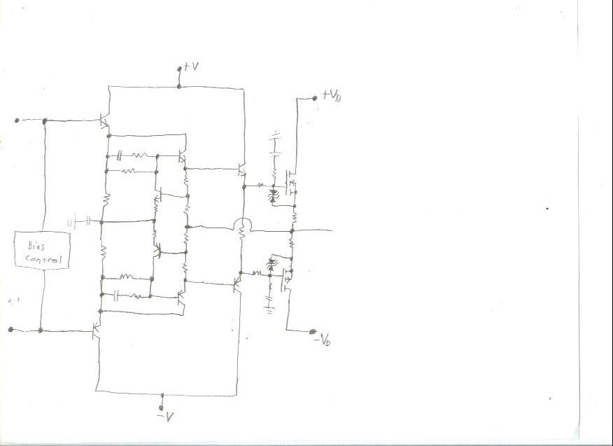

I have a question that may have been discussed in another watered down thread, but what would be the difference in taking the feedback to the EC emitter reference from the first pre-drivers instead of the last set of drivers? It seems to me you would want to compare the input of the circuit to the output of the circuit, instead just the gate drive to the output, and you would still have the positive feedback node. The only bad thing I see is you would be adding the phase shifts of the second pre-driver and driver to the feedback loop. Assuming these are very fast transistors, how much would the adverse affect on bandwidth be, IYO, and would it be worth it to include the errors of the drivers in with those of the outputs?
Just a thought...........or a mental movement.
Hi
Hi C.K,
Good point. This topic has been discussed a year or so ago. Regrettably, I couldn't find where and when exactly. But I do know that if the FB is taken from the emitters of the last drivers, you will get slightly less distortion.
Edmond.
Edmond.
Hmmm
I haven't actually performed an A-B test on measured distortion, but I can see a reduction in bandwidth being caused by the extra FB delay as a measure to increase distortion since it is bandwidth and not gain your looking for in this circuit, at least as it seems to me.🙂

Hi Chris,
I haven't actually performed an A-B test (in real life) either, only a quick sim.
It seems that you are worrying about the speed of the FB loop, right?
As Jan Didden has found out (see: http://www.diyaudio.com/forums/showthread.php?postid=1720508#post1720508) there exists an optimum when the BW of OPS proper and the BW of the FB/correction loop are equal. Since normally the BW of the OPS is the limiting factor (caused by gate resistors and gate capacitance), I don't think that the speed of the correction loop is a real issue. IOW, little is gained by using an ultra high speed driver.
Last but not least, I'm not an expert on HEC. As you probably know already, I rather prefer a GNF OPS.
Edmond.
