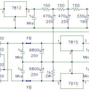

Got all the parts and started building this evening. I'm starting with the power supply and have a rarther newbie question about the pin layout of the voltage regulators. How should I read them? For example look at the 7812. Does the left dot (marked '1') on the picture correspond to the left pin on the IC? Of does it correspond to the 'input' of the IC? And how is that on the 7915, that has a different pin layout than the 78xx IC's.
Thanks very much, Ralph

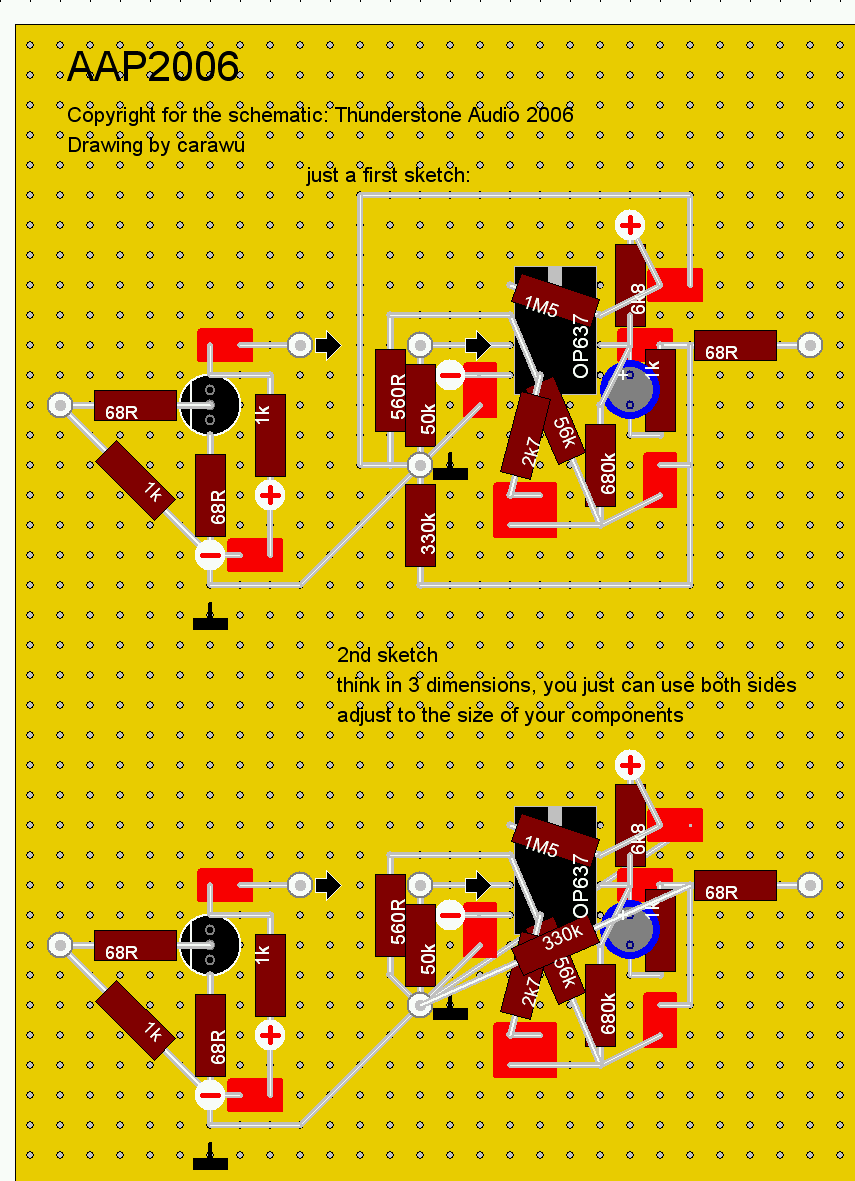

Hi Carsten,
can you repost your picture?
