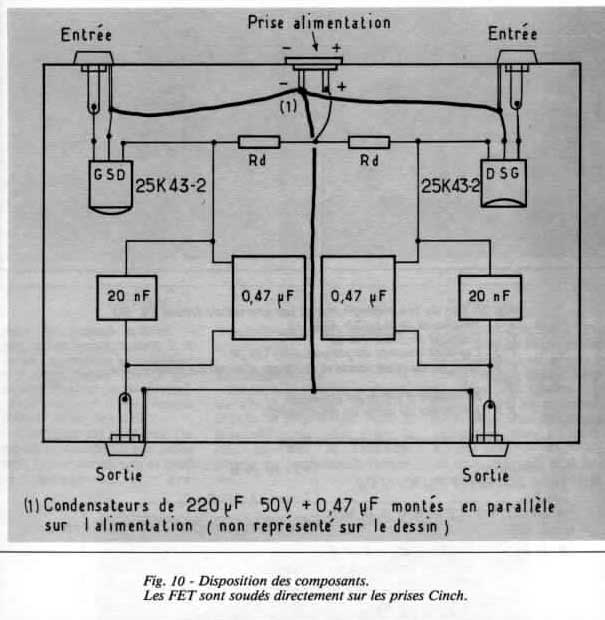

Kuei Yang Wang said:Konnichiwa,
As for planting the J-Fet's little feet, the traditional solution is to solder it to the RCA Socket and run two wires from there to the main assembly ....
Sayonara
you "lifted the kimona" to reveal a neat solution
A little drawing for the less experienced solder artists to give you an idea of how to build this little gem.
Enjoy,
Carsten
