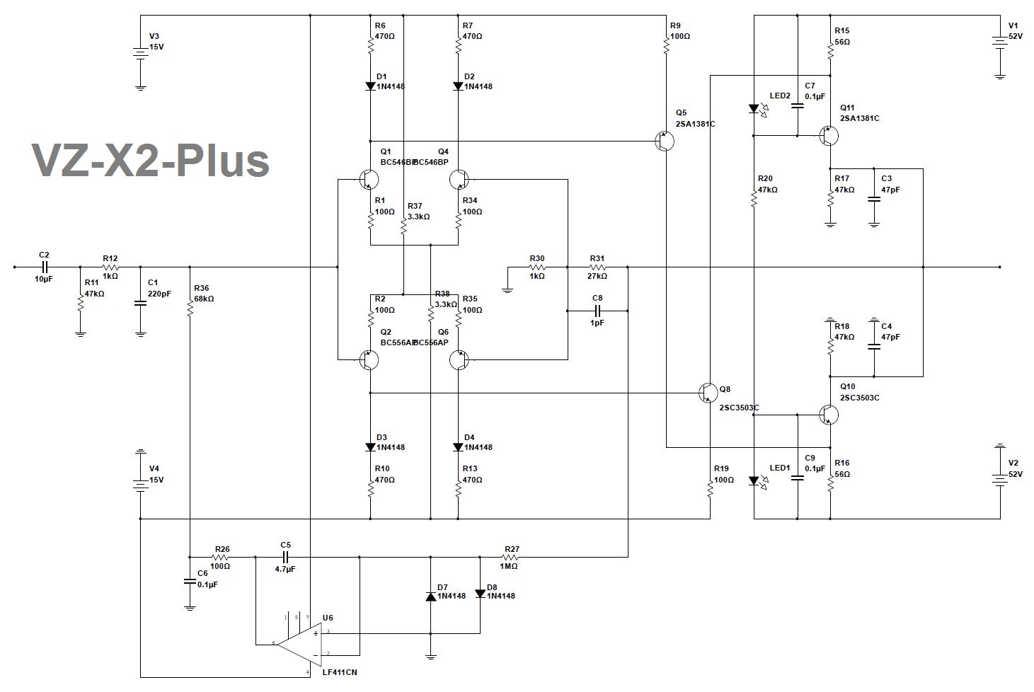

Hi googlyone, interesting.
See my live measurements in combination with rather low-distortion OPS.
The level is much lower than the one you have just mentioned.
What I'm thinking - this front-end design is relatively low OLG.
As a result, having the amp gain 29db, the loop gain is only 35db - it's deliberately low, that's one of my design principle at this time.
If two amps with virtually the same front-end are showing so different distortion levels, than maybe the reason in the OPS distortion levels difference?
It would be interesting if you can measure the front-end standalone, with no OPS...

I must say, to my untrained eyes, that the front end as drawn/built by Googlyone looks a bit different (more complex with additional parts) from the one by vzaichenko. Perhaps there are subtle differences? Most having to do with fact it was a mod from original circuit to take advantage of current drive approach.

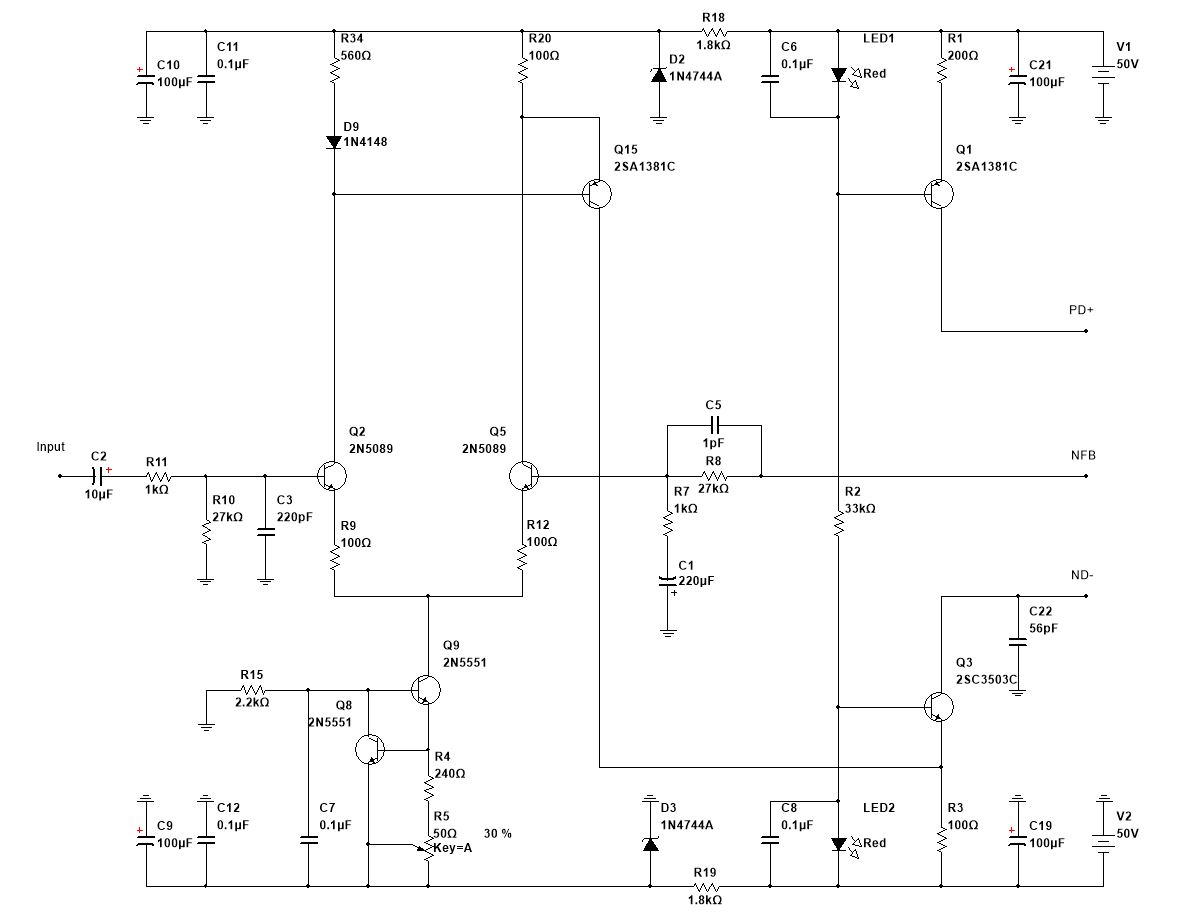

- The current required through N22 from post 40 at zero output needs to pull current through R30 to drive the VAS to zero output.
-> The current is a function of both the upper and lower constant current sources
-> And the resistances R3 and R4
-> And the differential pair CCS
A few percent error in matching of the current through the two sides of the differential pair (say 1% of 3mA) divided by the HFE, say 200, results in a base current difference of +/- 1.5E-7 Amps. Sounds small.
But the resistance seen from the base is 47k. but this results in a +/-7mV error in base voltages. Adds up quickly.
Without fine tuning, and because the differential pair does not use any current mirror, the error is a lot more than 1%. (I saw 200mV when I first turned the thing on!)
but that is really a side point - I think there are ways to get much better balance than tweaking resistors. Which I hate. I just want to get that distortion under control first!
To start this I will do three tests:
- hack one of the current mode boards back to a blameless type. The intent here being to demonstrate that shifting the VAS of this board and these parts back to a blameless type gets rid of the distortion.
-> If not, then I can hunt down and fix the gremlin
-> If it does, then I have learned something.
- Start putting it back together again into current mode - and see where things go flaky.
- Look at something, even if more complex, that is less likely to require the differential pair to throw itself out of balance - as after a glass of red, I am wondering if the drive into N22 itself is not unbalancing the differential pair enough to cause the distortion I am seeing.

For the best performance, you need to mane the collector current of N3 (as well as P7) equal to collector current of N22.
You can balance the LTP, using a trim pot in series with R11.

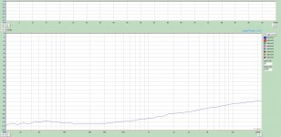

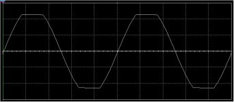

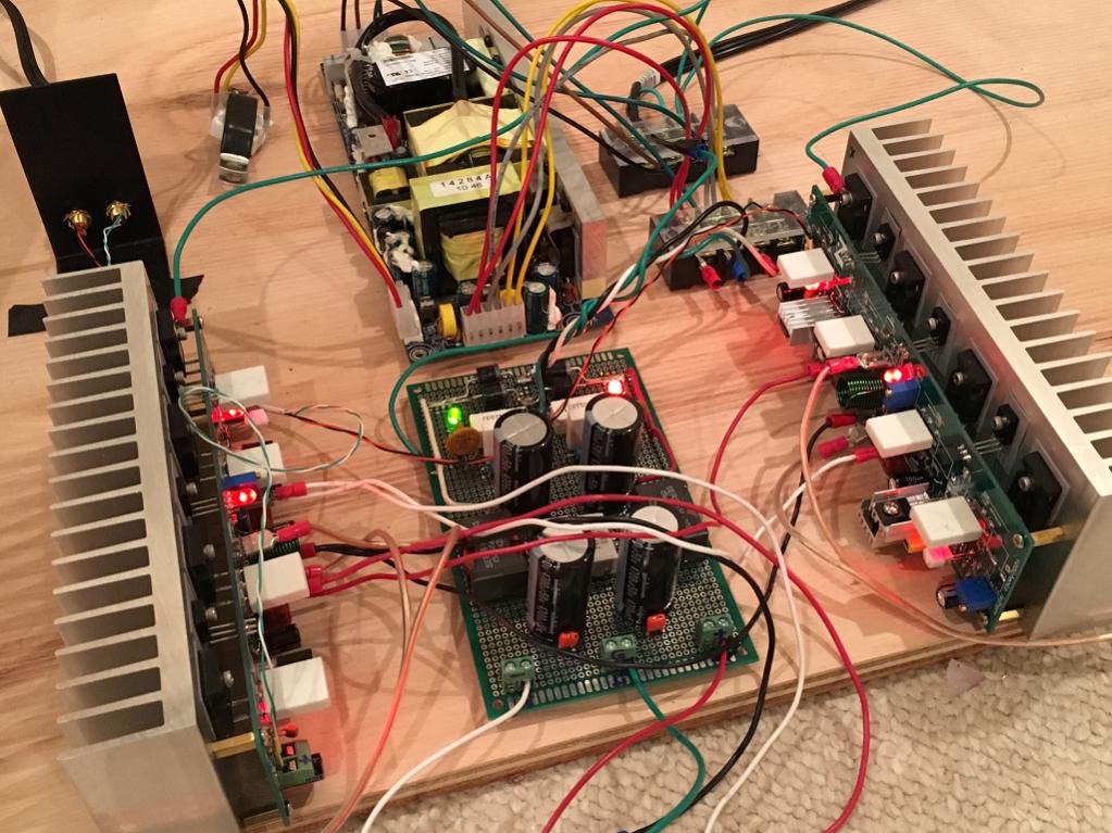

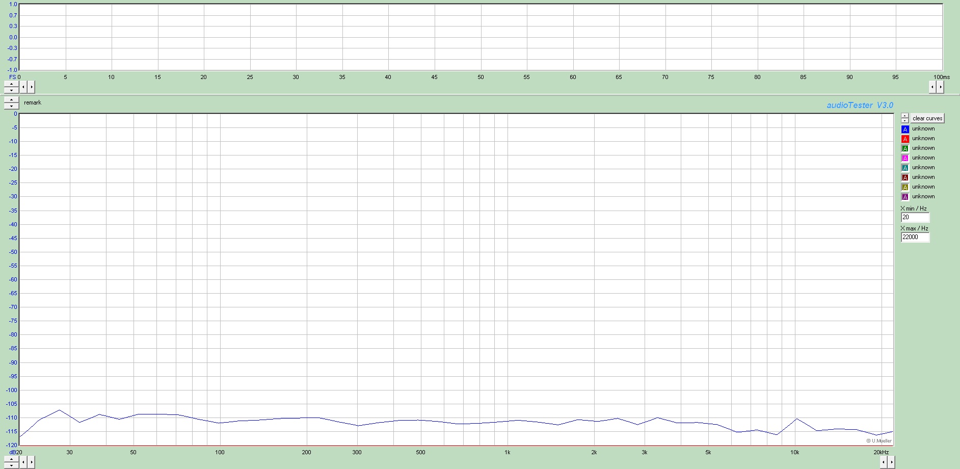

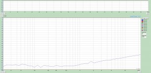

I managed to take the poorly performing current-driven-VAS amplifier and do "VAS surgery" on it, converting it back to a blameless architecture. Essentially identical to the initial amplifier.
The performance with no load and an 8R at about 3dB below clipping load is shown blow - noye this is the SAME board hacked back to blameless as pictured above:
Quite evidently everything on the board is working just fine - and it is absolutely an issue in the VAS drive that is at issue here.
Conclusions:
- OK the initial implementation was not finely tuned on the VAS drive / VAS currents.
- The initial Current Drive VAS version was reasonably balanced on the input differential pair.
- The simple one transistor implementation is probably not the sort of thing you would want to make without planning for a bunch of tuning. Indeed, I still don't know why the distortion was so utterly rubbish.
- I do need to go back and make the current drive work - even if just from curiosity.
- I do want to come up with an implementation that is no so dependent on tuning, twiddling pots etc - they are rubbish for production / repeatability.

- I am potty. OK, I was watching football with the wife while loading all those resistors and transistors, but damn... there are TOO many of them!!!
