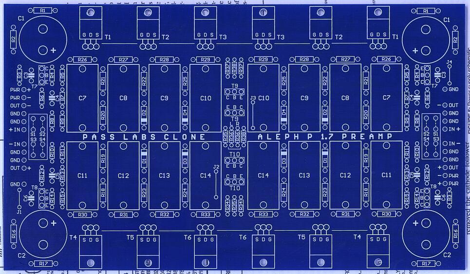

Hi Chris,
And what do you think about to build an Aleph 1.7?
Gyuri

Hi Chris,
Gyuri
Hi Gyuri,
That looks interesting. I'd be interested to read an article describing the details of how it works; do you know of one? I guess at least in part the idea is that the source resistors of the Balanced Zen schematic have been replaced by constant-current sources? Since it is quite an involved modification of what I already have, I probably won't rush to make the change, unless there seems to be a compelling reason to do so.
A much simpler experiment I may try first is just to replace one of the two 750 ohm source resistors in each half of the Balanced Zen linestage by a constant-current source. (Retaining the other 750 ohm in each leg so that the voltage drop across the CCS won't be too high. Then I can use an LM317 for the job.) This actually sims quite well in LTSpice, gives a well-balanced output even from a single-ended unbalanced input, and does a much better job of maintaining precise 180 phase angle between outputs than is the case for the original Balanced Zen with drain resistors optimised for balanced output.
I'll probably try that as a simple mod first, and then I'll experiment with op amps instead, for unbalanced to balanced conversion.
Chris
Hi Chris,
There you can find all of the necessary information:
PASS LABS CLONE - ALEPH P 1.7 DIY Preamplifier PCB layout

Thanks; it is quite useful, though I'd still like to see a more technical discussion.
