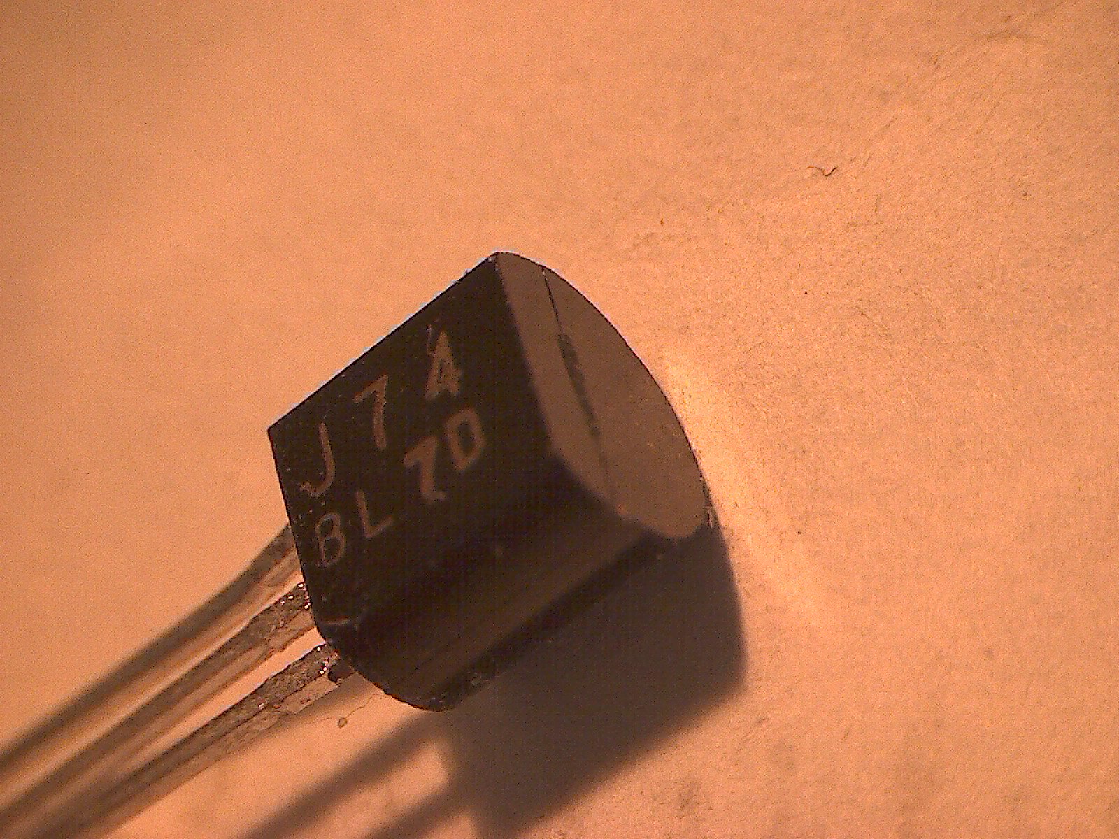

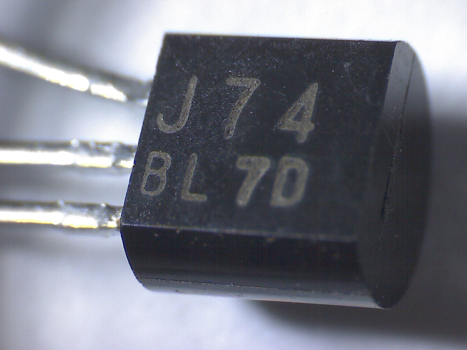

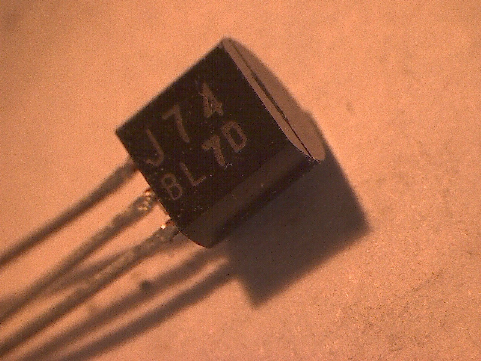

If you post a clear picture of the topside and the front-text-side of the JFETs, I think I can tell you if they are the real thing or fakes.

Chris, you have said, you have bought ten in a batch.
Can you take some close photo from remaining ones?

Here are a couple of shots of one of the others from the batch of 10 that I bought back when I was building the circlotron. The ones in the circlotron are the same as this one.
Edit: Just added a third pic with better lighting.
Chris
Three questions:
Can you measure thickness between rounded and flat surfaces with a vernier caliper?
Can you easily remove labeling with some solvent? (eg. alcohol)
Is it painted, or etchwork?
I don't like that letters.
Especially last two characters was suspicious to me, these are the cycle numbers.
Yet, I think these are genuines.
All of the genuine Toshiba ones (2SK170/2J74) I have, have a diameter almost exactly 3.9mm.
All of the fakes smaller in diameter, between 3.3-3.6mm.

I don't have calipers. The best I can do just with a ruler is 4mm, maybe +/- 0.2mm.
The letters are etched (can be seen clearly in the third pic I posted).
Chris
Well, I think, these are really genuines.
