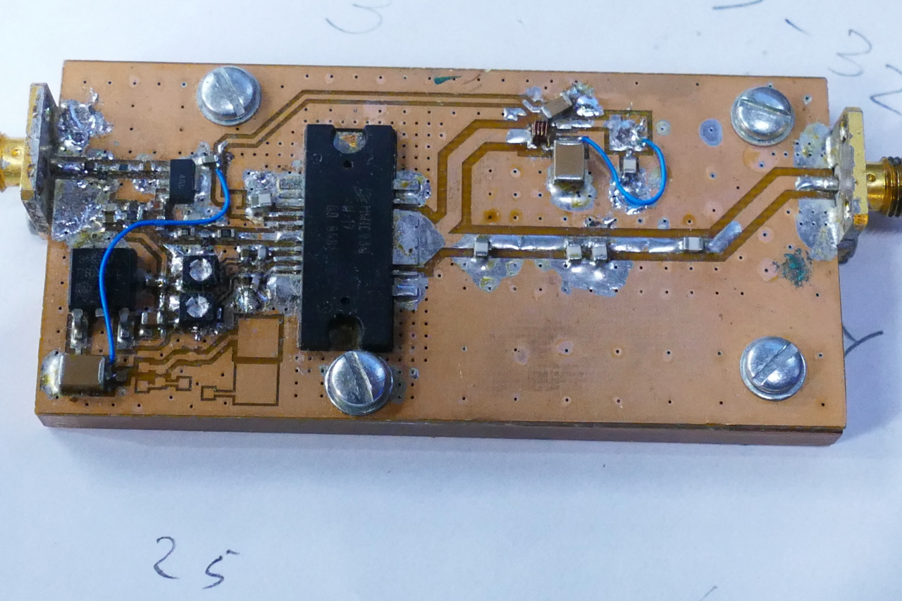

George, that last your version of IR? I do a lot of SMD stuff, but not enough to justify investing in a pick & place machine (they're comparatively cheap now) and my employer offered me a compact IR oven so I would no longer have to hand solder, but I have no space for it and it needs to be well ventilated or outside in use. I also try to stick to 0805, 1206, 1210, 1812, and 2512 packages for passives and can handle any SOIC, SSOP, TSSOP, SOT-23, and SOT-223, etc. The bigger semiconductor packages are pretty easy as long as you preheat the board.

I don't do enough SMD for even the usual hacked toaster oven.
I did buy a hot air reflow tool from the MicroCenter on a trip to Cleveland last year, and it works good for small areas.
I was doing a lot of prototype RF design and assembly work at Motorola with some large SMD RF power parts. In many cases we would solder the back side of the board to a copper heat spreader which has a pedestal that protrudes through the BC board and then solder the RF device to both. Here is an example. This is a 20 watt RF power amp that is tuned to the 902 - 928 MHz ham band.
The PCB is screwed to the heat sink. Then solder paste is placed on all the pads with a syringe. All the parts including the large RF device are placed in the solder. Then we fire up an industrial hot plate to about 270C (real lead solder). The board was placed in an old frying pan, which is then placed on the hot plate until all the SMD stuff reflows. The pan is then moved to a big heat sink to cool.
After stinking up the place with an overheated Teflon frying pan a couple times, the boss got a mechanical engineer to draw up the plans for a custom "frying pan", and we got the machine shop to make it. The name frying pan SMD stuck though.
Here at home, my heat source is a "Aroma" single burner cooking hot plate from Amazon, and my frying pan is a 7 or 8 inch square of 1/8 inch aluminum clamped in a pair of vice grips. I do the rest pretty much the same way.
