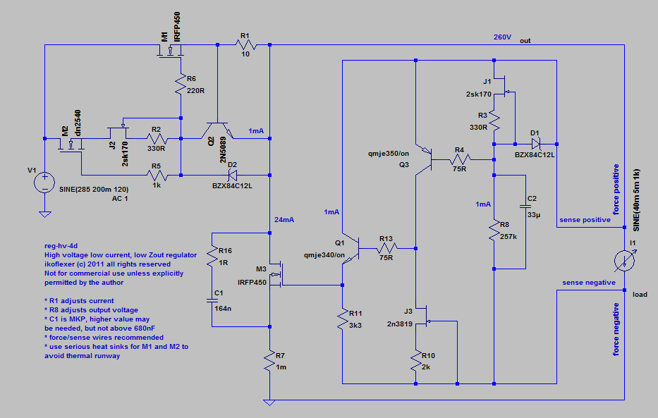

Just want to clarify that what I posted earlier is NOT Rod's design. As far as I know his schematics are not in the open domain. My circuit uses a cap multiplier, not a gyrator, and a CCS. Just sayin'! 🙂

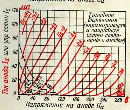

The supply voltage in my design was carefully considered. Just like you, my first thought was that it won't work so low. But 70V is fine for a 4P1L cathode follower. Please look at the curves - the anode current is almost constant in this design (thanks to the FET), so you can get away with only 3.5-4V of bias, without problems. The 4P1L only operates in a tiny curve around the operating point, so high voltage is not needed at all.
This is completely different from the usual common-cathode circuit, where higher voltage will be needed.
Other trafo makers can match Sowter quality, but none of them are willing to make the customised trafo we need. Sowter's catalogue is full of curious designs - some of which no doubt stem from this kind of project.

I guess I don't see the need, the input tube will would not be powered by the SSHV because it would have a CCS or gyrator. If we use a negative supply for the input tube to enable a dc couple then we need to add a coupling cap at the input, so no benefit.
I think what I posted a few pages back makes the most sense and has no practically no caps in the signal path. I'll add detail to it and attach the asc file this weekend.
