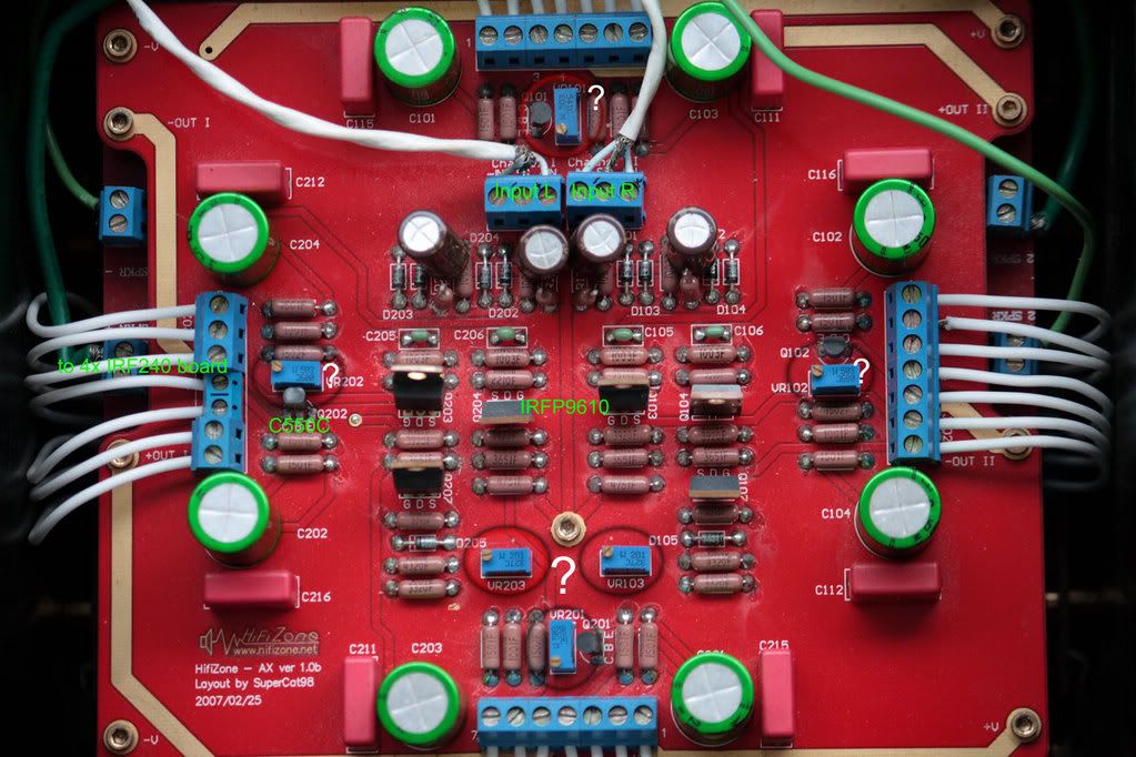

hello,
i have some problems with my alephX..
it clipped so bad / distort (i dont know what to call it in english lol) when i raise the volume into a little below or normal listening level..
that problems seems dont appear on very little volume..
btw, i use cayin CDT15A > Tandberg Preamp 4038>aleph X > diy proac 2.5
tried using 10K and 50K volume attenuator but its the same, so i guess problem is in my amp..
i will be gratefull if someone could told me what to do..
i attach some picture
i think it using karis pcb.. i
t use 8xIRP240/channel and +/- 22V supplies
and... anyone can enligthen me what this pot use for?
thanks

Ducky,
you've got a stereo Al-X board, the pot in each of the quadrants is for biasing the quiescent current and to zero in on relative DC.
Why not begin to read at the very start of this thread, instead of asking others to DIY a power amp you did not DIY yourself ?
That is to adjust the offset.
I think your offset is up way to high and this voltage is subtracted from the amplifer voltage swing.
Just measure the output to ground and you will see a large voltage at turn on that will drift downward and go negative (as I recall).
When at working temperature aim for a voltage of not more than 2 volts +-

Its astereo pcb so you have the 6 irf9610 and 6 vertical trimmers for bias and offset.
