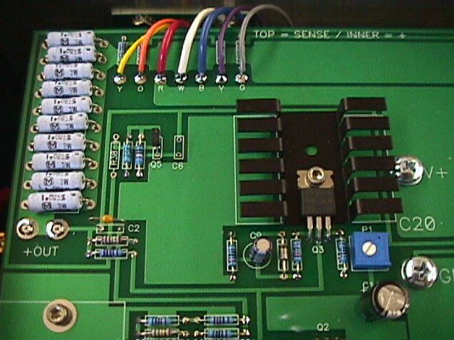

Hi!
A friend of me is interested to build the XA200 amp and he would like to know:
- what kind of brand are the small (0.25-0.5W) resistors in the amp?
-what kind of type and brand are the Zenners?
Thanks and greets:
Tyimo
For what it's worth, I generally use the Motorola/On Semi Zeners, which is to say that I tend to buy parts that I know I'll use more than one or two of in lots of 100 to catch the price break--and haven't used the Motorolas up yet.
I like Motorola, but have severe reservations about dealing with Newark Electronics, the supplier I used to order the parts from. I never, not once, had an order that went smoothly. Now that Digikey seems to be getting into On Semi, I may just order from them.
Mouser is a great source for the Vishay/Dale parts as long as they have the value you are looking for.
Grey
EDIT: I usually get the 1/2W resistors (RN65) so as to have more options as to where to place them in circuits. It keeps me from having to stock the same value resistor in more than one wattage. Pass Labs can afford the luxury, but I don't make any money at this so I spring for the extra two or three cents/ea. so as to be able to use them in tubes circuits or solid state or whatever. That said, the 1/8W parts are plenty for the signal level resistors in the Aleph-X. Go for it.
