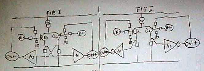

I can't attach my file which was repaired.The right hand of R16 will connect with pin G of Q7 and the left hand of R27 connect will connect with pin G of Q5. Can anyone understand me?
fig 1 use negative feedback and fig 2 use positive

Its very hard to get the same current in the differential halves. Inserting 10 ohm before the 390ohm will tell you. Putting current mirror makes the amp doesnt work. The only solution--->match the differential. Is there any other "trick" to make sure both legs of differential have exactly the same current?
If not, how much imbalance is tolerable?
Current mirrors were invented to seduce people into unwise paths. They certainly aren't going to be of much help in this circuit, especially given that the bias for the output stage will be unpredictable. (Not to mention the fact that they'd ruin the sound of the amp.)
The notion that the current in both sides of the differential must match down to some zillionth of a percent is false--probably PR put forth by the Pro-Current-Mirror tribe. All you need is a matched pair of MOSFETs for the front end and a small screwdriver to turn the adjustment pot for the front end differential.
Note that the two pots I put into the Aleph current sources aren't necessary--I just put them there to have something to fiddle with. After all, a man's got to have something to obsess over...right? I doubt seriously that Nelson has Aleph current source pots in the real XA amps.
One of the alternatives I explored when I was running up the prototype was the idea of using a fixed front end current source, but having the two loads for the differential be adjustable. It works just fine, and you're welcome to try it if you want, but I'd rather adjust one pot than two.
The resistors that Ian suggested certainly help. They lower the value, the less the DC offset, but there's a catch to going too low in that you're trying to match one point in the circuit at ground potential with another one that's about +4V.
The only real alternative is a servo.
Just set the absolute offset to something close to zero and relax, don't worry, have a homebrew...

Certainly using two current sources would give you control over the amount of current through each side of the differential, but as you noted, you'd then be forced to separate the sides with a resistor.
You could achieve somewhat the same effect by using one current source feeding the wiper on a pot with each end of the pot going to one MOSFET's Source. However, then you'd get into degeneration (unequal, at that...ugh). That might suit some people, actually--the degeneration, I mean. Lower distortion and all that.

Hi, Grey,
I read here somewhere, that if we use Resistor instead of CCS for feeding differential, it is not good for low voltage. 15V is quite low. What happens if we dont use CCS for this +/-15V AlephX, instead we put 1 resistor that gives 20mA (560ohm) to fed the diff. Is it bad to have this low valued resistor instead of CCS for low voltages? The whole amp will not operate as good as we put CCS instead?
Which is the final schematic drawing up to now? (That everybody agrees). First it is your sch. Then comes up sch with "Magic Resistor".
I still think mainly it is because the difficulty of sharing exact current to both legs. These amp needs exact current sharing, because it uses Folded cascode, the AC current flowing in each leg = the current driving the final stage. If we want both sides operating the same condition, then current sharing in differential becomes important.I believe you'll find that the earlier X models (600 and 1000) used two current sources for power dissipation reasons as much as anything else.
I agree that this current sharing becomes less important, if we talk about AlephX, or 3 stages power amp, because the current in each differential leg is only driving a voltage-drop resistor (for driving the next stage). Remember, that the smaller X amp uses 3 stages, with small Jfet as differential.Nelson has said elsewhere that he had to 'learn' about X as he went along. In the beginning, he used a resistor between the two halves of the differential, but it's certainly not necessary to do so. Nor is it necessary to use two current sources
This is my question, Grey. The AlephX operates on +/-15V rail. The differential is fed with about 20mA CCS....nor even a current source at all.
