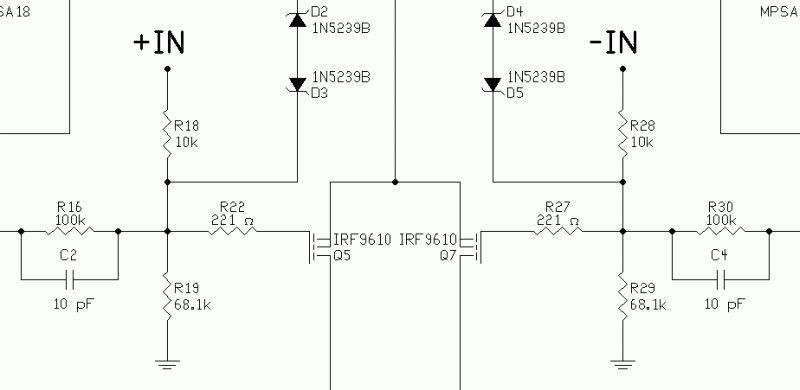

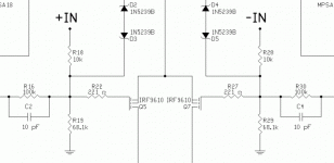

0 gain means 0 output
0dB gain means gain=1; and here, the output voltage is equal to the input voltage
in this case, yes, you just control the current woth the aleph x
Gain(dB)=20*log10(Vout/Vin)
here, Vout/Vin=Rfeedback/Rin
so
Gain(dB)=20*log10(Rfeedback/Rin)
edit: just add "-" if you want, since the AX is an inverting amp
Fritz said:
Now I just have to figure out the schematic well enough to recognize which are input and feedback resistors in the various stages. zero gain, that means your just controlling current with the thing?
Zero gain means no output at all.

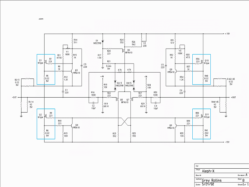

If someone will post a schematic to which I can reference, I will be happy to point out the resistors in question.

A small size of the schematic by Grey Rollins at post#1 revisited

Thanks for posting this Steffano.
I would be trying to adjust this to 27dB gain. I see R18 and then its mostly Greek to me.
When one starts changing gain does evrything else like stability change?
