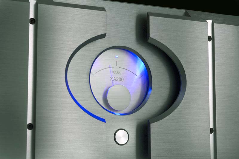

nar said:When I power up the amp I have no turn-on thump at all !!!Offset is 42mV differential and stays still.The input differential 9610 are thermally linked.The parts are matched but not hyper-matched like Petter does. When powering down,I can see a slight turn off thump,but on my multimeter it doesn't go higher than 120mV and vanishes quickly.
Does that mean that no output relay for the amp is required ?
Product XA's do not require a relay either and have minimal thump. Interestingly, if the output stage of one side fails, the other side will track any DC as common mode, so it's very difficult to damage a speaker this way. Of course we haven't sent enough XA's into the field to see a failure as yet.
