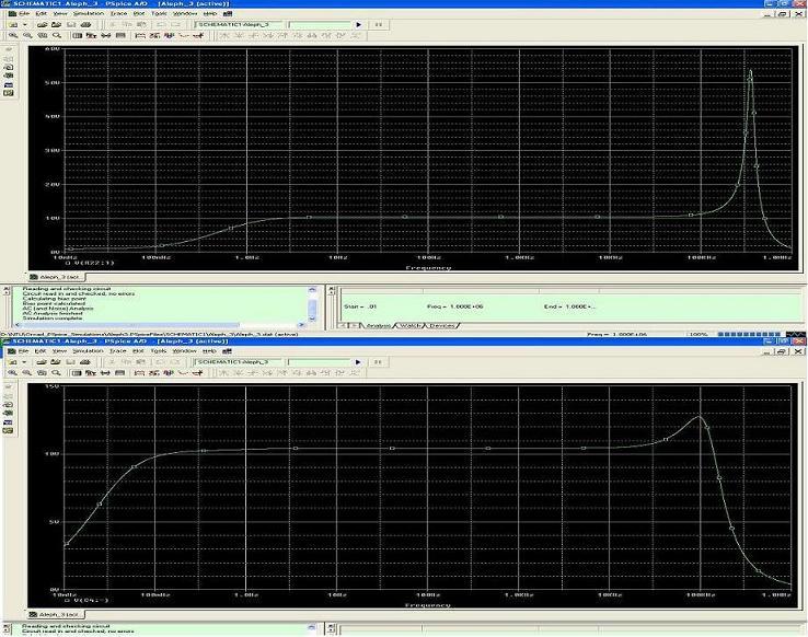

Thanks, wuffwaff, according to the user manual, the NFB has been decreased, but I can see that there is not much decrease in negative feedback 0.1 to 0.091?
Is my thought of dynamic feedback correct?
I will think further about your point about current limiter fr output. I'm running spice simulation and I hope i can visualize this point there.
Thank you.
Without looking back at the earlier circuits, IIRC the A-J has less open loop gain than the earlier Aleph versions. The feedback resistors which set the final 'system' gain (i.e. closed loop gain) are in approx. the same ratio, but as there is less open loop gain in the first place, there will of course be less negative feedback, just as described in the manual.
I don't understand your points about dynamic feedback, but if you look at Nelson's site and read the articles on "Zen Variations", I think that this will help you to understand this circuit.
Hi Bodken,
Since there are bypass capacitor (C5, which is 5pF in the schematic) parallel to the feedback resistor (R4), and there is one more capacitor, C1 in series with R3, this contribute to dynamic change in feedback value, especially at high frequency. For very high frequency, C5 is shorted, and all the signals passed thorough this capacitor without passing through the R4, hence, all the output signal are feedbacked to the input. I'm wondering why Mr. Pass design such 100% feedback circuit for high frequency signals.
From simulation, I can see that the bode plot of A-3 has a spike at high frequency (30k~300k). I'm wondering Mr. Nelson purposely have 100% feedback at high frequency to eliminate such spike in order to fully emulate tube amplifier as we know that the output transformer's impedance increase linearly with the log of frequency, which will cancle high freqnuency components 🙂.
Thanks for your explanation about the NFB. But I don quite agree that the decrease in open loop gain will reduce negative feedback, there are different. Let G be the open loop gain, and H be the feedback gain, then the transfer function of this closed-loop system can be written as Tf=G/(1+GH). If G is large, then Tf ~= 1/H, which is 10 for A-3.

C5 is merely to ensure HF stability, and some people apparently find this is unnecessary in certain Aleph circuits. It will affect the square wave response at HF, and using C5 should help to prevent any unwanted ringing.
The precise value ideally needs to be determined by 'scope measurement when the circuit is constructed, as the chosen layout etc. will probably affect this area.
I don't have details of all of these amps to hand, which is why I said "IIRC", but I think that Nelson was referring to there being less negative feedback than with his previous designs when he said that the negative feedback had been reduced.
Therefore (and if I am right here) if there is less open loop gain but the same system gain after application of negative feedback, the actual amount NFB will be less. I don't have time to look into this fully right now, but this is what I recall from memory.

please see my simulation for Aleph 3 with and without dynamic feedback. The first figure shows the bode plot of A3 with fix feedback, and the 2nd figure shows the bode plot of A3 with dynamic feedback.
Please comment 🙂

Bobken said:
When Nelson commented that in this A-J he had reduced the feedback, I was initially puzzled on seeing that the feedback resistor values were in the same ratio.
Yes, the JFETs have lower transconductance, and so the open
loop gain is proportionately lower. The gain, set by the feedback
resistors, is essentially the same, but there is less feedback.
As the JFETs are more linear, the increase in distortion is less than
the reduction in feedback.
Thank you Mr. Nelson for clarify my doubt. Could you please explain the main reason of adding C5 across R4 which forms a low-pass filter for high frequency signals? From Spice simulation, I observe that the cut-off frequency is about 30kHz.
Is this added to emulate the effect of output transformer in tube amplifier design?
Thank you 🙂
radule said:
1/(2 x Pi x R4 x C5)=144KHz
I think that R1 and Ciss of a 2SJ109 are more important
for cut-off, it should be somewhere around 70-80KHz.
Similar number are in OM for Aleph J.....

You are right. Since 144kHz is far beyond 80kHz, there must have some significant meaning why Mr. Nelson choose to include this low pass filter 🙂.
If you lump R4, C5, R3, and C1 together, it is in fact a band-pass filter 🙂.
