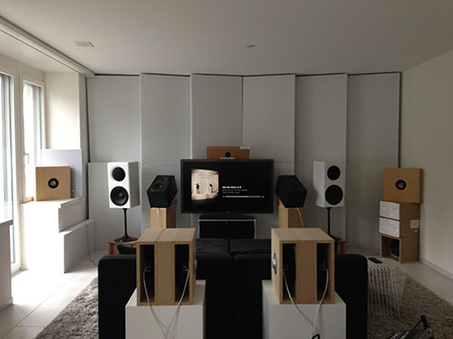

Phantom source elevation? That's what I get. I found side reflections more important for spaciousness.
The tilted Behringers in the following configuration project center sources at about 2/3 of the wall height. Percussive sounds even higher. The toed-out Nathan's work much better.
