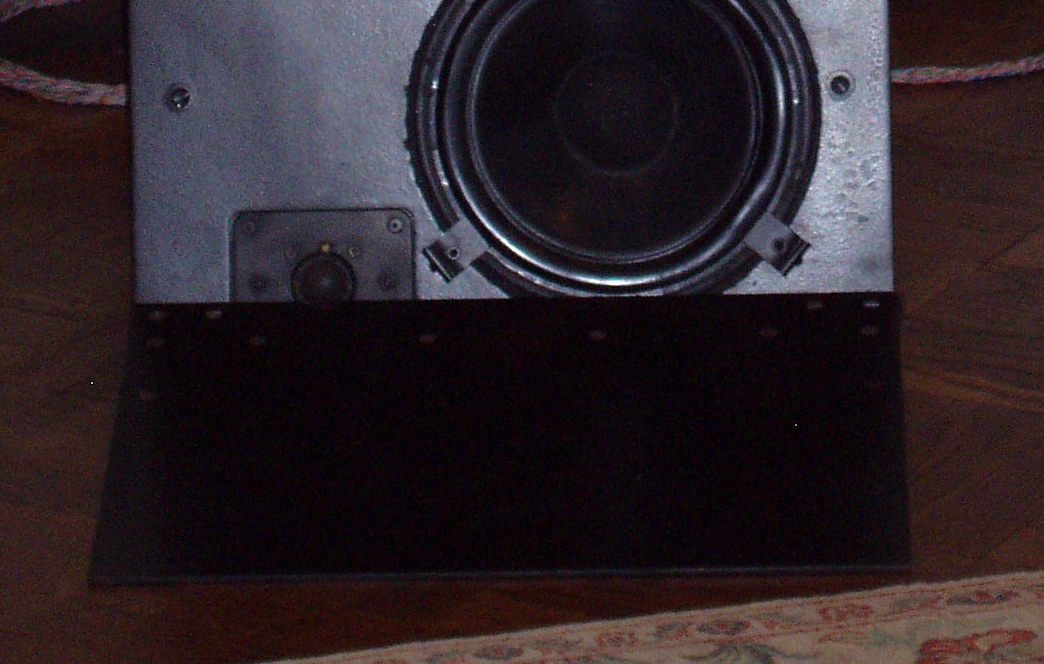

it is different - take a closer look at the photos
You cannot see?
Why don't You ask diyaudio users who owned it? Read this: http://www.diyaudio.com/forums/multi-way/136887-snell-type-1s.html

What should I see ? Give me some bias and tell what to see, then maybe I see it too 😀
From the Snell thread the owner says:
It does seem that everything is focused down a bit

look at the picture below and then try to draw lines for specular reflections from the tweeter towards the listener
but the one who complained about it also says:
I didn't use a reflector so perhaps that's why things seemed a bit low - as though I was looking down on the music.
and the other one - quoted by You commented:
I do get a very convincing image. It does seem that everything is focused down a bit, but I can locate things above and around the speakers.
so the sound was certainly NOT as coming from the floor
But only blocking the direct sound by a absorbing pillow makes the dome not to be perceivable as a source.
but in case of a mono flooder the direct sound was not absorbed, am I right?

certainly Snell "Type" 1 was suboptimal as an implementation of FCUFC (floor coupled up-firing configuration) principle
but it is an interesting early historical example and Mr Crofts' comments on the problem of soundstage height throw some light on the question of better performance (in that regard) of the implementation of FCUFC as proposed in this thread
I don't understand the point. Sound direction can be localised without any reflections. In Snell Type 1 there is strong direct sound from the tweeter, which can result to image localised low.
