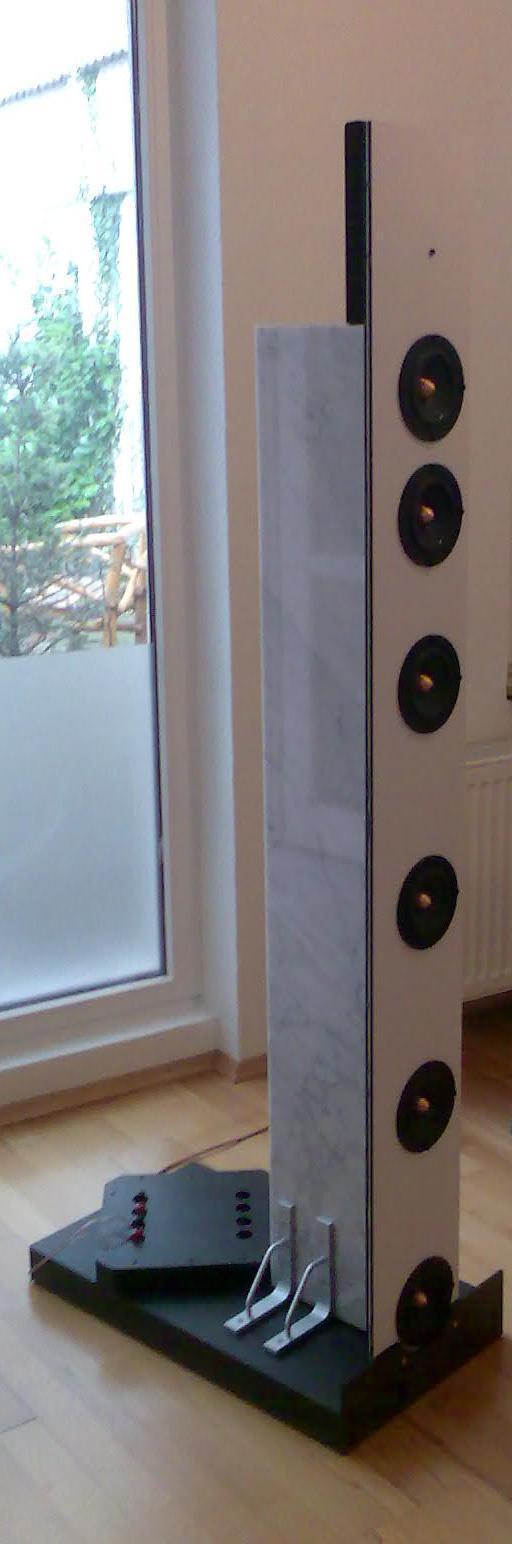

One day I'd like to own loudspeakers that allow me to remove absorption from the floor and the ceiling.
This one gets along with rather light absorption ...
Any polar data available?

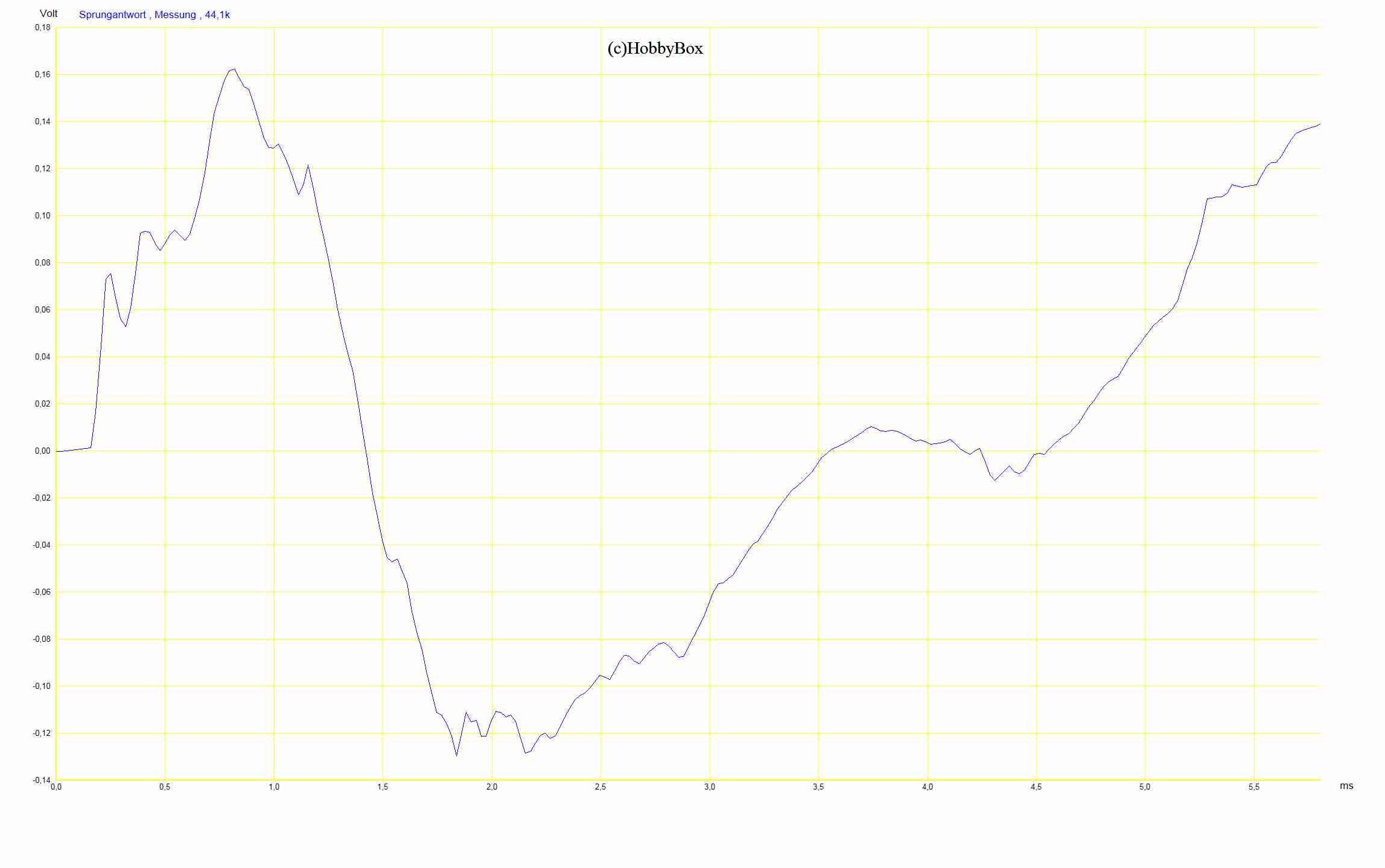

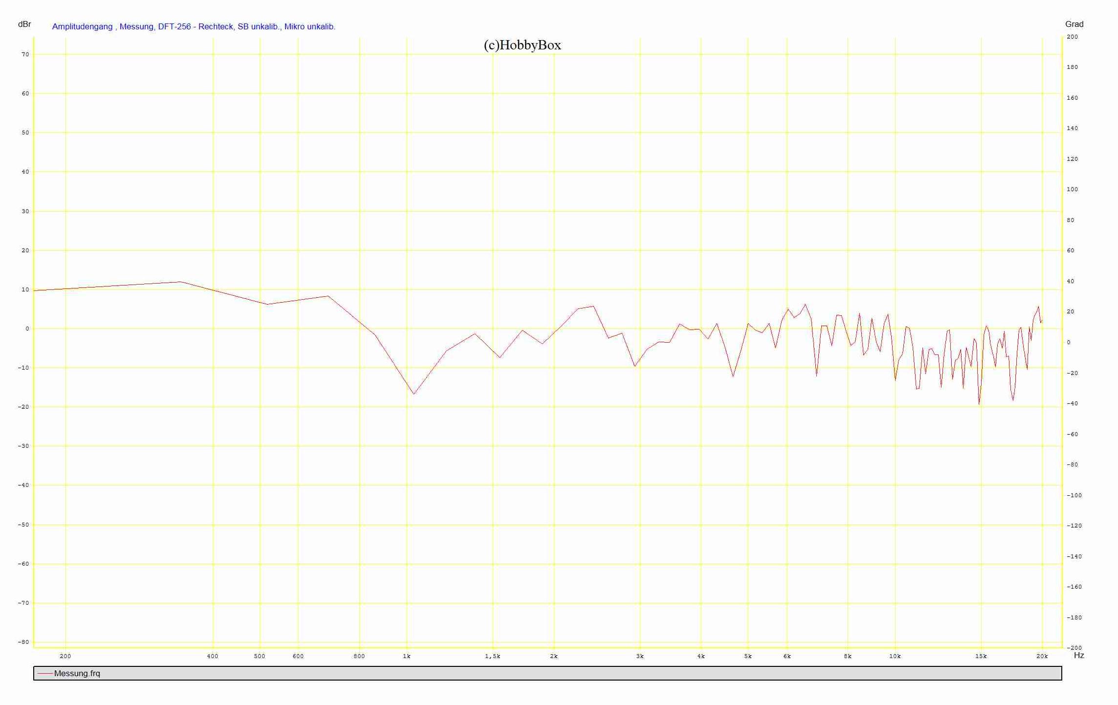

Unfortunately not, but i have a measurement which was made
with microphone on the bottom and in 150cm distance.
Since acoustic center is on ~130cm height for high freqencies,
this would correspond to about 40 degrees off axis vertically.
That speaker is not in the focus right now, but when i have got
some time i will do more measurements, serving for
comparation with my DMLs.
"Dipol 08" 40° off axis vertically, frequency response and step response:
