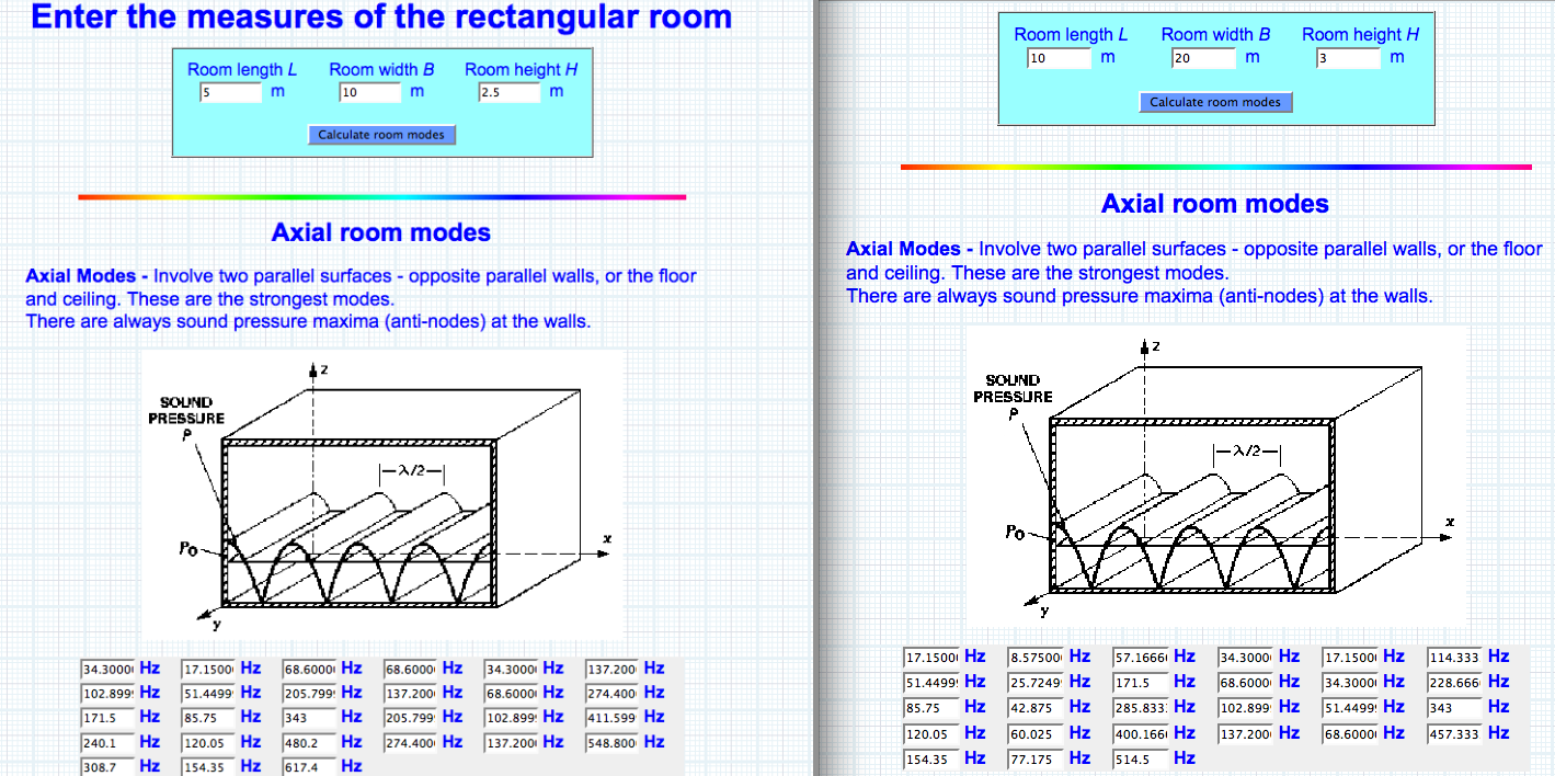

Originally Posted by vacuphile
Small rooms develop standing waves at much higher frequencies than large rooms.
Not true. The smaller the room the more standing waves are "eliminated" at the lower end.
The number of modes within a room always increases with frequency:
The lowest room modes decrease in frequency as the size is increased.
Room modes calculator calculate 3 modes - rectangular room control room eigenmodes eigenfrequencies standing waves room acoustic node frequency - sengpielaudio Sengpiel Berlin

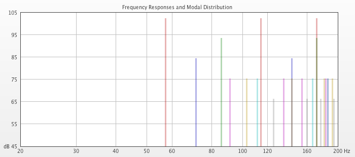

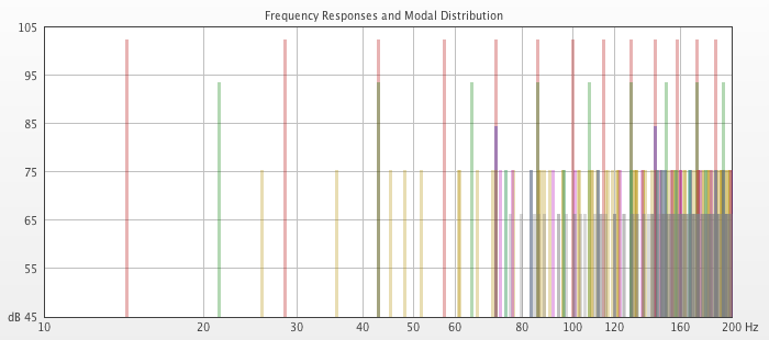

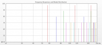

Correct. Just wanted to point out that large rooms have modes at high frequencies just like small rooms. Perceptual problems arise when the modal distribution becomes sparse which happens at the low end of the frequency spectrum. The larger the room the more this range of sparse modes is shifted downwards.
Simulated modes in a room of 3m x 2m x 2.4m:

Simulated modes in a room of 12m x 8m x 2.4m:
attachment.php

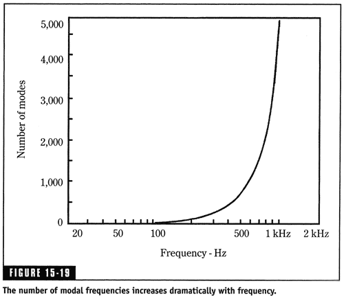

(Everest "Master Handbook of Acoustics")
