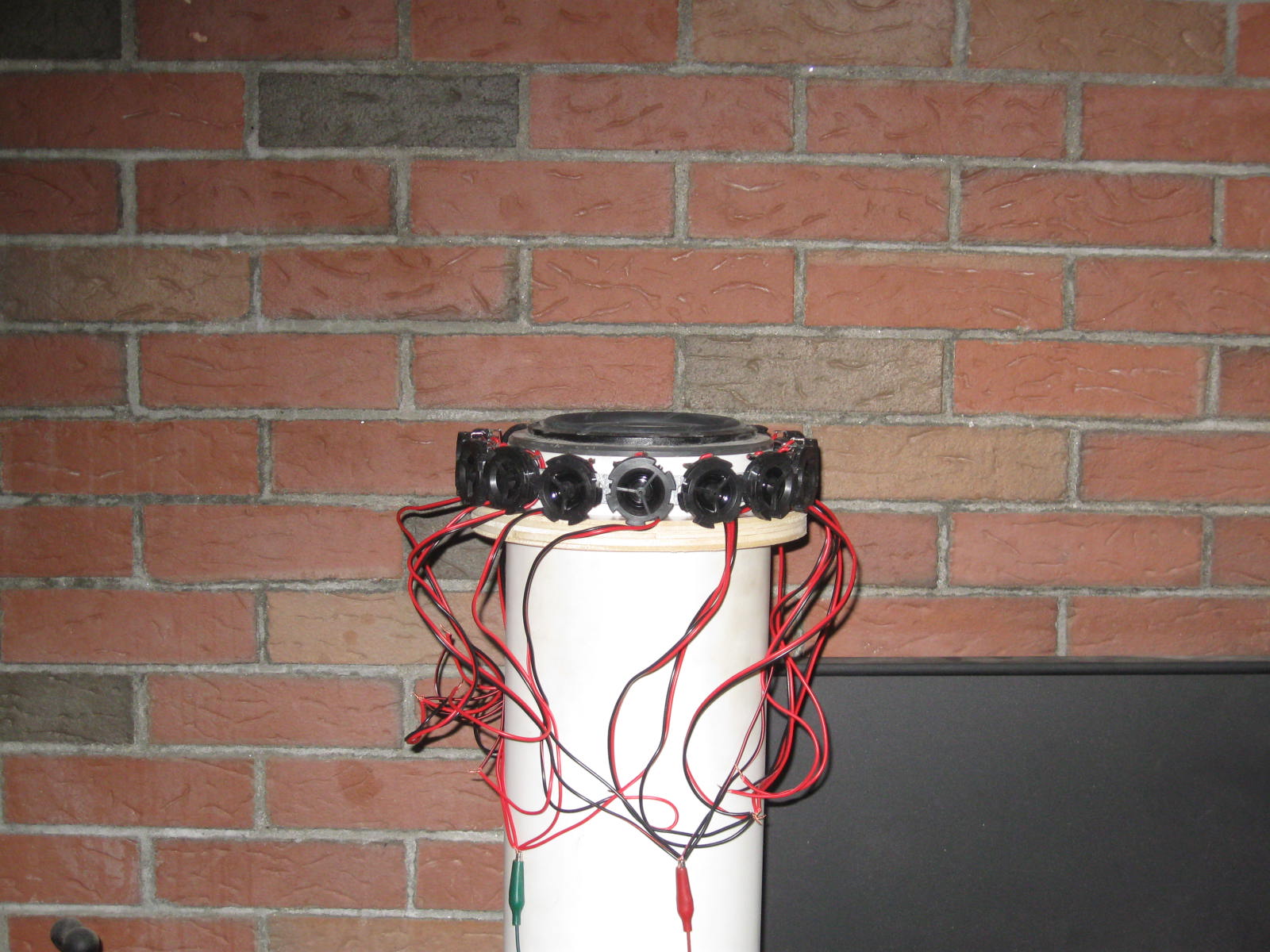

Markus,
Listening room is nothing more than a bunch of artificially added reflections.
Sure, you can boost this number by adding reverberation effects, or more speakers.
Adding another pair of speakers and balancing a stereo signal can pull image in front of main speakers. Some stereo recordings will be perceived as better this way, other recordings won't.
So much comes down to recording and mixing techniques.
Binaural recording/listening reveals that two channel recording can capture everything that brain needs to have a good time.
Front wall reflection isn't a problem when speaker has uniform polar response in horizontal plane.
To this end I've modified Pluto Clone by adding some drivers....
Sixteen tweeters/speaker.
I've placed the speaker pair in a number of locations in my living room. Imaging detail and stability is fantastic.
Even when placed directly in front of brick wall. Of course EQ changes, but this doesn't impact imaging and spaciousness. The walls presence is completely imperceptible. From as far back as I can get to just short of placing head in between the speakers the image remains stable. Approaching the speakers is very much like approaching a live stage.
🙂 Not sure what you're trying to prove or disprove here. The problem with omnidirectional speakers is that low level details are completely lost due to masking effects.
Other than that, this is probably closer to an omni than anything else I've seen here on DIY in a long time. What drivers did you use? Do you run the upfiring driver full range?

FYI: my present setup comprises of speakers with very wide dispersion in a listening room (4.5x8x3.3) which is completely untreated and with furniture with only hard surfaces. I do hear quite a bit of room, but nevertheless, imaging is pin point precise.

Obviously this is a work in progress.
No loss of detail. Everything I can pick out with Pluto Clone is present.
Implementation is via DCX2496. I've played with crossover from 500Hz-2.8kHz with Butterworth 6dB/oct up through Linkwitz-Riley 48dB/oct. Power handling is obscene.
Parts-Express sold them as Onkyo. I bought these from fellow forum member Adison, who used some in Keele CBT clone. Backs of drivers are stamped Delco. They are frequently used in cars.
Google of "delco tweeter" returns hits like this. This appear to be same driver.
Woofer is SEAS L16RN-SL.
If I'm trying to prove/disprove anything it's Linkwitz's observation/conjecture that our perceptual mechanism accounts for specular reflections in manner allowing concentration on direct sound, including virtual sources generated by multiple highly correlated real sources. My observations concur with Linkwitz.
