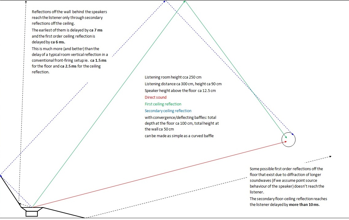

same scheme as before but some additional explanations and numbers:
ps. one important number is missing in the above scheme - the first reflection off the front wall in a typical conventional setup is delayed by ca 3-3.5 ms
with FCUFS there is no such reflection and secondary wall-ceiling reflection is delayed by ca 7 ms as stated above, again much better result without the need of moving the speaker 1 m into the room ...usually to the dismay of other family members 😉
pps.
and - as far as lateral reflections are concerned - if FCUFS are positioned in Beveridge arrangement (see the first post of this thread), then it is realistic even in a medium living room (5x6 m) to have all of them delayed by more than 10 ms
Linkwitz's requirements of "reflected sounds delayed by >6 ms" and of "the reflections are full spectrum copies of the direct sound" easily met in almost any room, nice, isn't it?

Is the picture unclear?
In audio we use the word scatter as in wikipedia where we can read that: "In ordinary English, to scatter is to distribute randomly."
Reflections that undergo scattering are often called diffuse reflections and unscattered reflections are called specular (mirror-like) reflections"
Do You think You can have a diffuse reflection off a regular ceiling?

Art, Graaf seems to live in a world where all ceilings are smooth, and all floors have no carpet on them. Considering the fact that my music room has both carpet, and a popcorn ceiling that world is pretty strange to me. I also have a ceiling fan in that room as well. How ironic.....
Graaf,
Your pictures are clear, but simplistic. Even if we assumed a perfectly hemispherical radiation pattern (which it is not) from a FCUF speaker, it radiates an infinite variety of angles of dispersion, not single laser beams of light.
but can we apply the law of reflection? I know it is a simplification but it is widely applied in audio, right?
and reflections have directions c'mon 🙂 arrows on my scheme don't represent "laser" sound beams - they represent directions of reflections. Isn't it quite clear?
and yes, there are infinite angles but not all in the direction of the listener directly or via secondary reflections and so on, right?
what is important is how many of reflections in the direction of the listener are there within the first 6 ms, 10 ms, 20 ms and so on, isn't it?
but we can certainly say that late reflections are really scattered - perhaps even we can say diffuse - which theoretically is a very good thing, don't You agree?

You happen to like the effect of that ratio, while I prefer the opposite, a high ratio of direct to reflected sound.
perhaps 🙂
but You cannot say that low D/R per se compromises quality if early reflections are under control
and actually with FCUFS, especially in the Beveridge arrangement early reflections seem to be much better controlled than in a conventional setup, please check out the calculations I did above, is anything wrong with them?
Here is the problem with your angle. For me it is not acoustical treatment versus Digital room correction, it is both.
problem is that in practice it is impossible to effectively treat acoustically the floor reflection
consider please how extensive and complex wall and ceiling acoustical treatments have to be to be really effective:
RPG Diffusor Systems, Inc.
Can You do anything like that with the floor?
Please don't tell me that a thick carpet does it all. Be serious 🙂
Floor bounce = bad, ceiling reflection = bad. I can hardly see how that would change with a speaker firing its output towards the ceiling.
Take a look at the scheme I posted above. Consider that it is a UniQ driver. Do You seriously believe that the degree of delay and also degree of coherence don't make any difference in reflections?
But it hasn't. It just created a new problem. Reflections = smearing, and ceiling reflections = bad.
early reflections, especially incoherent with the direct sound, not all reflections
I really find it hard to believe that You actually read Toole's book.
Once again you are making the assumption that I have not heard a flooder.
Have You? Then please tell us more. Make a valuable contribution to this thread 🙂
please 🙂
what is important is how many of reflections in the direction of the listener are therewithin the first 6 ms, 10 ms, 20 ms and so on, isn't it?
but we can certainly say that late reflections are really scattered perhaps even we can say diffuse,which theoretically is a very good thing, don't You agree?
it is not low D/R ratio that compromises space and detail early reflections do it, some detrimental effects dominate especially <6 ms, some <10 ms, and by 20 ms it is rather commonly understood that all detrimental effects are gone
You cannot say that low D/R per se compromises quality if early reflections are under control[/U]
and actually with FCUFS early reflections seem to be much better controlled than in a conventional setup, please check out the calculations I did above, is anything wrong with them?
I agree that early reflections are the most problematic.
The hemispherically radiated FCUFS early reflections if placed near the wall are <6 ms, seemingly compromising "space and detail", as you put it.
By 16-20ms, specular reflections are perceived as discreet echos, I'd also agree that diffuse reflections are less detrimental to sound quality than discreet echos.
Low direct to reflected ratios definitely reduce intelligibility, I have always preferred intelligibility over the quality of "spaciousness" added by room reflections. I prefer listening to speakers on-axis outdoors than indoors if the weather permits, eliminating the majority of reflections, allowing me to hear the music as recorded or reproduced.
If you prefer to listen off-axis with your speakers pointed at the ceiling, that is fine, listening 70-80 degrees off axis with a short rear wall reflection is near my absolute last choice.
Different strokes for different folks, one man's meat is another man's poison, etc.
