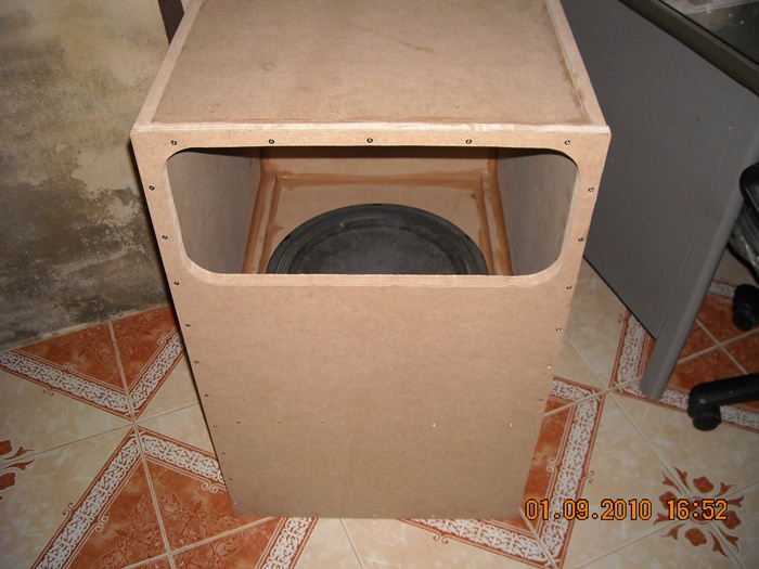

i find this box, they tell 4th order i see the 2 port very bid in the front of this box. the specs use 18" driver. it make me surprise that why i can see the driver inside in the same line level. i want to know is it bandpass or bypass sub. i think it can bypass the high freq to outside. is it correct design?

looking @ the pic i say its a 4th order bandpass with the driver reversed(propably to make the box less deep)
and yes you can always filter it outside the box.

i try to see somewhere that the port location's in front of the drivers. they have a little to design. i consider that if the port like this. the pressure of the air will drop very fast and may not has the deep bass. ok i'll not design like this
