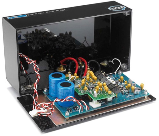

You probably do not realise, but the plastic clips, nylon standoffs, specific wire types, acrylic casing, etc are not there to save money. No idea if this device sounds any good, but the general design principles indicate a designer with listening skills and abilities - something exceedingly uncommon within the diy-er fraternity.
Even the wretched tantalums are there in a pursuit for a specific signature, albeit not one i much enjoy.

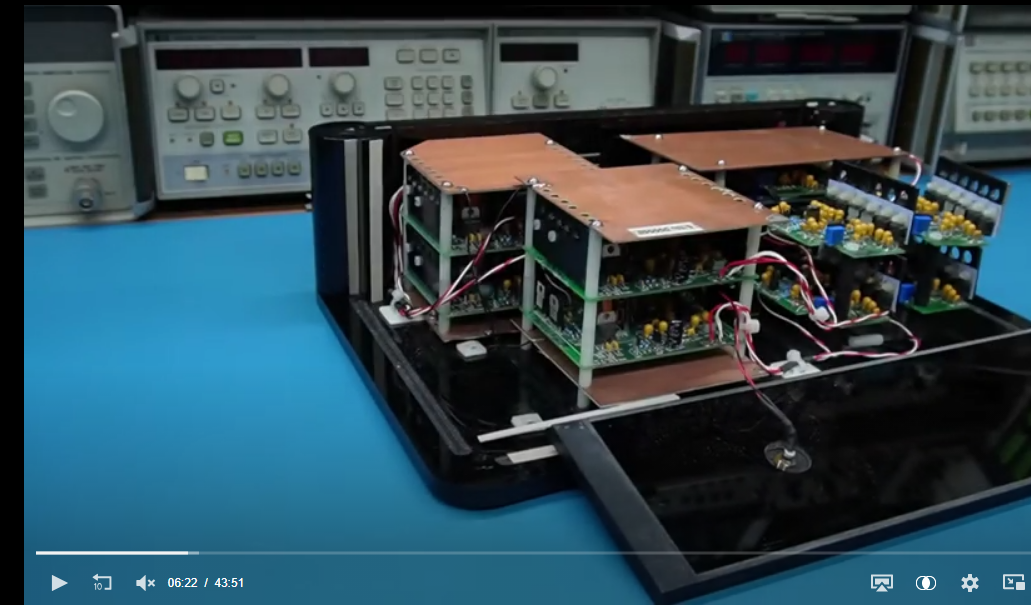

I realise the importance of cutting down unwanted magnetic fields & structural resonances, here is a screenshot of the full item from the Mend it Mark video.
Note the copper clad PCD boards. Apparently some were double sided & others were single sided. Obviously this is for shielding, as its wired to a star ground (apparently). I would have used brass risers/standoffs as stronger & more stable for the PCB boards. Also if you're that worried about shielding on a £25K item why not shield the sides, so all you see a copper clad "cube" around each set of PCB modules (3 cages)??
Like I say basic construction is seriously lacking for the price point! I've seen way better stuff built by "one man bands" for a fraction of the price..let alone better mass produced stuff!.....(construction, build quality, not talking about circuit design as I don't know enough on it)
I'll say it again, despite the ******* in the build quality the Master groove is a very good sounding phonostage. He might be a **** builder, but Tom's got good ears.

They break when tightened, which means they cannot be tightened enough for the prescribed pressure. In all respects about the worst way you can do this. This clearly indicates that at least in this area he doesn't have a clue. Or doesn't give a hoot.What is also interesting is the numbers of TO220 packages being bolted on to heatsinks with plastic bolts. How hot can they be getting if plastic bolts are an option? Plastic bolts easily break in the tightening
Jan
This provides zero shielding, not even for RF. It's useless, although some people may be impressed by the sight.Note the copper clad PCD boards. Apparently some were double sided & others were single sided. Obviously this is for shielding

previous editions of these regulators didn't use heatsinks so perhaps the need for heatsinking on these is marginal.
Jan
I had wondered as its just the top & bottom & not a "wall" wrapped around the PCB boards.....maybe its a "secret sauce" antennae or heatsink to remove unwanted electrons?... 🤔 ......🤐
Put it this way for £25k I'd expect better.....
You mean he knowingly used plastic screws knowing that they impair heatsinking, because he didn't really need the heatsinking?@jan.didden

I thought his phono stages and preamp looked very much like the designers I regard highly might build -- particularly the use of the regulators and the reviews mirrored what I would expect to have achieved with Super Regulators and well-crafted circuits by Wayne and Nelson, Richard, Walt and Jan.
I looked askance at the rudimentary Faraday cage and wonder how the heck could that work especially for an MC preamp.
The insides of the MasterGroove didn't surprise me... he's been using these techniques for years. It's a cottage industry build. He's consistent.
