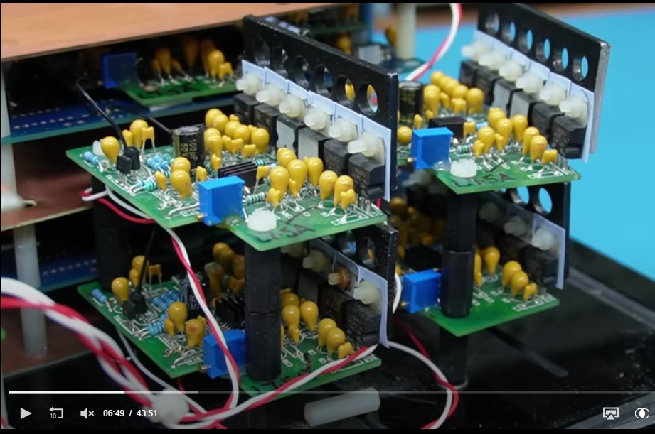

Basic construction fails on the Tom Evans £25K Mastergroove...
Photo below is a screenshot from the original Mend it Mark video...note the black painted heatsink with the IC chips fixed using plastic screws & the very thin cables...it all just looks shoddy for £25k..

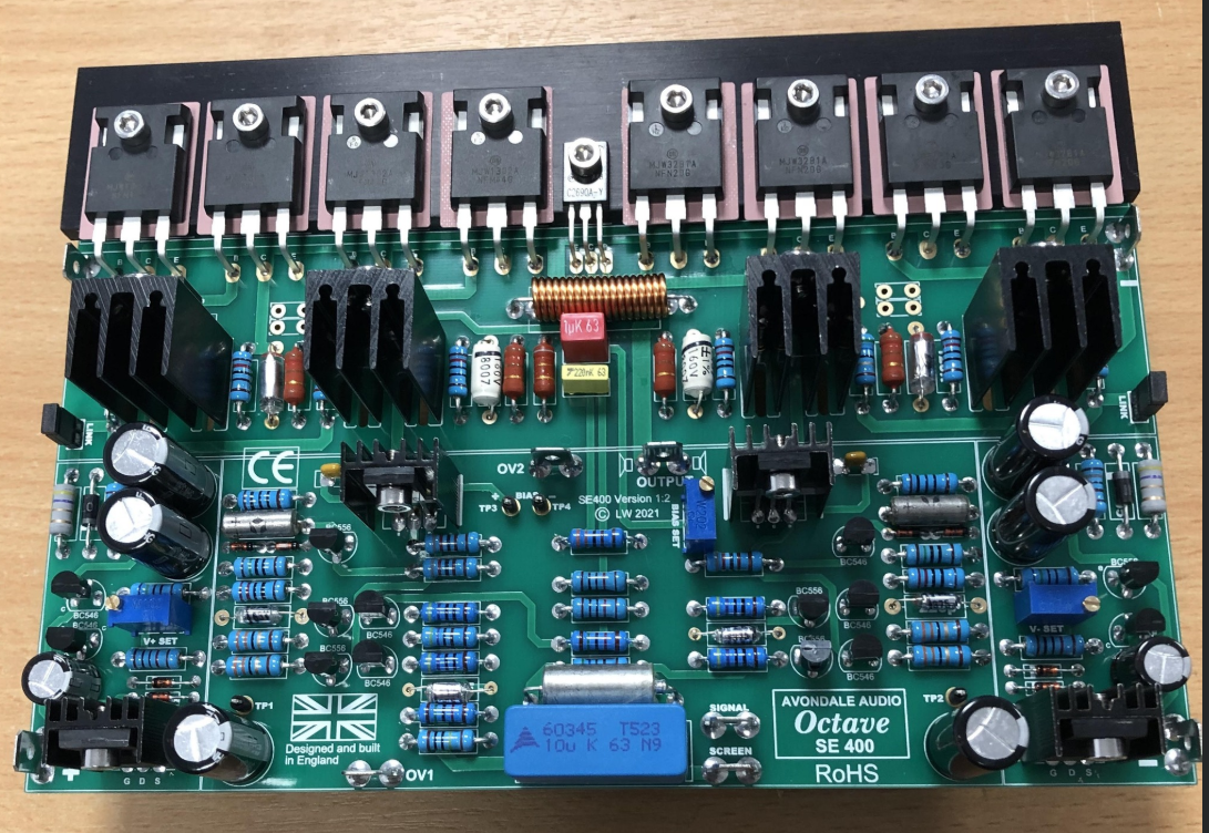

Photo below is a screenshot from the Avondale Audio Facebook page. Much neater build of the circuit, nice thicker heatsink black anodised, & IC chips fixed using stainless steel bolts. (Yes the circuit is for an amp) Irrespective of your like or dislike for what Avondale does to Naim amps, I follow them as I like the design & build quality of their circuits. Not only that but he is totally open about his designs, no sanding off the ID marks on components, etc., etc, & bare in mind he is in a much cheaper price point (by a factor of 8 to 10) than the Tom Evans build!

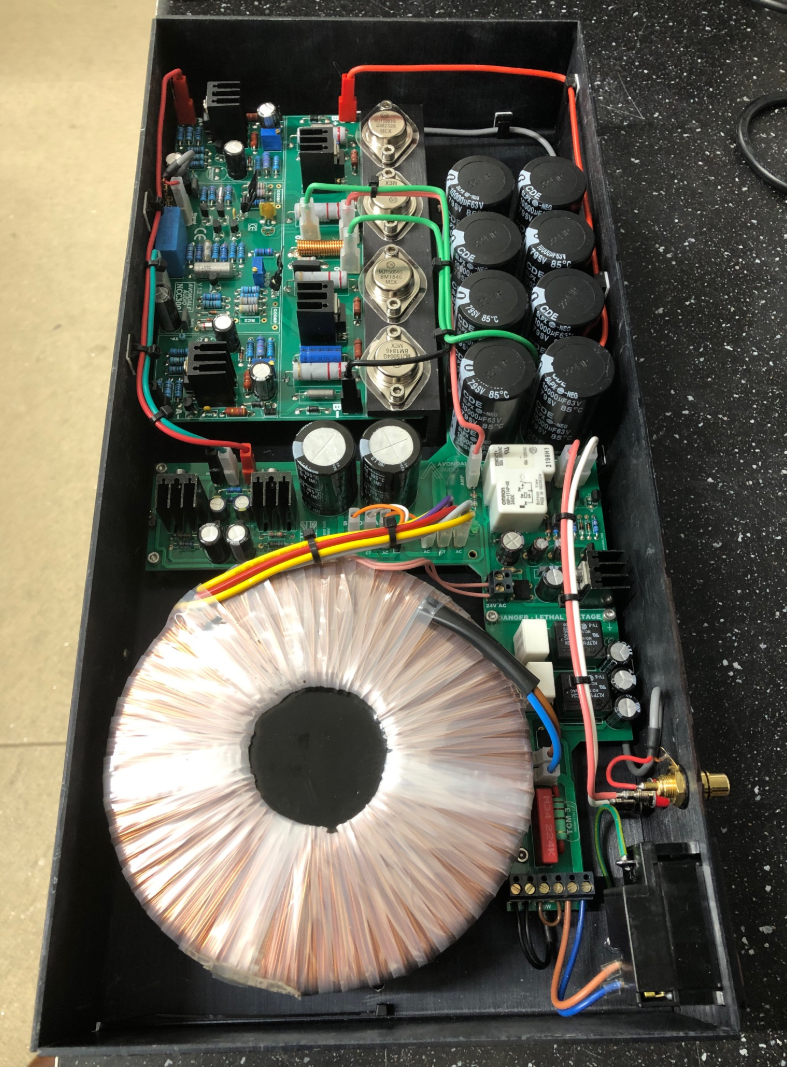

Avondale Audio amp, note the nice easy to remove spade connectors for the thicker cables..nice & easy to build & repair in the future......just better build qualities......(image from Avondale Audio Facebook page)
You probably do not realise, but the plastic clips, nylon standoffs, specific wire types, acrylic casing, etc are not there to save money. No idea if this device sounds any good, but the general design principles indicate a designer with listening skills and abilities - something exceedingly uncommon within the diy-er fraternity.
Even the wretched tantalums are there in a pursuit for a specific signature, albeit not one i much enjoy.

Yes. What is also interesting is the numbers of TO220 packages being bolted on to heatsinks with plastic bolts. How hot can they be getting if plastic bolts are an option? Plastic bolts easily break in the tightening. Who uses plastic bolts for that function? And how much current is being drawn by the opamps to warrant that many TO220 packages on heat sinks? What is the load?
