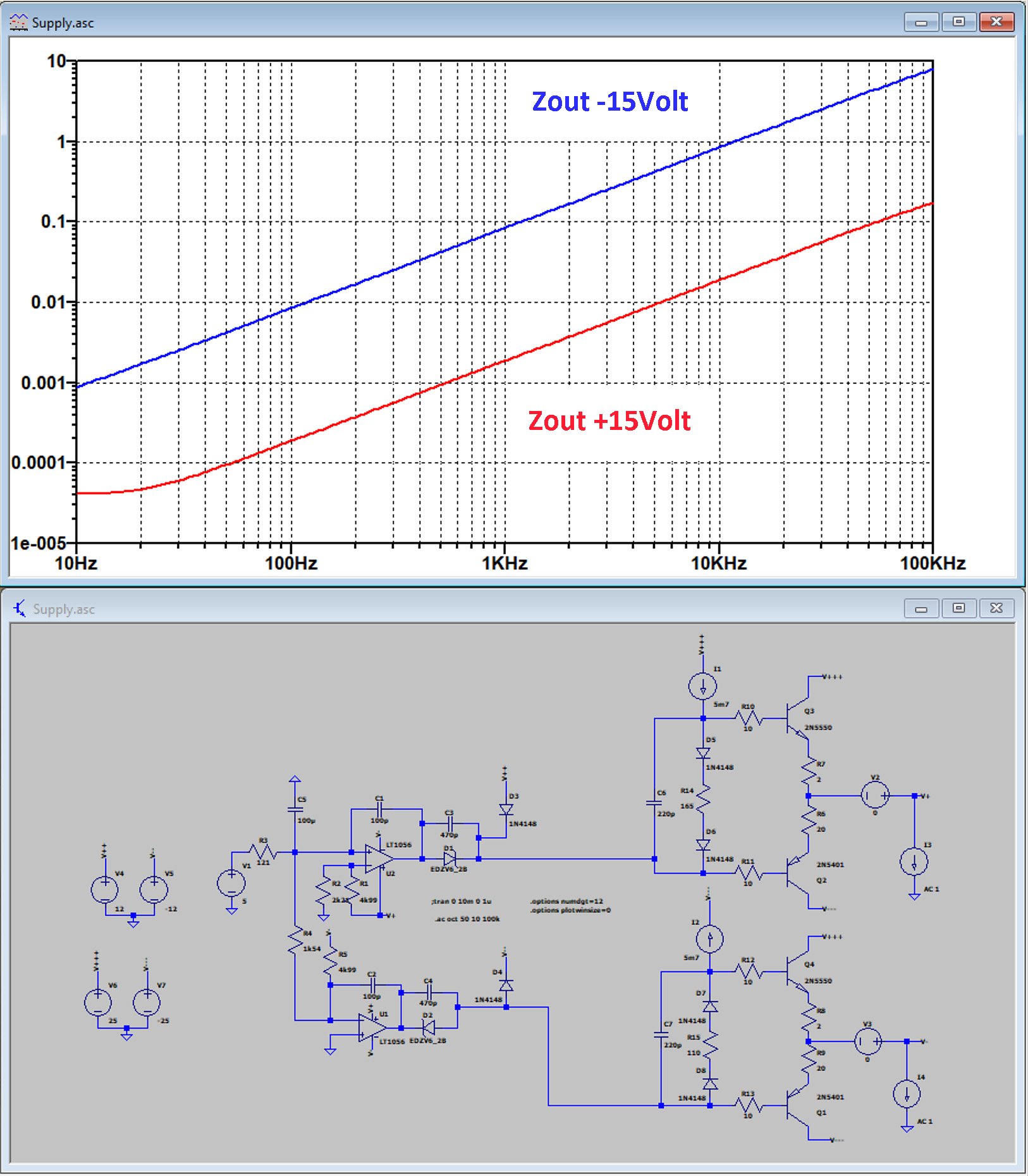

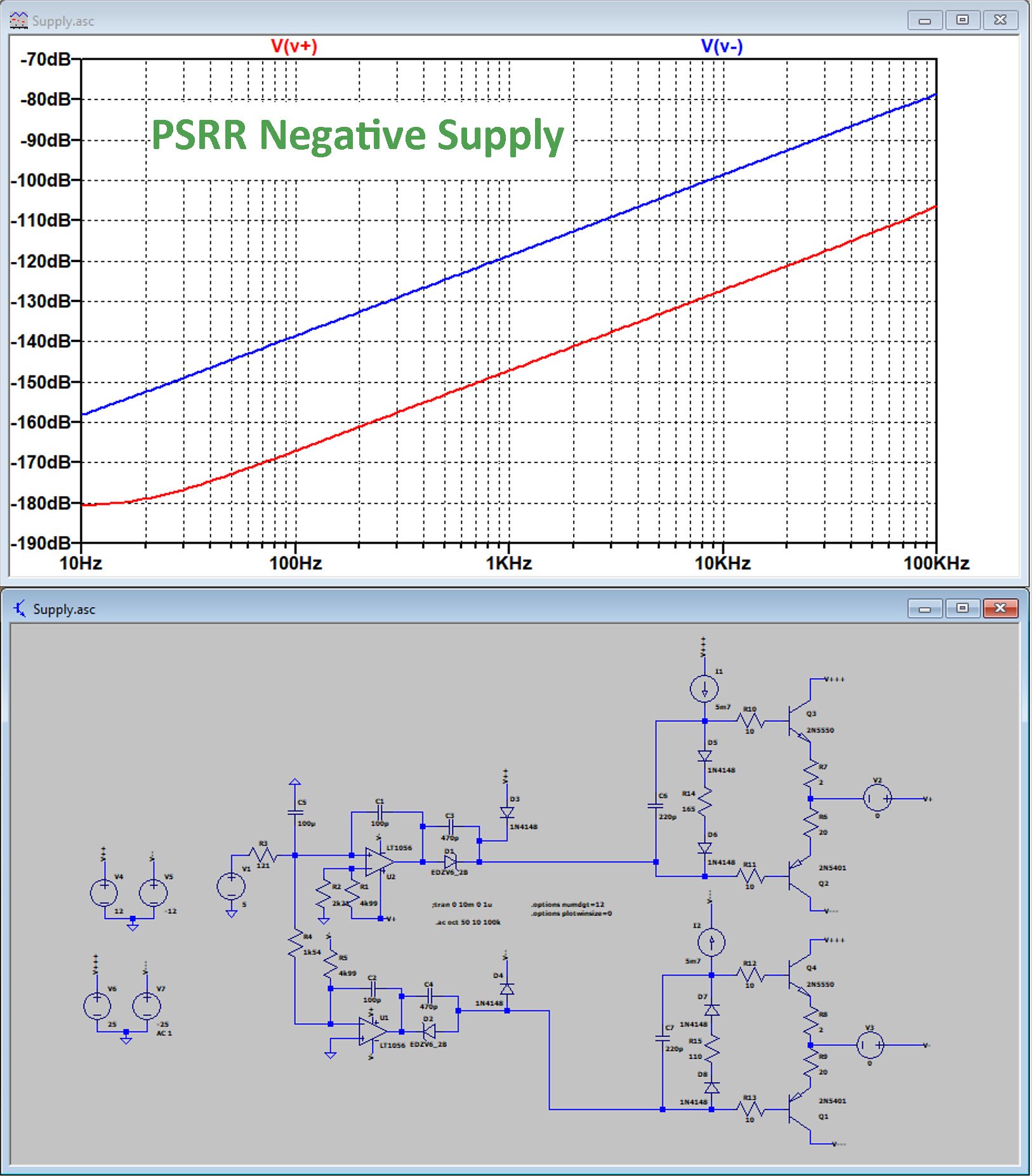

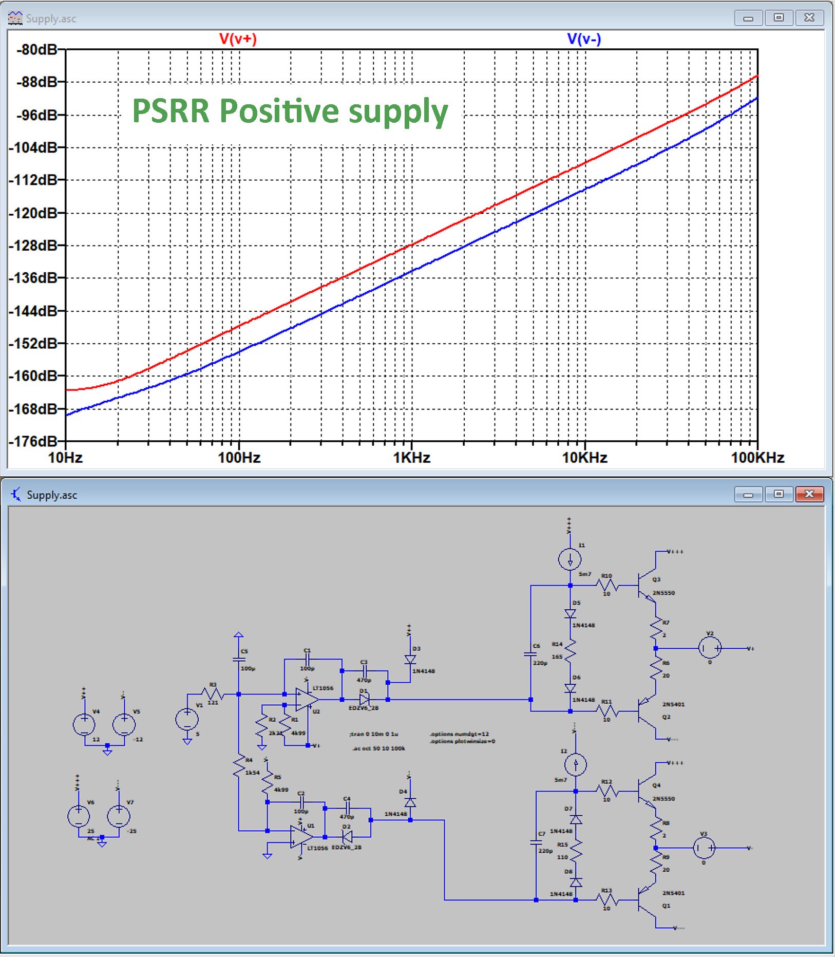

Here is the simulated Zout from the +15V and the -15 outputs, but also the PSRR from the positive supply and the negative supply.
A slower LT1056 amp as the OPA2604 was used, but trying a faster one didn't change the figures that much because of the 100pF feedback cap.
PSRR figures from both positive and negative supply are quite good.
Zout figures at low frequencies are also very good, but looking at Zout for the -15Volt at the high end of the audio spectrum it seems to me that Mark Levinson may not have had access to LTSpice at that time.
Hans

Hans, I am a bit confused. If I 'look' into the output of the +15 (same -15) I see 2 ohms // 20 ohms. How can that give a Zout below 1.8 ohms or so?
There is no feedback from that output afaics.
Jan
Jan

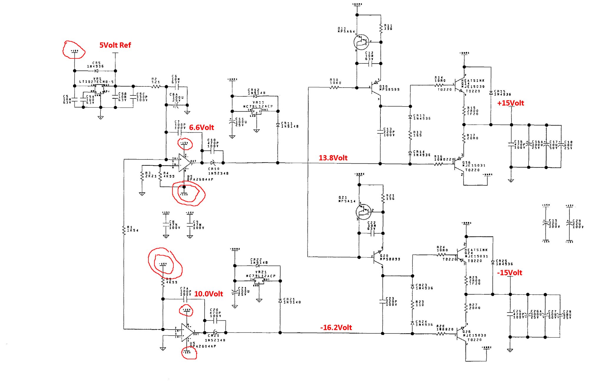

The supplies are dual open loop integrators inside a feedback loop that feeds a discreet output buffer. The outputs also feed the supplies of the input integrators, hence moving. This is why it looks unnecessarily convoluted, as if the engineers couldn't regulate the supplies to the integrators well enough.
Jan, isn’t this essentially the same as in your boot-strapped unipolar regulator, where the error amplifier supply rail is inherently part of the output’s feedback circuit?
