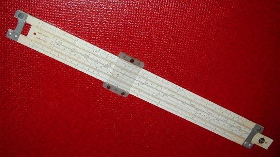

To get your real distortion you can do the math on a pocket calculator
Or with pencil, paper & slide rule like us fossils used to do!😱
