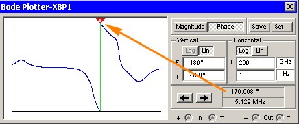

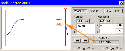

I now see our circuits are very similar, so i appologise if you thought i was treading on your toes etc 🙁 My circuit doesn't have the diodes in U2's feedback path though, & of course the component values are different.
As you suggested, i've included a LPF filter @ the input = 100R & 2nf = 80kHz. The fr is still very extended, & THD is still 0.001% or less @ 1kHz, but the Phase looks problamatic.

Zero D,
The bode plotter on the right goes out to 200 GHz! Even with the usual simplified models accounting for parasitics (e.g. ESL and ESR in capacitors), you'll be lucky to get accurate results above about 50 to 200 MHz.
In any case, these look like closed-loop plots. These don't really tell you anything about stability.

Thanks, yes the input pre-filter does indeed help. And with it i am able to use much lower value Caps on U1 & U2 feedback resistors, whilst still retaining a very high bandwith & well behaved phase. The HB sims i'm doing are just out of curiosity, & naturally i wouldn't expect an actual design to fly so high.
Hi, yeah i kept expanding the plot to view as much detail as it was able to present. I just thought it looked interesting what "appears" to happen Way up there, in a sim anyway. You're right of course, in Actuality with real components etc, i wouldn't expect to see that, or suffer the consequences.
Yes they were.
Would the best way to establish that, to include the L & C you described etc via PM earlier ? Or ?

I've just corrected it, & i'm still getting similar excellent results as before, but this time no big phase shift way up high 😉

That's correct. By changing the values of the capacitors over the feedback resistors in the right ratios on U1 & U2, i can achieve a very high gain bandwith with no peaking etc. Lowering the bandwith is fine too.
