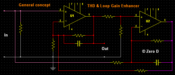

THD & Loop Gain Enhancer
The following is applicable to both Power Amps & OpAmps.

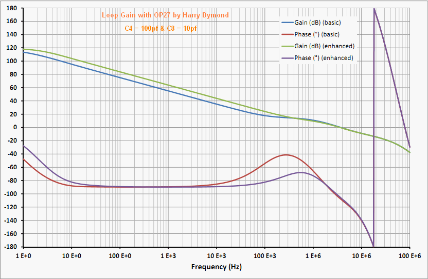

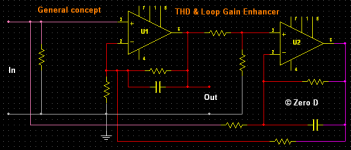

I've been tinkering for a number of weeks with an "Enhancer" circuit added to an Amp, which improves both the THD & Loop Gain specs. I'd be interested in hearing your comments & suggestions etc, for where it "might" be improved etc.
Harry Dymond
has been kind enough to assist me in various ways :) & by simulating the circuit & establishing that it improves the Loop Gain. He also provided me with several links http://www.analog.com/static/imported-files/application_notes/AN-107.pdf
I also observed greater bandwith with my Enhancer circuit, as in AN-107.
Figure 1 in AN-107
That arrangement seems different to mine.

Looking at my circuit -

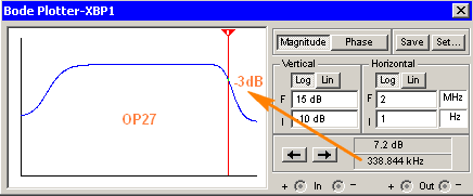

OP27 With Enhancer = 0.001% @ 1kHz
OP27 Without Enhancer = 0.003% @ 1kHz

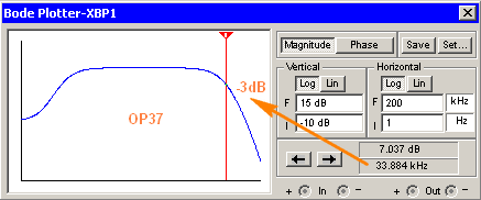

Interestingly with a much higher bandwith OpAmp the distortion is a LOT worse, & the bandwith is about 10 times less ? No other components were changed, or Anything else !
OP37 With Enhancer = 0.159% @ 1kHz
OP37 Without Enhancer = 0.049% @ 1kHz

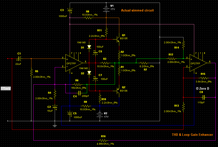

I would worry about one of your schematics - not near enough current gain to drive 8 Ohm nominal loudspeaker load - added voltage gain can't help there

Well that's just for starters. The circuit i've shown is one that sims & works as described.
The 8.2 Ohm load was just there as one option. With for eg 32 Ohms, THD @ 1kHz is unmeasurable.
But it's NOT really about this Amp, it's about the Enhancer circuit which could be configured to work with other Amps & PreAmps etc. The components around U2 & connected to U1, are only provisional. The main purpose is for people to experiment with other values, & sim it themselves, to discover what's possible etc, & post their results ;)

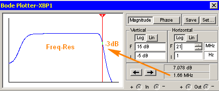

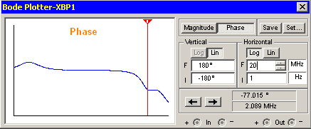

I've realised why the OP37 THD result was so poor. I forgot it requires a gain of 5 or more. Changing it improves things substantially.
U1 = OP37 & U2 = OP27 - C4 = 33pf & C8 = 10pf
THD @ 1kHz = 0.001% or less
The bandwith looks pretty good to me, & that's with those output trannies !
Er, what exactly is the difference between Zero D's circuit and AFEC? It's exactly the same principle as far as I can see.
Bonsai, I've had a very brief look at your AFEC document (as always, thank you for documenting your work so thoroughly and sharing it freely :D) and I don't trust your loop gain simulation. You should see a difference between AFEC on and AFEC off. The circuit is not feed-forward, so where is exactly is the improvement in THD coming from if not by an increase in loop gain?
Is figure 5 the circuit you used for loop gain simulation? The output of the AFEC circuit (after R74) is labelled "Vfb", but I can't see any other node in the circuit labelled similarly, so where is the AFEC signal going?

Harry Its not feed forward - as I note in the document, it augments the normal feedback loop, so yes, it does work by increasing loop gain, but not by brute force. Most of the error correction (read: distortion reduction) in a normal amp is provided by the main loop. Any residual error (distortion) can be seen as the main loop simply running out of steam. AFEC corrects for that by comparing the output signal with the input and injecting an error correction signal into the feedback node. This is in marked contrast to feed forward schemes, or approaches that accomplish low distortion through very high loop gain.
As I noted in my write up, some more work is required to flesh out the design. Your comments about the loop gain plots are acknowleged - thanks for that input (hell, its difficult to avoid a pun here, no matter what I write!).
Maybe you'd like to take a bash at the loop gain equations which would help to formalize the approach.
