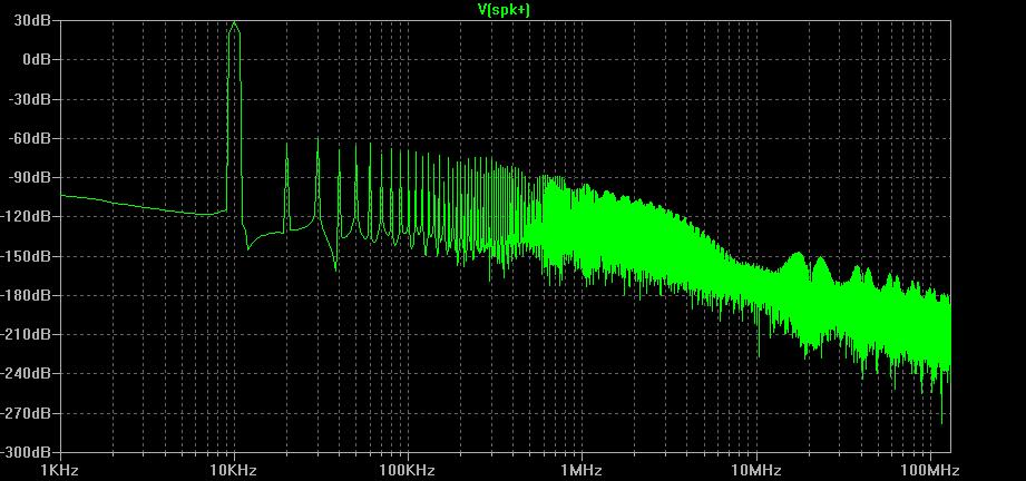

latest implementation results

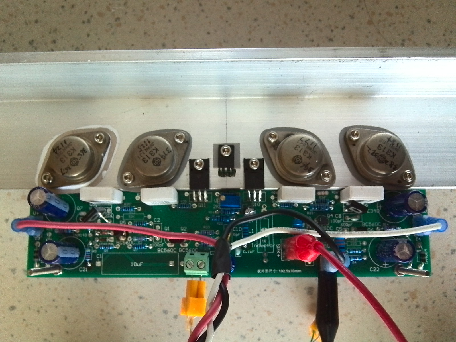

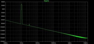

Hi mates,
This is to report the latest implementation results.
Some modifications have been made to the circuit in the opening post. Firstly, in the VAS, as zenelectro and Douglas Self mentioned, the compensation cap C12 is modified to across the whole Baxandall pair formed by Q14 and Q10. R36 is increased from 1150ohm to 33k, so that it supplies about 1.6 mA enough but not excessive bias current to the Q14 emitter. C2 and R7 are removed from the base circuit of Q14, since they neither help to eliminate the high frequency parasitics nor help the VAS recover better from clipping. The Q13 is also removed from the constant current source since it does not help here (maybe it does, but just does not show by Spice simulation). Secondly, two 100ohm emitter resistors are added to the LTP Q11 and Q12, also the emitter resistors of the current mirror is reduced from 690ohm to 47 ohm as suggested by BV. These changes, I hope, help to linearize the input stage and the VAS. And then, the output stage is changed to compound quasi complementary with Mosfet as output transistors. Reason for changing the output from bjt to Mosfet is that I want to use TO3 metal can transistors for good thermal stability and achieve good linearity at large load such as 2 to 4ohm, where current may > 10A. In viewing hfe-Ic curves of the popular TO3 bjt transistors, I have not found any good ones for this purposes. I happen to have some older 2SK313 metal cans, so I used them in the implementation. I am not sure if the old slow 2SK313 is the right choice for this amp, but it has a rated Idmax of 12A and small input capacitance, and it is designed for high frequency amplification as stated in the datasheet (see attached). For the two driver transistors, I actually use 2SA1930/C5171, which is more modern than the old fashioned TIPs.
Figure1.
The finished amp is shown in the above Figure1. I have measured the amp with since and sq wave, and listening-tested this amp with a +/-30V DC power supply. The frequency response roughly replicates the Spice simulation. I also have not implemented the low pass filter inductor L1 and R21. My scope can show frequency up to 100MHz. There is no resonance at any frequency up to 200KHz sq wave, higher frequency sq ware signal not tested. Sound is ok but nothing particular to mention. At least when there is no signal, the amp is deadly quiet.
The current LTspice simulation results is 0.0053% THD at 10KHz 84vpp sine wave to 8ohm load.
Harmonic Frequency Fourier Normalized Phase Normalized
Number [Hz] Component Component [degree] Phase [deg]
1 1.000e+04 4.184e+01 1.000e+00 -2.48? 0.00?
2 2.000e+04 8.562e-04 2.046e-05 85.44? 87.92?
3 3.000e+04 1.433e-03 3.425e-05 135.12? 137.61?
4 4.000e+04 5.211e-04 1.245e-05 90.62? 93.10?
5 5.000e+04 7.201e-04 1.721e-05 -28.20? -25.72?
6 6.000e+04 9.079e-04 2.170e-05 81.75? 84.23?
7 7.000e+04 3.668e-04 8.766e-06 103.40? 105.88?
8 8.000e+04 5.804e-04 1.387e-05 84.51? 86.99?
9 9.000e+04 4.048e-04 9.674e-06 69.16? 71.64?
Total Harmonic Distortion: 0.005363%

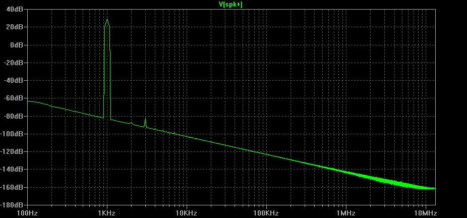

0.000298% THD at 1KHz 84vpp sine wave to 8ohm load.
1 1.000e+03 4.189e+01 1.000e+00 -0.17? 0.00?
2 2.000e+03 4.436e-05 1.059e-06 -158.28? -158.11?
3 3.000e+03 8.531e-05 2.037e-06 101.42? 101.60?
4 4.000e+03 2.388e-05 5.702e-07 160.17? 160.35?
5 5.000e+03 2.283e-05 5.450e-07 -125.70? -125.53?
6 6.000e+03 1.547e-05 3.692e-07 134.31? 134.48?
7 7.000e+03 4.073e-05 9.723e-07 110.79? 110.97?
8 8.000e+03 1.153e-05 2.753e-07 138.33? 138.51?
9 9.000e+03 5.629e-05 1.344e-06 99.13? 99.31?
Total Harmonic Distortion: 0.000298%

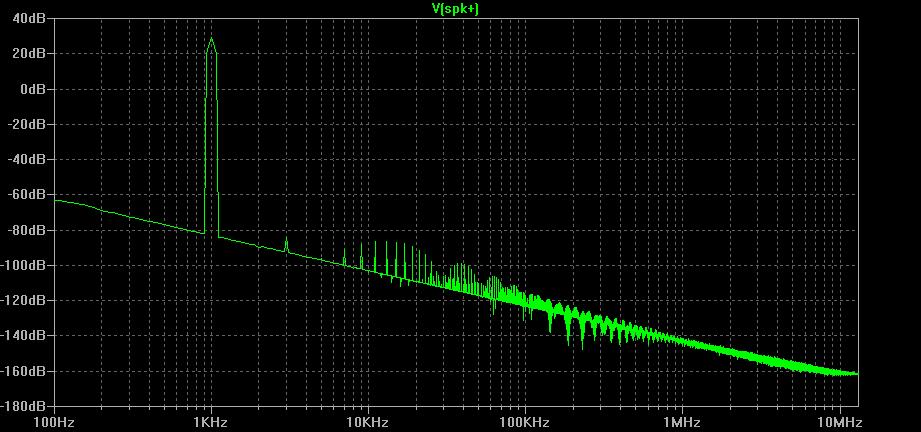

2 2.000e+03 6.321e-05 1.509e-06 -154.00? -153.83?
3 3.000e+03 1.081e-04 2.582e-06 99.19? 99.36?
4 4.000e+03 2.810e-05 6.709e-07 -177.44? -177.27?
5 5.000e+03 2.176e-05 5.195e-07 -135.07? -134.89?
6 6.000e+03 1.504e-05 3.590e-07 176.61? 176.78?
7 7.000e+03 1.545e-05 3.688e-07 170.02? 170.19?
8 8.000e+03 1.234e-05 2.945e-07 -178.92? -178.74?
9 9.000e+03 1.035e-05 2.471e-07 -176.88? -176.71?
Total Harmonic Distortion: 0.000317%
When bias it in class-A the higher order harmonics will be eliminated, but the total distortion figure does not change much from class-AB. 🙄
This is really a great forum for audiophiles. I have learned a lot from people in this forum. 😀
Special thanks to BV, zenelectro, and JCX. BV contributes many good improvements to this design. Zenelectro pointed a critical change to stabilize the original design. JCX also pointed some flaw in the design, which prompted me to search for better solution. I also would like to thank, greierasul, D. Self, Kastor, Bonsai, iko, bimo, and many others who contributed ideas and given good suggestions.

Hi adason,
I have built the amp(see two levels up).Wish to have an AP to measure it.

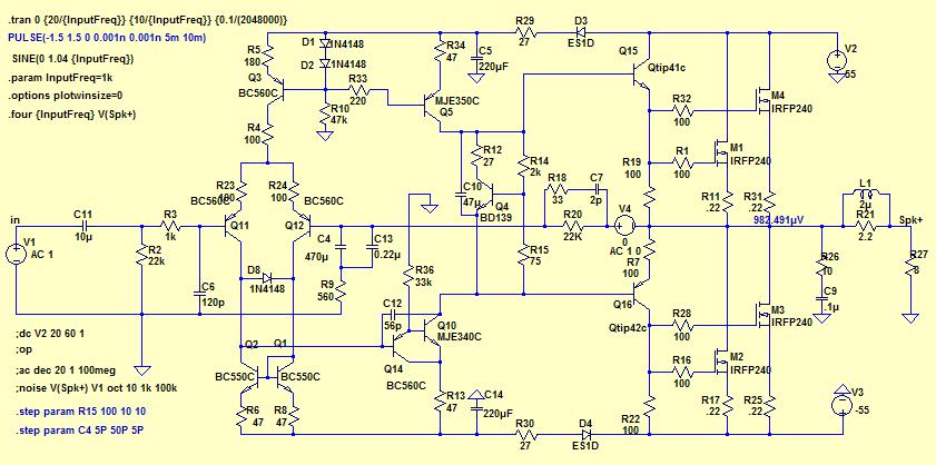

The classic flaw of this schematic and the reason it is showing such a)low
distortion and b) poor stability is simple:
The 100p Miller compensation is across only half of the Baxandall Pair, as such the B.P. essentially defeats it completely, just like it defeats the
Cob of that transistor.
Strap the 100p across both Q1 and Q12.
On the other side, no need for the 100p, it's just a current source.
If anything this baxandall pair CCS may need some taming with a base stopper on Q10.
I re ran the sim as such and the distortion is around 0.01 at 28V peak / 8
ohm.
Oh well no free lunch 🙂
Z
Hi Zenelectro,
Thank you very much for pointing out the flaw in stability. I simulated a classical Naim NAP140 amp, which is what this amp is based on. The Naim NAP140 with minor modifications to componnent selection and values, can achieve 0.01% THD. This low distortion amp, with the improved input and VAS stages, should be much better that a Naim.
Jazz

WRT Baxandall pair, they are generally used to negate a reactive capacitance
and in particular a voltage modulated capacitance as is seen across most
semiconductors. For example, in a CCS this Cob capacitance may manifest
as a much reduced OP impedance at high frequencies then implementing a
Baxandall pair in the CCS output will keep the impedance much flatter as
frequency rises.
In the case of the voltage stage in an amplifier you have too look at -all- the

There will be 2 main sources of distortion in this voltage stage, a) The non
linear Cob of the driver transistors, b) The non linear effects of C12
compensation capacitor. As you load the OP stage with say 4 ohms, since
the MOSFETs have fairly low gm compared to a BJT OP, this stage will be
swinging in a non linear fashion to keep the OP swing linear. As frequency
rises this non linear swing basically makes C12 look like a non linear
load and there's your rising distortion with rising frequency.
Same goes with xover distortion.
Your simulated results show this quite clearly.
Personally I try to achieve simulated distortion results below 0.001% at
20kHz into 2 ohms with around 30 to 40V peak swing out of a simple
circuit with good phase margin.
If the design can achieve this it will have a pretty good chance of measuring
very well in real life given a lot of attention is paid to layout etc.

These are the result of simulation of my blameless amplifier:
Phase Margin 66. Gain Margin 8.
THD at 71W/8Ohm, 20kHz -> 0.000287%
THD at 142W/4Ohm, 20kHz -> 0.000537%
PSRR at 100Hz -> 118 dB
Slew Rate 90V/µS
I use +-44V DC power supply.
And the sound is really good 😉
