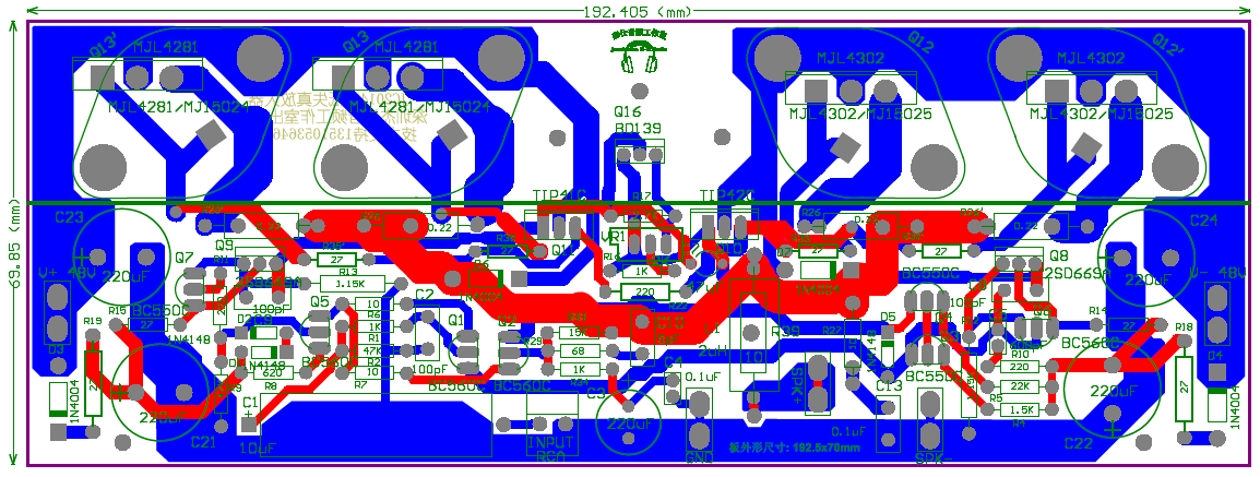

Because of wrong style of compensation..Connect C12 right way, from colector Q10 to base Q14, not to emitor (low impedance).. Increase R35, R36 at least by one order.. It has no sense leave this stage to work with 35mA current. And you can ommit C2,R7 completly. Output phase tells quite nothing about phase margin (stability)the ac analysis show bad phase margin; when ac analysis show good phase margin, the transient simulation show nasty oscillation.
Anybody know why?
R2 should be the same as R20 (DC balance, output ofset), move R2 to parallel with C6, change R6, R8, R34,R13..Look at attachment.
Think about D8 purpose. But if needed it is possible to improve clipping behavior, few componets (R,D).

The PCB aims to accomodate two pairs of TO3 metal can power transistors, but also compatible with TO264. Metal cans are said to have the least IM at radio frequency. I am not sure whether that is true. But I believe they have the best thermal stability
Any idea what power transistors are best for the output of this amp?
The 100p Miller compensation is across only half of the Baxandall Pair, as such the B.P. essentially defeats it completely, just like it defeats the
Cob of that transistor.
Strap the 100p across both Q1 and Q12.
Exactly correct.

Just passing by, but I noticed the intriguing apparent symmetry of the VAS stage. (I'm referring to the schematic on Page 6)
In fact the top half is a Baxandall current-source and the bottom half an EF-VAS with the EF inverted (see p195 of Audio Power Amplifier Design 6th Edn)
Most artistic! I like it.
I should however say that I don't think the high output impedance of a Baxandall current-source is going to make any percptible difference.
<NITPICK>I assume the current-mirror degeneration resistors are mean to be 680R. Seems rather high- is there enough voltage for the mirror to work properly?</NITPICK>

Hi, it is a great pleasure to see your comments😀
The simulation tells there is a 1.119mA current through the mirror collectors, base current is about 2.5167 for the left and 2.4238 for the right.Voltage over the 690R risistor is 0.774V.
What is your idea how to leverage the high output impedance of a Baxandall current-source?
Cheers
Jazz
Cheers
Jazz
My pleasure.
I have no real idea how the high output impedance of the Baxandall current-source could be put to advantage. Here the VAS is loaded by the output stage, and it so it's hard to see how an unusually high current-source output impedance could do any good.
If the VAS is buffered from the output stage, then the high output impedance might increase the o/l gain at low frequencies where it is not controlled by the Miller capacitor. This might improve the PSRR, but not the THD.
