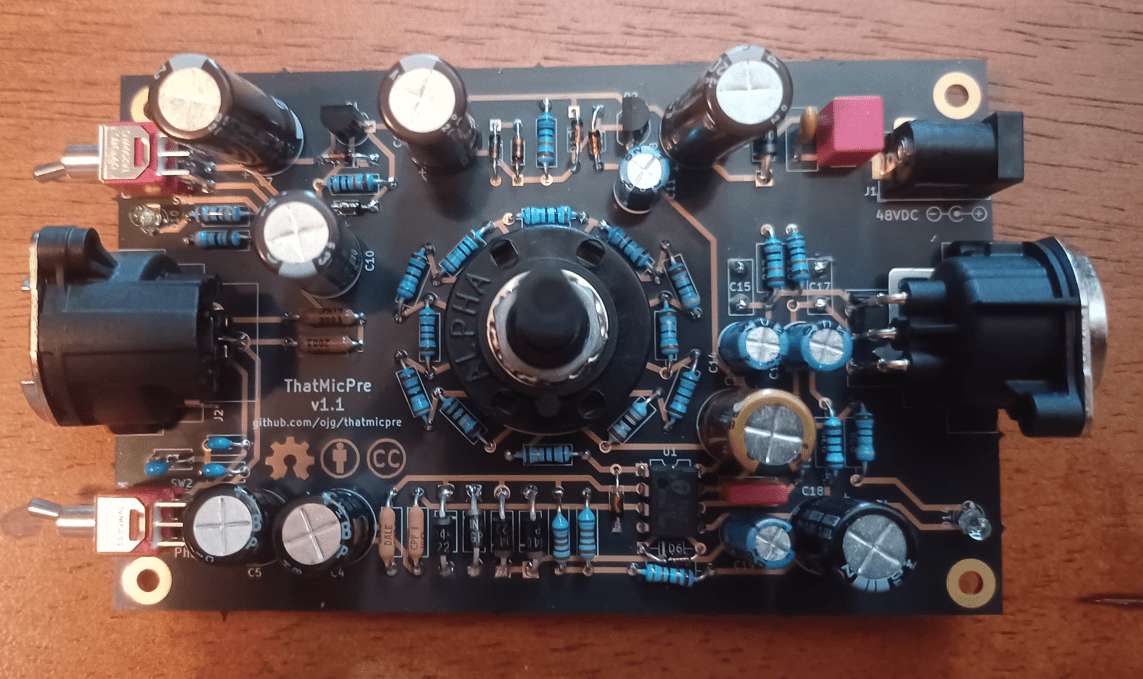

Wow! That is excellent work! The craftsmanship with the heat shrink wrapped connectors, the bracket for the DC plug, not to mention the faceplate! Really nice looking! I also like that you used what you already had, it is in keeping with the spirit of the project, to use as many common parts as possible that people probably already have in their drawer.
Thank you so much for sharing the result, it encourages me to do more open source hardware projects in the future to see what people make of it. Thank you!

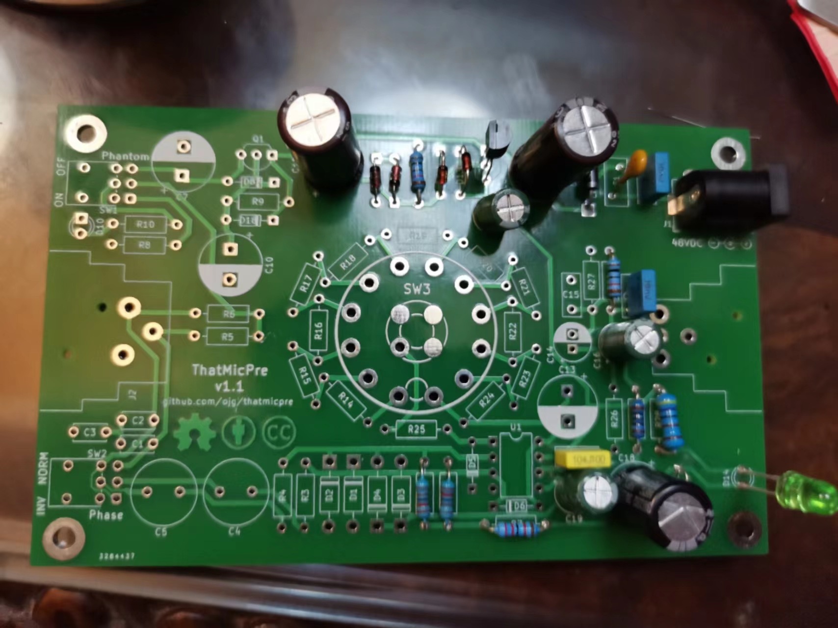

My PCBs arrived last night and I couldn't resist diving right in. A picture of my populated board is below (I had some larger footprint .01 film caps that I used, too fat to fit at C15/C17, so they're installed on the underside).
Unfortunately...I'm not getting any signal out of it.
Do you have a recommended power supply? I'm using a Mean Well 48v .84A switching PSU (part# GSM40A48-P1J) which I already had -- should that power supply be compatible?
My D14 LED does not light up (it flashes briefly when I switch on phantom, but then immediately fades out again). The D10 LED does light up when phantom is on. There is a blip in the signal when you engage phantom, but other than that, I'm not getting any signal.
I've double-checked my resistors and polarized component orientation and everything seems in order. I do have 2 more boards and most of the BOM for a couple more builds, so I can go for a second and cross my fingers, but any thoughts about my PSU or D14 behavior or other ideas would be appreciated.
Hi! Your assembly looks fine, I know the feeling when new PCBs arrive
Your power supply is probably fine.
Do you have a multi-meter? Any cheap one will do, just to check the DC voltages on the board.
The information that D14 turns on briefly when you switch phantom on tells me there might be some problem with Q2 and/or the components around it. Could you measure the voltages from collector, base and emitter to ground of Q2? There should be approx 48V on collector, 36V on base and 35V on emitter.

Great, thank you for the quick aid!
I'm testing a steady 47.8v collector, 46.5v base, and 0.5v emitter. So you nailed it.
I was also suspecting Q2 simply because (a detail I left out) the first time I power up the unit I had C11 installed backwards so I thought that could have hurt something in that area and Q2 seemed most likely.
Should I simply swap out Q2? Easy enough. Or what other parts may also have been hurt?

I would first touch up the solder joints on Q2 just to make sure there are no cold solder joints.
Although with 46.5V on the base, it could seem that D15/D16 isn't working right either, (or that D19 is the wrong way around, but from the picture it looks ok). I would remove Q2 and then measure the voltage across D15+D16, it should be 36V then.

I decided to just go for it and give it a try with a fresh Q2 transistor, and presto it's working!
I haven't spent much time with it yet, but sure sounds like some nice clean gain.

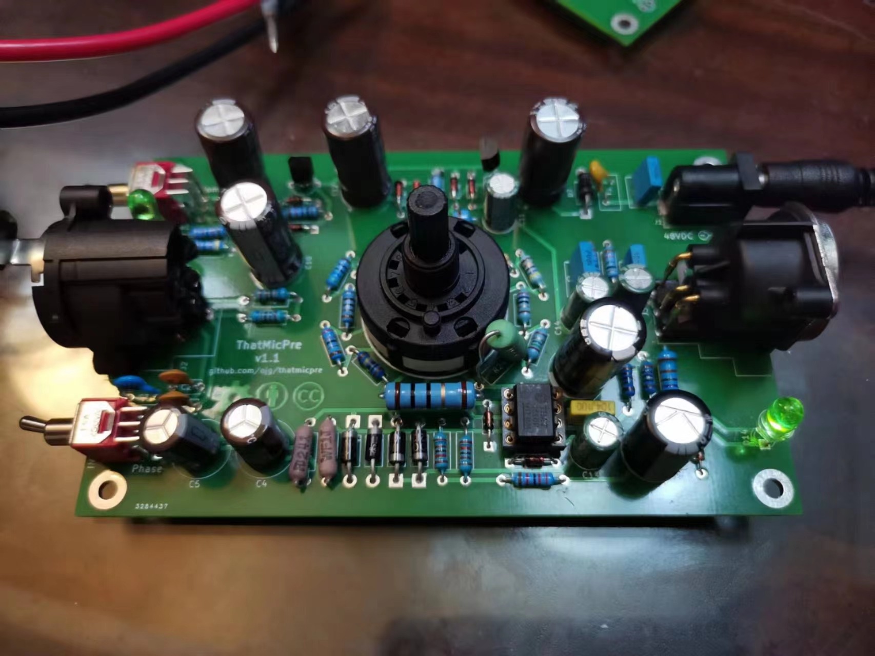

I made a thatmicpre according to your design.
But it doesn't work properly.
I worked on it for a few days and still haven't solved it.
To make matters worse, when I was measuring the voltage of the chip just now, I short-circuited the two pins of the chip, the chip was broken, and the circuit was also short-circuited.
So I decided to build a new one, and start with the power supply part.
I have done the part of power supplying for chip.
After plugging in, the 7th-pin position of the chip has a voltage about 35 volts, and the led light was on.
There's nothing wrong with that part, right?
According to my broken one, after the phantom switch is turned on, pins 2nd and 3th of J2 have around 48 volts.
And the phantom power LED lighted up.
This was also correct, right?
Then I don't know what is wrong.
I suspect there is something wrong with my chips.
Can you tell me what are the voltages of the 8 pins at the chip location when the that1510 is not mounted?
I want to make sure that my board provides the correct working environment for the chip.
Thank you!

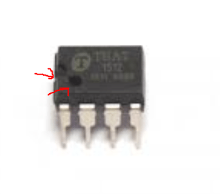

Hey I can't help with your voltage questions, but maybe with your THAT1510 concern. When I built my preamps, I tried multiple different preamp chips, including a fake THAT1510 that I ordered from EBay. The THAT1510 from EBay did not work. I suspect you may also have a fake THAT1510 chip because it looks similar to the fake one I have.
You can see in the included image below of a real THAT chip, there is a divot on the left edge, AND a little circle shaped depression on the chip below the "T" logo. Your chip looks like the one I got that did not work. The real THAT chips that I ordered from Mouser were legit and work, but I would avoid getting these on EBay or Alibaba or other independent seller because there are clearly some counterfeit THAT chips out there.
No guarantees this is your issue of course, but seems likely, especially if you didn't get the chip from an official THAT retailer.
thank you!Hey I can't help with your voltage questions, but maybe with your THAT1510 concern. When I built my preamps, I tried multiple different preamp chips, including a fake THAT1510 that I ordered from EBay. The THAT1510 from EBay did not work. I suspect you may also have a fake THAT1510 chip because it looks similar to the fake one I have.
Without the THAT1510 mounted, there should be 35V on pin 7 and 18V on pins 2, 3 and 5. The rest should measure 0V.

I built my second thatmicpre today without sw3 (sw_rotary12), and measured the voltages of each pins without that1510.
When phantom power is on, the voltages are as follows.
2nd pin - 18V
3th pin - 18V
5th pin - 18V
6th pin - 0V
7th pin - 35.6V
But when phantom power is on, the voltages of 2nd and 3th pin are about 14 to 16V.
I think it shouldn't be a problem, right?
Then I'll just wait for the new chips to arrive. It will take about two weeks to get them.
