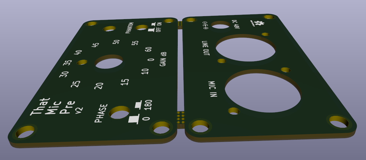

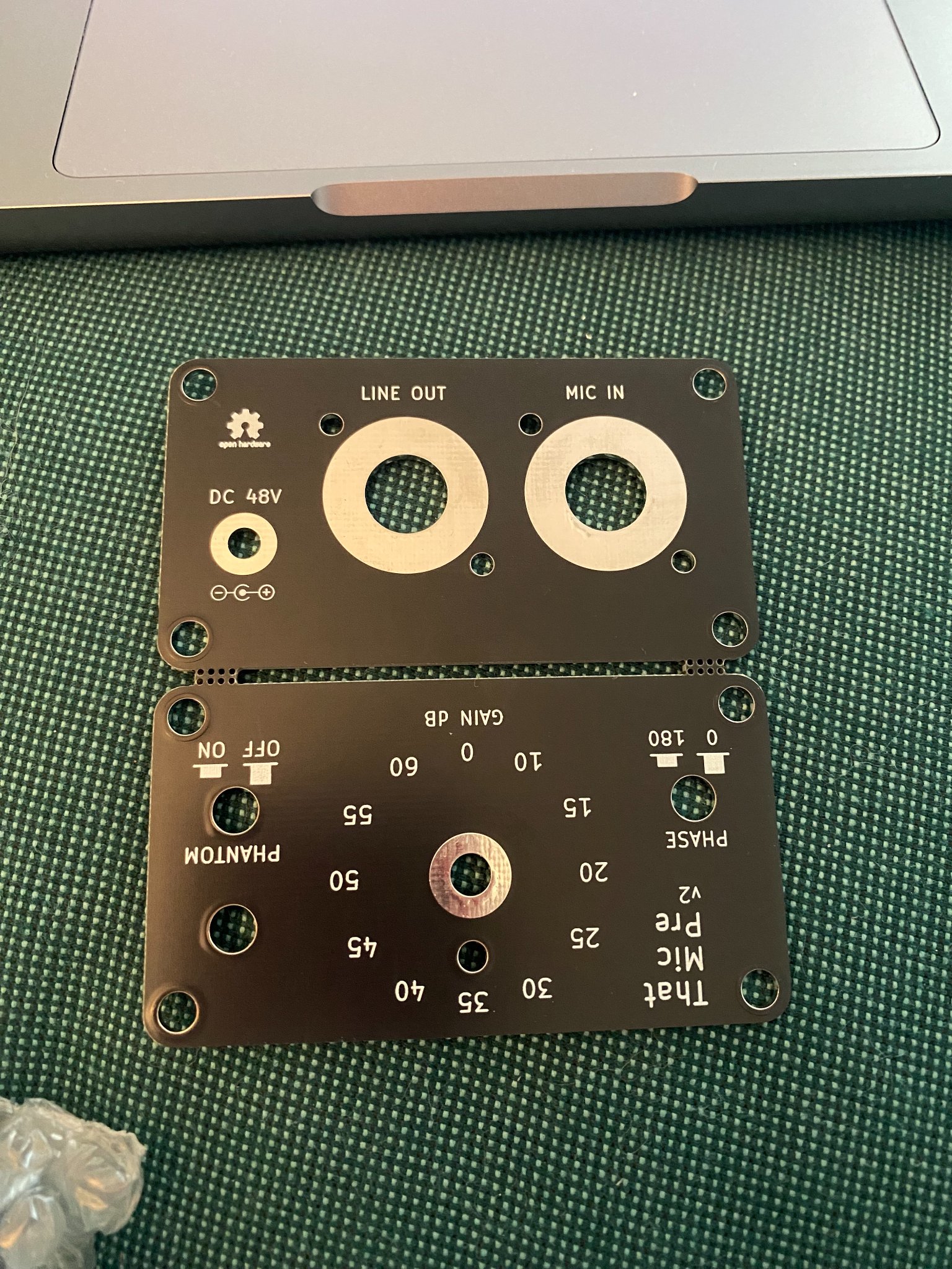

Has anyone used JLCPCB to produce the PCB panels for the rack version ?
I just did and here's what they sent me... They say there's no mistake, as the "holes" for Mic In/Line Out/DC In/Gain are not "holes" in the layout, they're part of the board outline and come as "solid" circles instead of "holes". Therefore, they cut in the middle of the outline, meaning here that the hole is half the good size.
Anyone had the same issue ? Should the Gerber be updated with holes instead of outlines ?

That is interesting to say the least. I used JLCPCB for both my frontpanel orders and it came back just like it should.
So they cut a hole in the middle of the outline, but where did they get the size of the hole from? Did they just make up something?

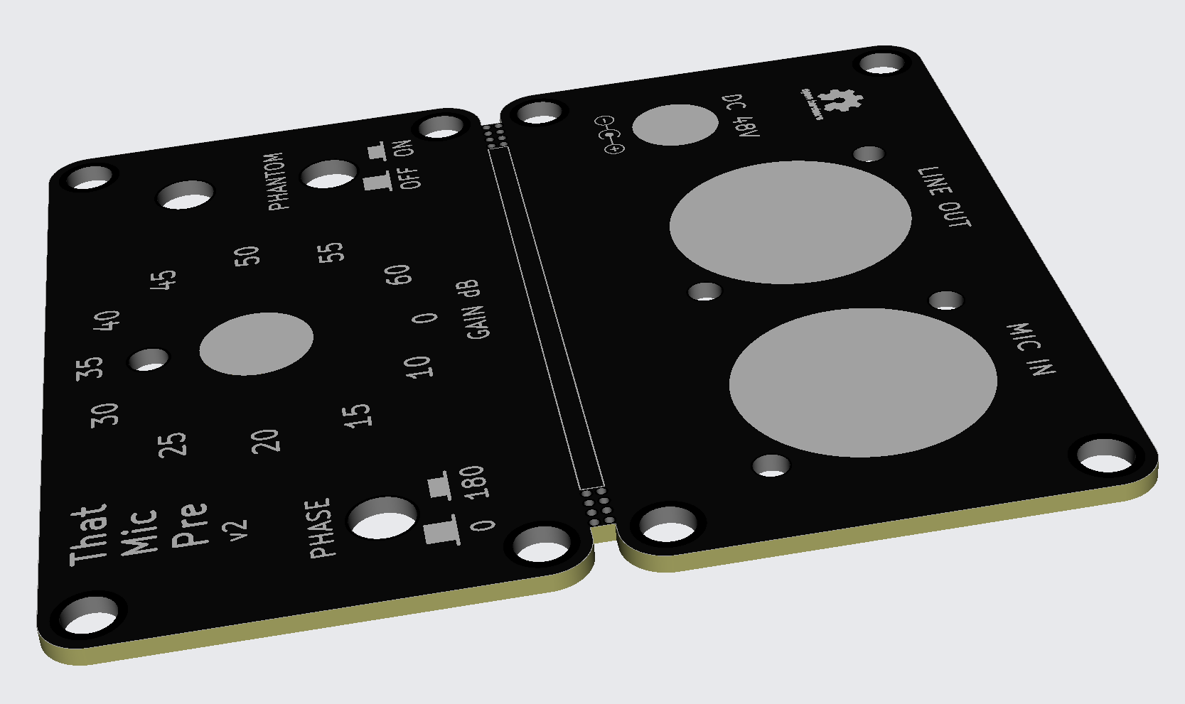

So what does the PCB look like in the preview on your JLCPCB order site?
If I look up my old order it now shows like this, so that's not right. Perhaps JLCPCB have changed their Gerber interpreter script or something.
When I view it in KiCad 3D it still looks good.
So yes, perhaps the solid circles need to change to just circles with outlines on the edge-cut layer. I will give it a try.
I still think JLCPCB delivered you something other than what their preview shows though.

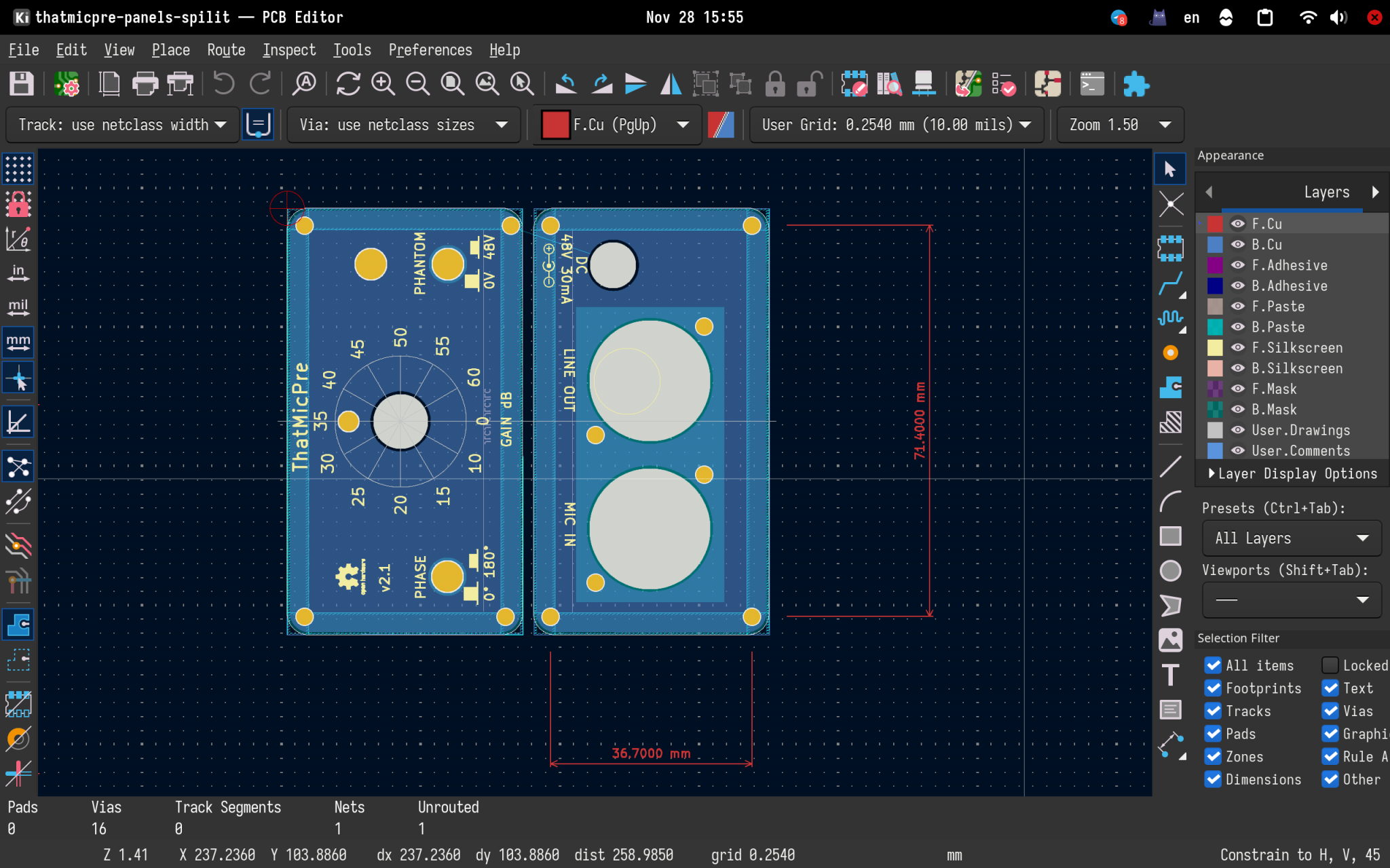

Thank you for sharing! I successfully replicated your ThatMicPre project and made a few minor modifications:

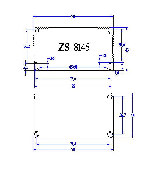

1. Slightly reduced the width of the mainboard to fit aluminum cases available on China's Taobao.
2. Adjusted the panel layout height and the positions and sizes of the mounting holes to match the aluminum cases on Taobao.
For those interested, you can check out my fork.

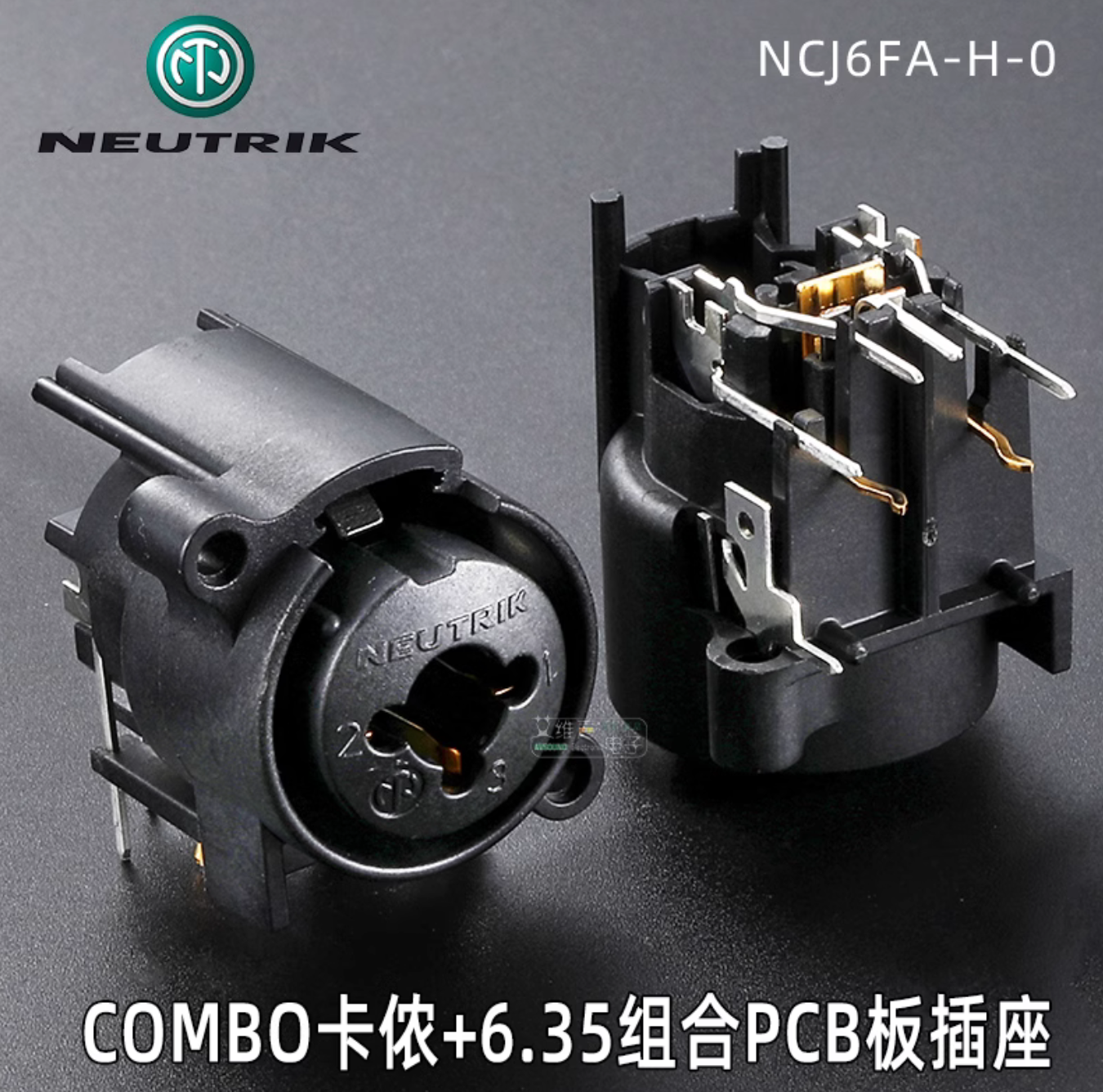

I also replaced the NC3MBH1 with the NCJ6FA-H, which is compatible with both 6.35mm TRS and XLR connectors. However, I haven’t fabricated or tested the new mainboard. Anyone interested can fabricate it directly; I believe the design should work without issues.

I recently purchased boards for the rack-mount version from JLCPCB. I downloaded the files before this recent discussion and upload of updated PCB files for the holes on the rack panels. The boards came Monday, and, interestingly, they look correct. I'm excited about this project!
