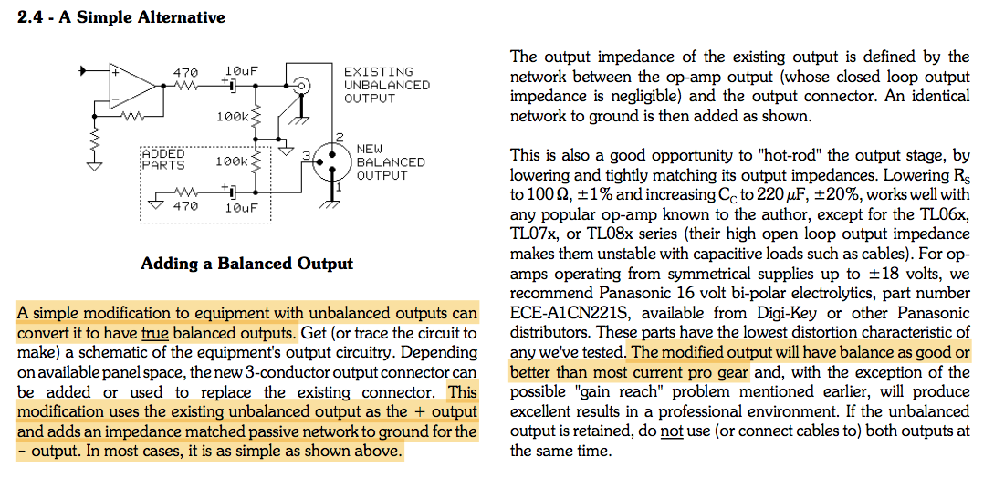

One extra question. Are you aware of the unbalanced to balanced interface proposed at Jensen AN-003 figure 2.4? It uses only a pair of resistors and a cap, no transformers involved.
How do you see that in comparison to the Pseudo-Differential cable?

Interestingly, I was in a similar discussion over on ASR not long ago. Some argue that balanced is not the same as differential. They'd be in Whitlock's camp (Whitlock is the guy who wrote Jensen AN-003). While I do understand where they're coming from, I don't understand their justification for the discussion. Here're my thoughts:
In a single-ended system, the "ground" conductor is part of the signal path, thus, any ground current will introduce an error signal which is added to the desired signal. Using differential signalling prevents this by moving the ground outside the signal path.
A well-designed differential system is fully balanced. Deliberately introducing an imbalance wrecks performance, thus, I find it negligent to do so. That's also why I've been using the terms "differential" and "balanced" interchangeably. Perhaps that's my mistake. 🙂
As shown in Whitlock's app note, it is possible to have a circuit that is balanced but not differential. Whitlock claims that in this configuration, you still get the benefit of the CMRR of the differential input. That's true as long as the input common-mode impedance is high. If the CM input impedance is low, you start having an error current flowing in the (-) signal lead and now you're essentially back to a single-ended system.
One way to get high CM impedance is to use a transformer, which Whitlock shows further down in the app note. Another way is to bootstrap the input common-mode voltage as Whitlock does in his patent (licensed by THAT Corp for the THAT1200).
How does Fig. 2.4 above compare with a pseudo-differential cable? Let Rs (470 Ω) go to zero and Cc (100 uF) go to infinity and you have a pseudo-differential cable connection. Or perhaps, I should call it a pseudo-balanced cable connection... 🙂 Now you just wrecked the CM impedance (i.e. drove it to 0 Ω by having Rs go to 0 Ω), thus, if you have any imbalance in the impedances of the signal pair (which you do as one is grounded and the other driven by an opamp), you won't get any CMRR.
The balanced output shown in Fig. 2.4 will work well as long as the impedances are actually balanced. This means the performance of the circuit will depend on the matching between the two (Rs+Cc)s. If you choose ±1 % tolerance resistors and ±5 % (or ±1 %) tolerance caps, you can probably make it work reasonably well. I bet a well-designed differential driver will still work better.
So: THAT Driver differential output > Balanced output > pseudo-differential cable
That's my analysis. I'm looking forward to the discussion.

The circuit shown is common. It's often used in condenser microphones with solid-state circuitry and no output transformer. As far as I know, the claim to fame is that it makes possible CMR at the preamp for any signal (almost always common-mode) picked up by a long microphone cable. It's not the best way of doing things, but better than not doing it.
I like that summary.
